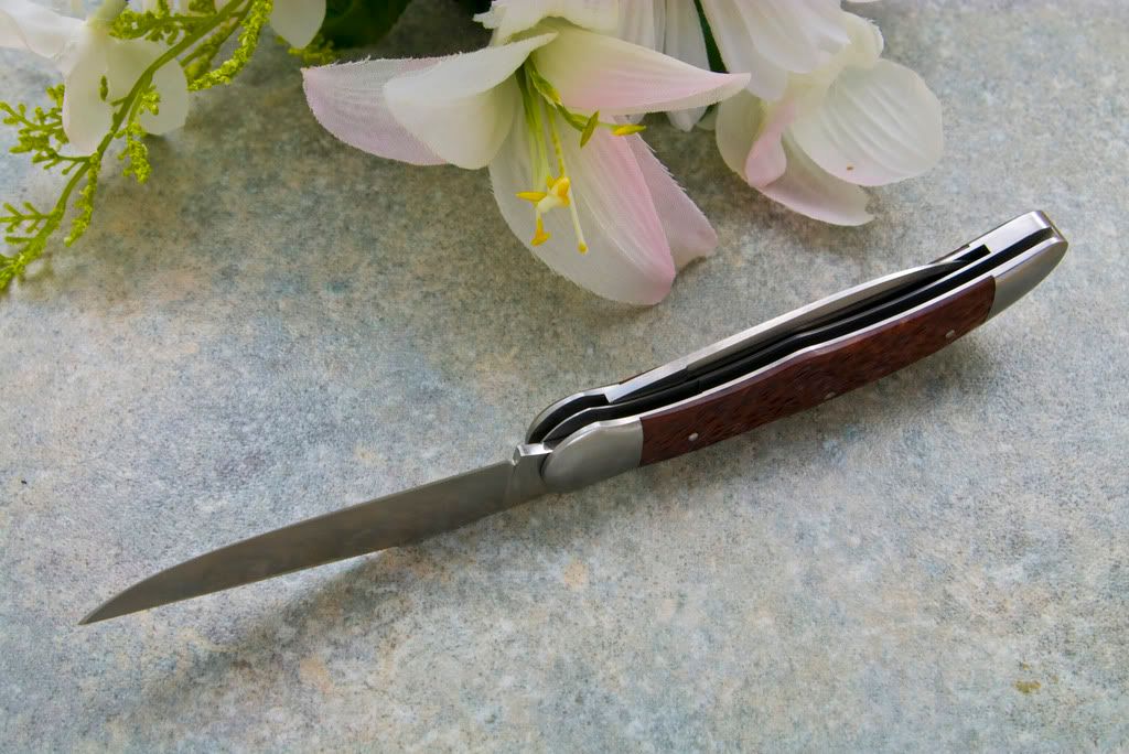

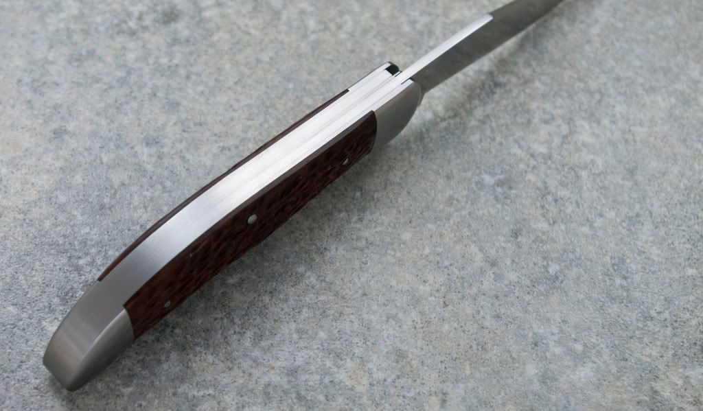

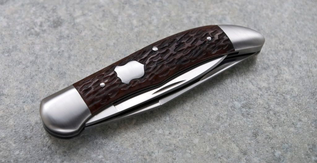

Here is one finished up thats going to a forum member. Thought I would post some pictures as its a pattern that is new to me in a two blade version. Some of you may remember the father of this one in a single blade shadow pattern.
Here are the spec's.
4 1/8 closed
D2 blades and springs
flat ground clip blade and flat ground modified Wharnie.
half stops
extension spring for secondary blade
relieved liners 416
milled frames and bolsters 410
Scales are some of my dyed and jigged bone. A dark to medium brown with a hint of caramel.
brushed satin finish on bolsters
as ground finish on blades
cut swedges.
pinned federal shield
Thanks for looking and comments good or bad, as always, welcome!
Ken

I don't want to hijack but what is an extension spring?
Look at the slot where the shorter secondary blade sits. Do you see how the spring is "extended" to fill part of the slot that would otherwise be a larger open area? This is done to not only give a cleaner, more finished look to a knife, but it also helps keep lint/debris from the well or trough of the knife.

Very nice finish on that knife. If I may ask..what grit do you take the bolsters and, in general, exterior of knife? When jigging your bone(shees!) you must shape the bone to the curvature of the bolsters and then do your jigging and dying? If not...how? Thanks very much.
What a Beauty, Ken! Thanks for posting & the look-see!
Congrats, Elliott. NICE ONE!!!!
Thanks for all the kind comments on this one!
John,
For most of my knives I use a satin finish on the bolsters. I use a fine Scotch brite belt or take the bolsters to a hand 400 to 600 grit finish. Normally I take the back etc to a worn 400 grit.
I shape the bone before I jig and dye. From past experience I know about how much radius I need to be able to keep as much of the jigging as possible. I like to have as much jigging front to back as possible left after the scales are on and shaped. I think nothing looks worse than to end up with about 10 to 20 percent jigging and 90 to 80 percent smooth bone.
