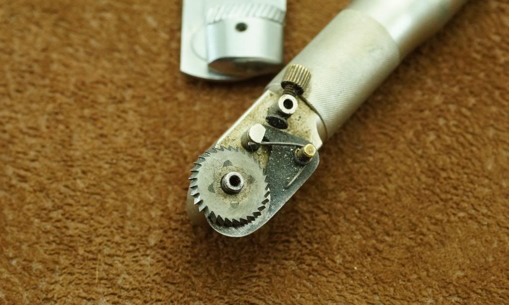

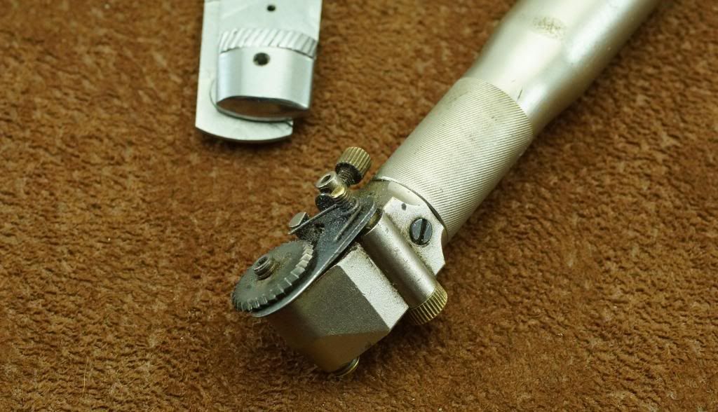

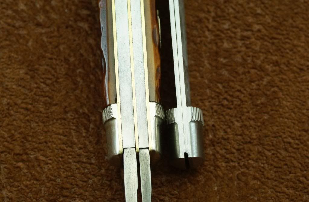

The example I have has a raised portion for the angled grooves.
Here is a set of pictures that should illustrate pretty well. After grinding the radius's I clean things up with 220 grit. I cut the first groove in with a tri-cornered needle file. I then use my MMC checkering head that is powered by a Foredom motor and flex shaft. The MMC checkering head is a wonderful tool designed for checkering wood gunstocks. I had it left over from my gunsmithing days and have found it to be a great tool for "threading" bolsters. The MMC has an adjustable guide that sets the spacing and follows the preceding cut. The carbide cutter has shown no signs of wear cutting 410 or 416 ss.
After I cut the grooves with the MMC I clean up with needle files and sandpaper.

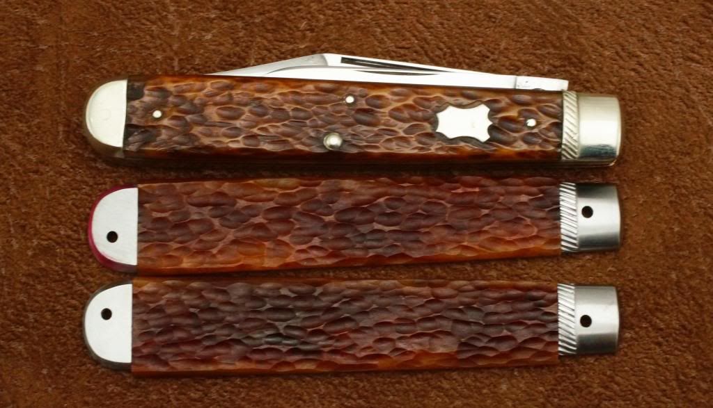

Thanks for the questions and comments guys! I did have a chance to mill the bolsters/frames and happy to report that the overall thickness is within .005 of the Remington! .005 undersize no less :). I still have much finish work yet on the bolsters to refine the file work etc, but happy with the results. The bone is in the vacuum jar, swedges are roughed in, all in all it is starting to resemble a knife.
Uh oh!!!
I am really happy with the covers! This is as close as I am able to achieve with my skill set to replicate the bone that is on the Remington.
What do you guys think about the shield? Go with this one, or use something different?
The bone looks fantastic, Ken.

Not to nitpick the choices of whomever designed the Remington(!), but for me that particular shield-- which I like, in isolation-- fights the other lines of the knife to some degree instead of complementing them. To my eyes, it doesn't 'flow' with the other elements, including the bolster detail, and its points aren't echoed anywhere else on the knife.

The color of that bone is as close to perfect as I'll ever see with these eyes. Warm and inviting with red, orange and sienna highlights. Superb!

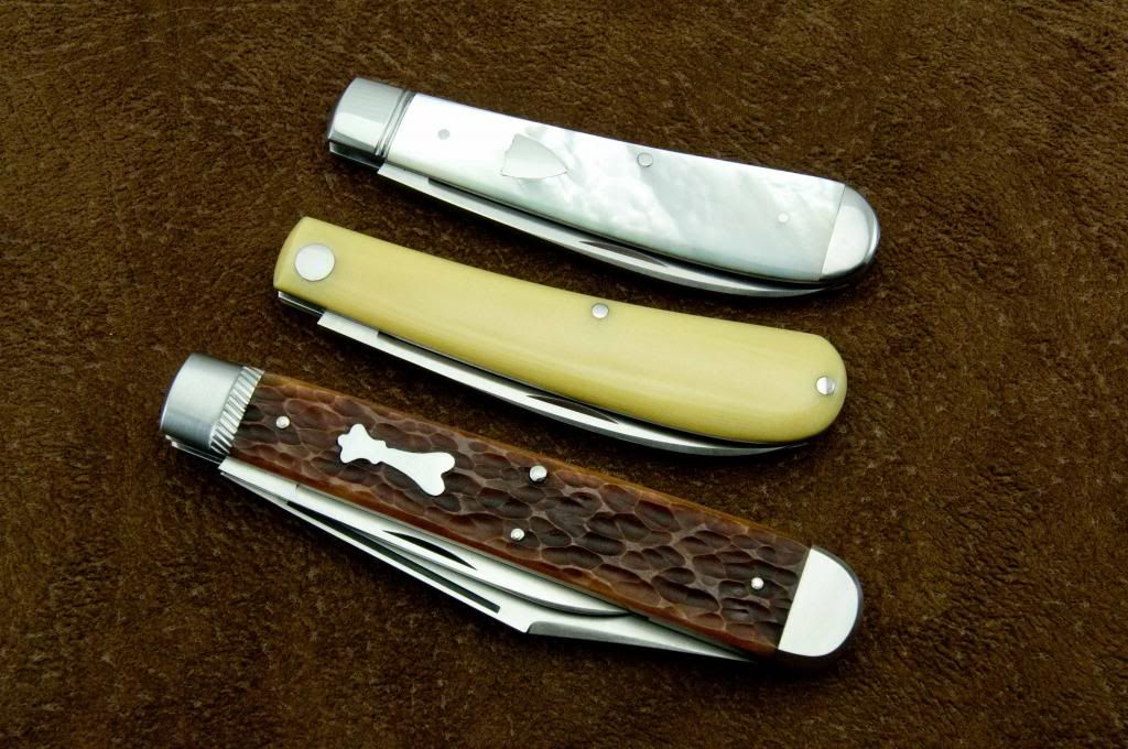

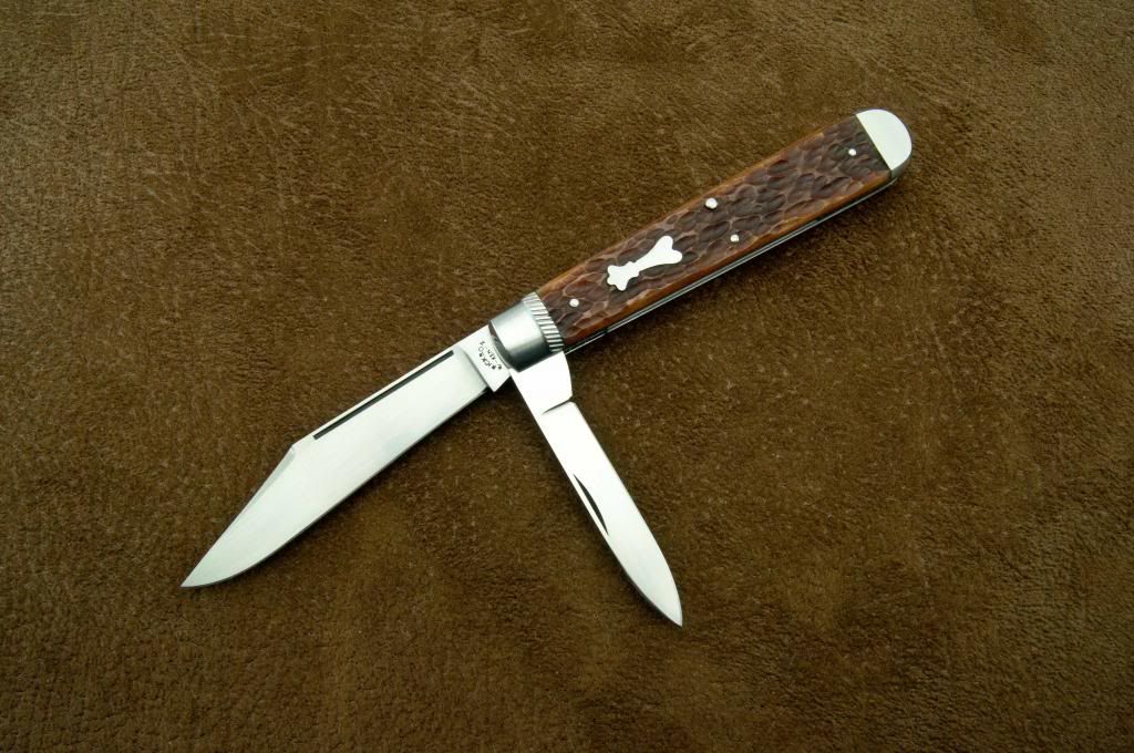

I decided , after making up a few different shields to go with the bullocks shield.
These are the three knives headed to the Northern Lakes Knife Co. show in Janesville Wi next weekend.
