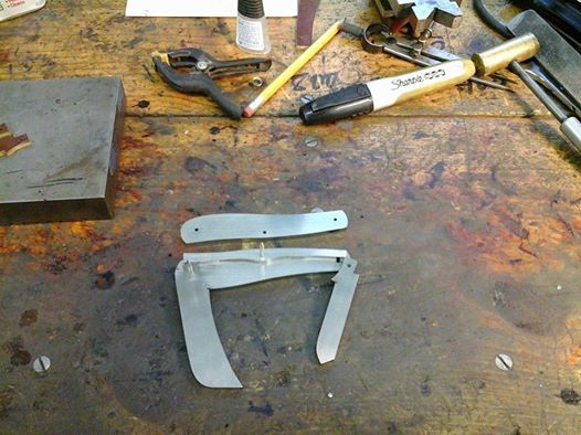

Quite a while ago I was asked to make a few examples of a Farmers Jack. I was very happy to take on the project as I find this pattern very unique, and seldom seen in the handmade arena. This project will interesting as both frames will be the same, but with differences in the blade profiles. These differences will represent examples of vintage knives. This first knife will be based pretty close to a Diamond Edge example, with the next knife sporting a "rooster comb" budding/grafting blade and fuller pruning blade.
I will be posting a few progress pictures as I go.

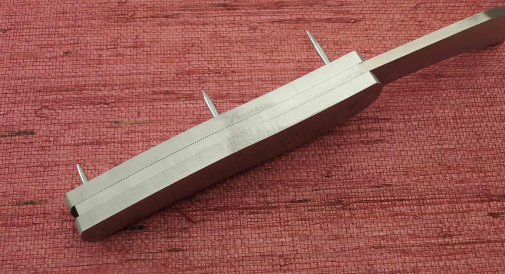

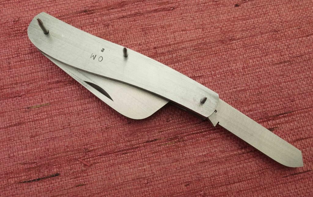

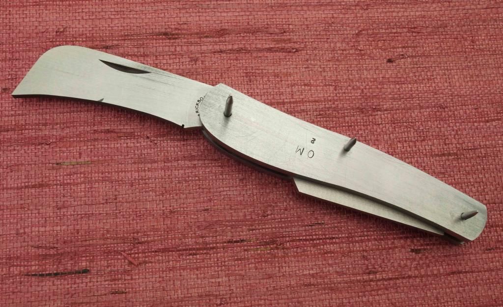

Thanks for the comments guys. John, actually both, this one will be without catch-bit, the second knife will have one. I start with .140 or so, and after surface grinding it will be close to 1/8" The second version with catch-bit will use the same thickness for the pruning and spring, with the budding/grafting blade running around .070 or so.
Made some progress on the first of two Farmer's Jack. Heat treated, parts re-surface ground and the initial fit-up. Some fine tuning , then on to offset blade grinds.
