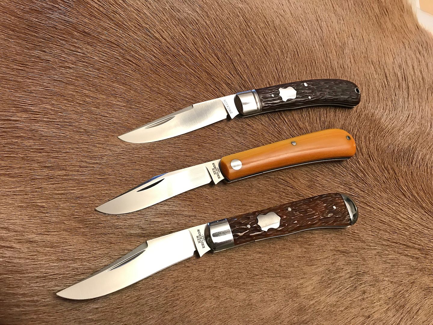

Please do not judge too harshly! LOL I had to start somewhere.
I think this knife was about number 4 or 5 for me. My journey building slip joints started when I won a Ebay auction for a really nice used 6 x 12 hand operated surface grinder for $560. Wow, I struggled thru the first dozen knives or so before things started to "click".
This knife is one of only a handful that feature German nickel liners and soldered bolsters. Crazy looking slanted plunge line, not sure what you would call the frame pattern and blade shape! The nail nick was done post heat treat using a shaped grinding wheel on the surface grinder and then plunge grinding. While functional, the nail nick is not as sharp and defined as when using a shaped fly cutter pre heat treat, which is the method I eventually went to. Nail nicks IMHO are super important that they are done correct on handmade slip joints.
This is one of those rare knives that feature a flush back spring in only one of the three positions! LOL. At least it does have half stops. Notice the back spring in the picture with the blade at half top position. Yikes!
I had thrown this knife in a box of rejects on my work bench and one day my father was visiting and noticed it setting in the box, he liked the very green jigged bone, and I gifted it to him. He was either being really kind or did think it was the bee's knees as he kept it on his desk up at his cabin till the day he passed.
