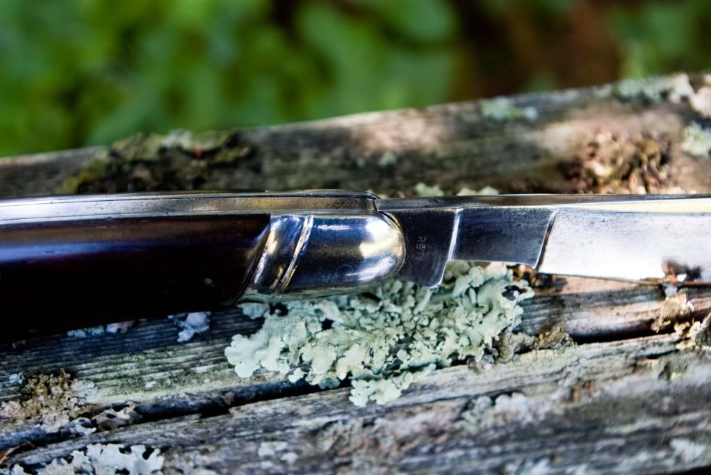

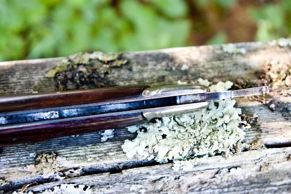

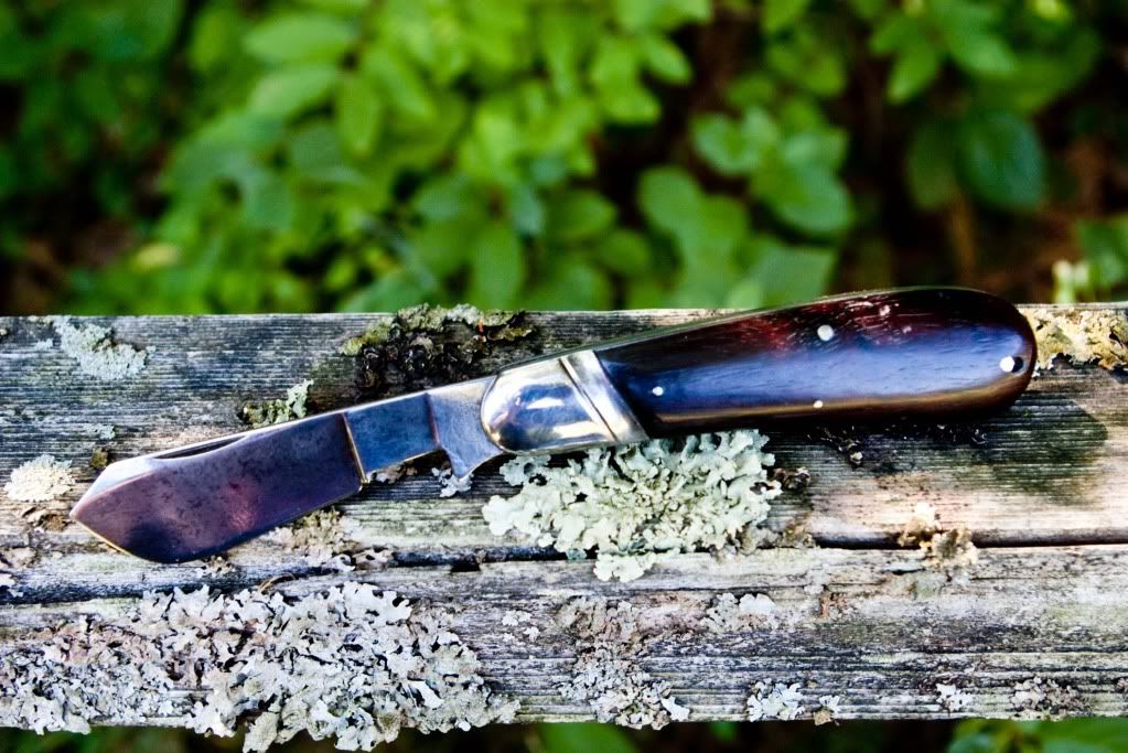

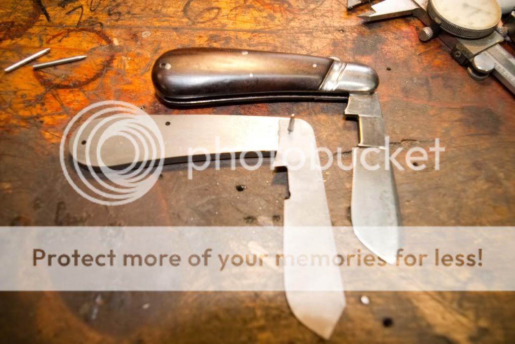

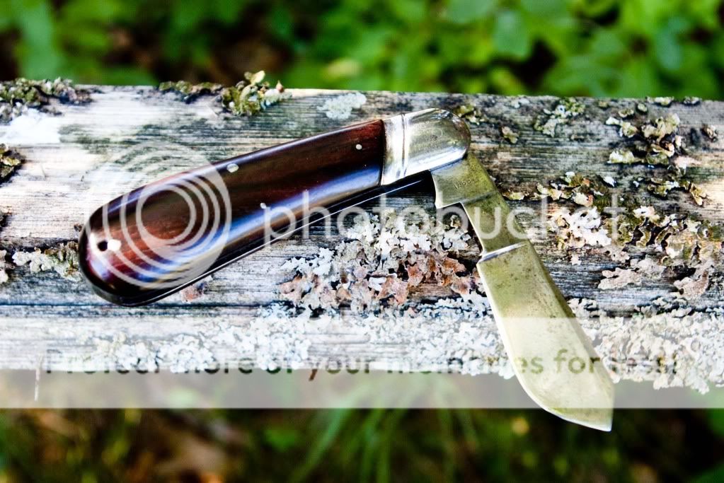

Here are a few pictures of the Remington cotton sampler that Campbell sent me. This particular cotton sampler has some pretty interesting features that Campbell wanted me to carry over into my rendition. The slanted heavily fluted bolsters are noteworthy as are the swelled scales. By this I mean that they do not sit flush with the bolsters. The scales sit proud of the bolsters giving a more substantial less flat feeling in the hand. While this knife is under-bladed slightly I will be building this one with a smooth transition from spine to blade. I also think this knife is pretty cool in the fact it has steel or iron liners versus brass or NS.
I will be doing a wip on this knife starting in the next few days. Thanks in advance for following along!

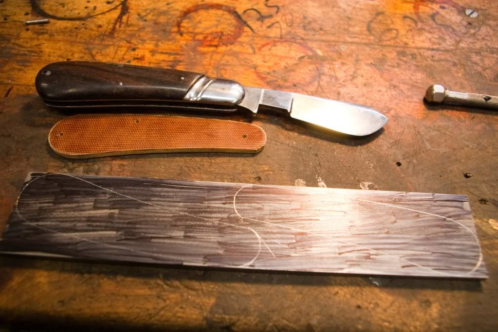

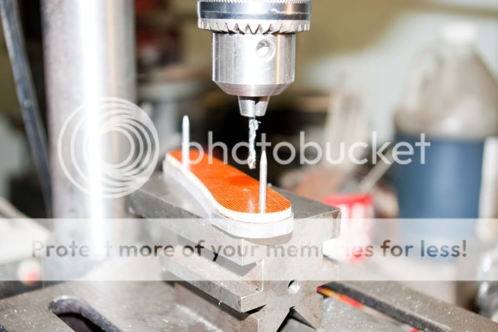

The first step for me when I make a new pattern is make the frame pattern. In this case I used Micarta but at times I use brass or whatever I have laying around.
The important thing when making a pattern for the frame is to get it as close to size as possible. I use calipers to check key points compared to the Remington. I then drill the three holes for the blade pivot and backspring.

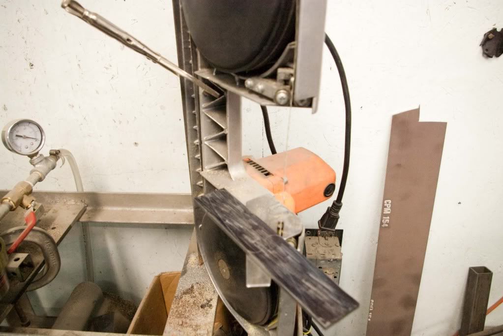

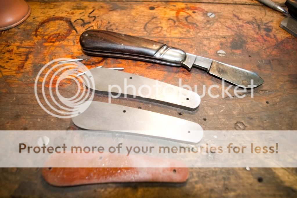

When I am happy with my pattern I then transfer it to my 416 bar stock, scribe a line and cut out on my portable bandsaw.

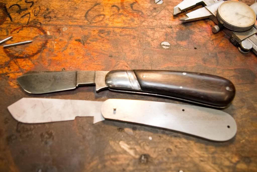

After cutting out the two frame pieces, rough profiling them, I drill the three holes.
I now have two matching frame sides, with holes drilled.

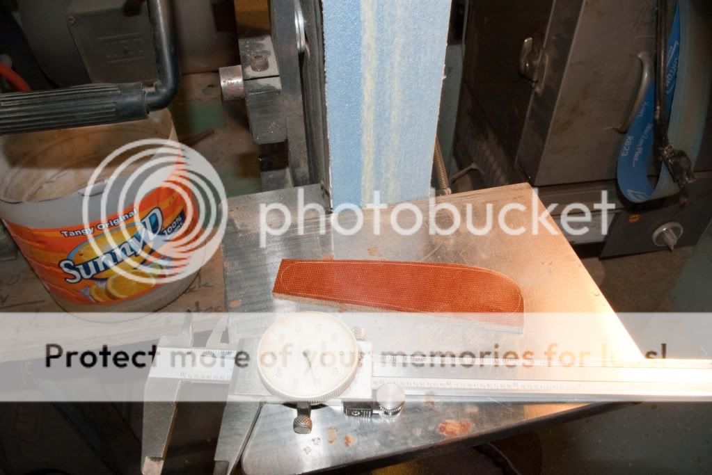

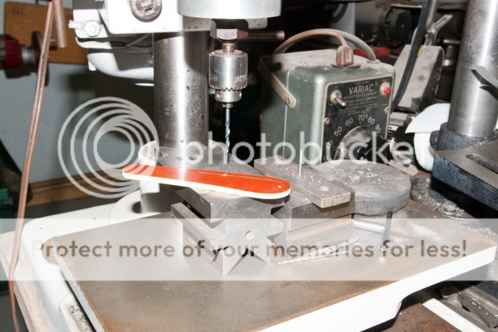

Next step for me is make a rough pattern of the blade using vulcanized spacer material. I use this as its handy, I can drill and grind it to profile and it is easy to work.
I will fine tune my blade pattern before laying out and cutting out of my blade stock. Blade stock on this knife is .130
