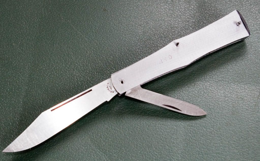

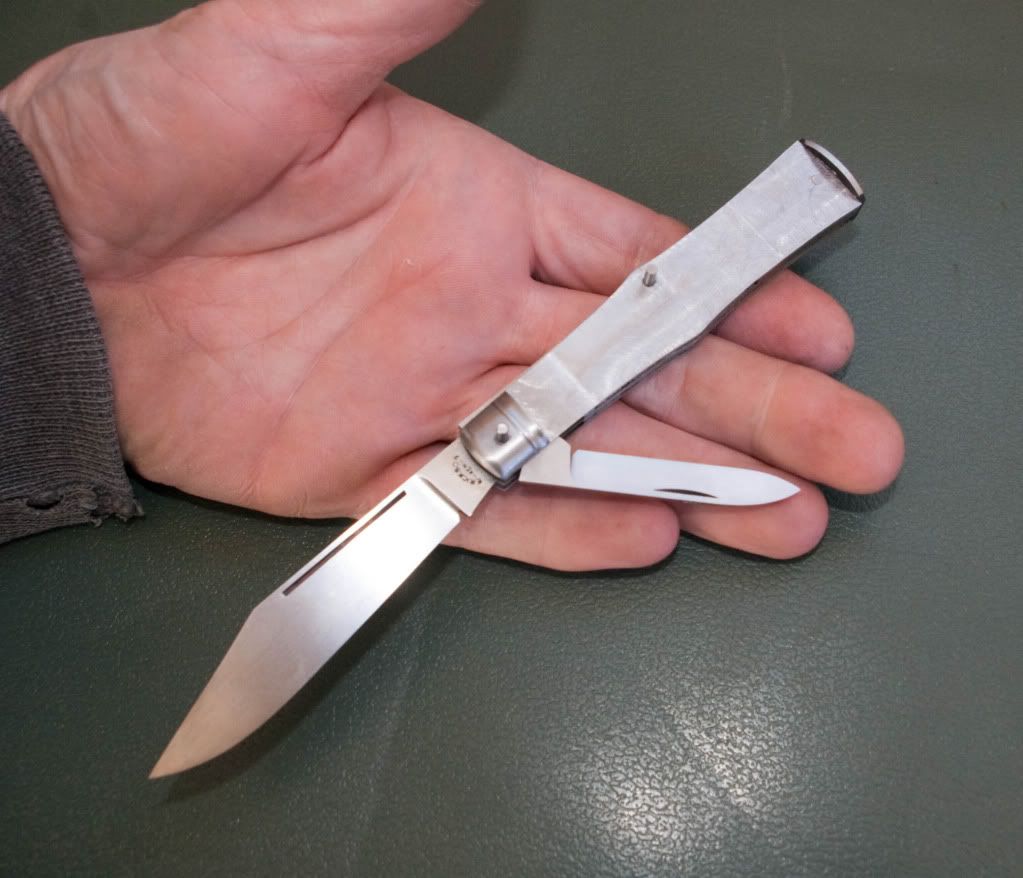

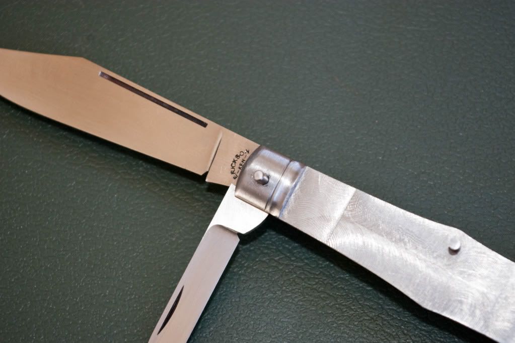

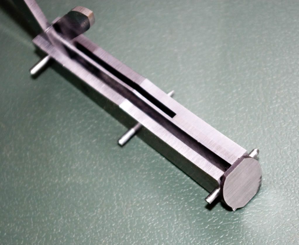

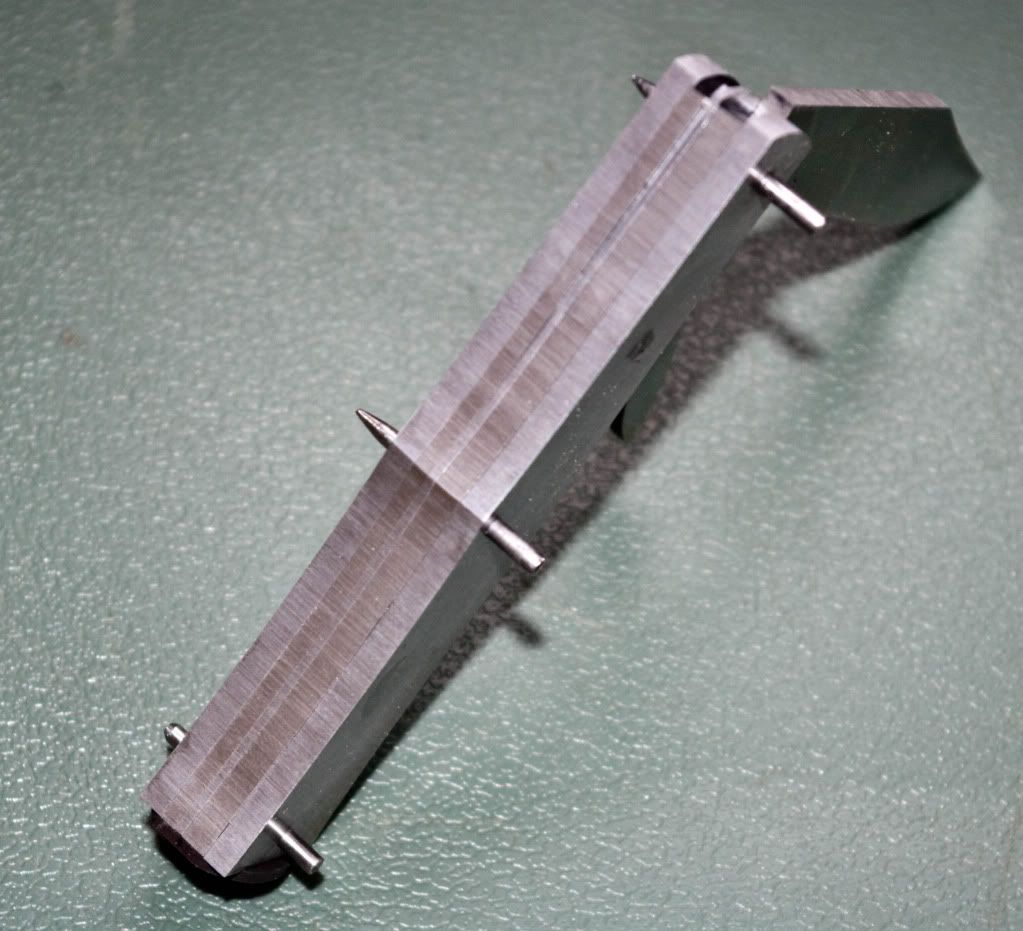

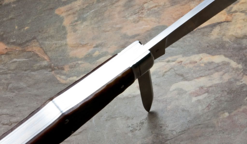

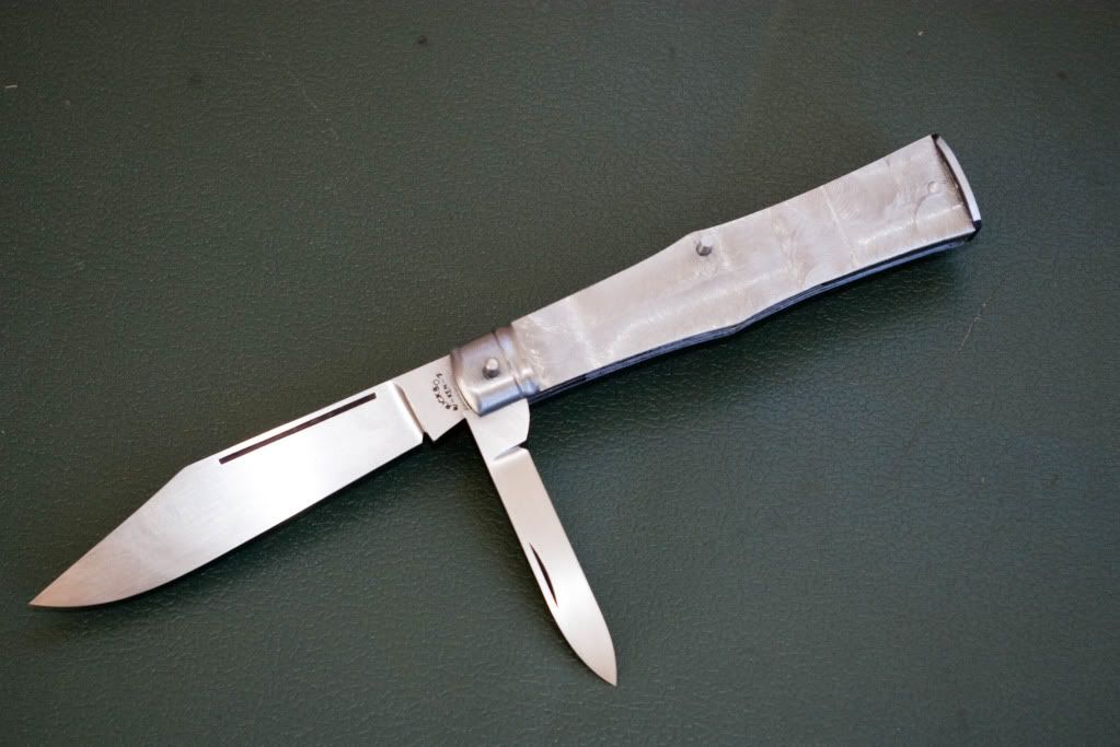

I promised to post some wip pictures and so far am really happy with this knife. I choose this knife for several reasons. A pattern I have not built before, along with a challenge I have not met before. This knife is a two blade jack with "sealed cap". While I have recently built a pruner with a sealed cap, this one is different in that there are two back springs.
I machined the cap out of a solid piece of bar stock(CPM154cm) and heat treated. No soldering of separate ears for the cross pin.
Here is one big improvement over the original knife IMHO. I made an extension spring for the pen blade, also out of a single piece. No separate filler piece. If anyone has a picture of a vintage two blade jack, with sealed cap AND extension spring I would love to see it, either here or via email.
Thanks to everyone that offered up suggestions in my thread, especially Eric for following up with pictures and dimensions of his knife. (this knife not available)

Jake makes a good point. Ken, if all you have is measurements taken from an intact knife, how do you figure out tang geometry and whatever else is needed to get a precise fit with perfect action ? Trial & error: make a few rough blades and see what changes are needed to achieve perfect results ? or ??.

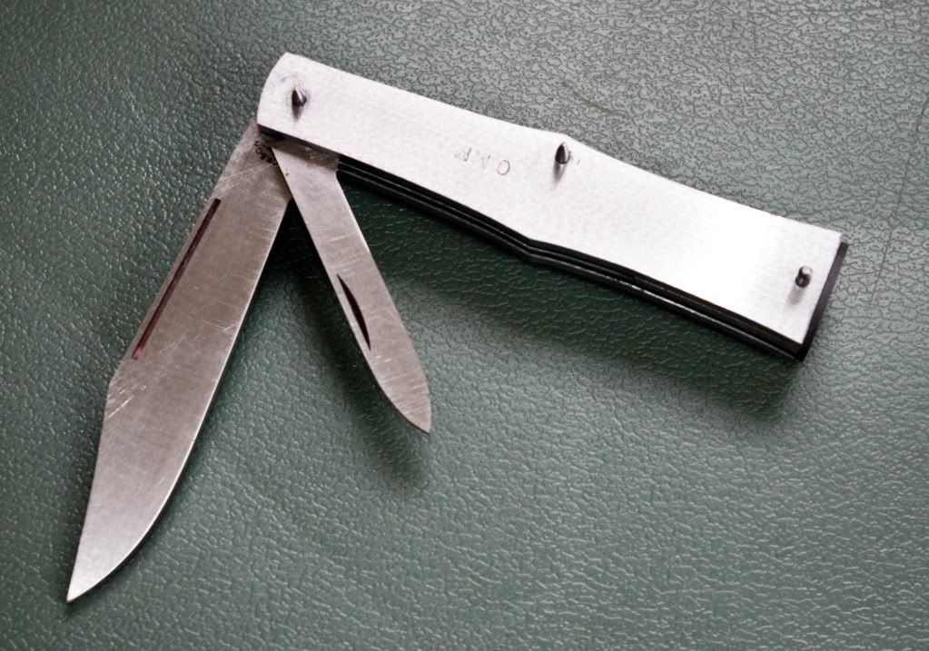

Roland,
Good question and one a bit hard to answer but I will try. When I take on a new pattern such as this one , I will start by cutting a piece of brass sheet stock and make my frame pattern. Placing the holes for the pivot, and springs come down to knowing the patterns, sizes of knives and types of blades. After refining the frame pattern I then move on to the blade. At times I may have a blade pattern from a previous knife that works. Much like the cutlery companies did. Utilize a blade in as many patterns as possible. Other times I make a new blade pattern up in brass. Brass is a lot cheaper to make mistakes on, compared to blade steel stock. I have no patterns for the springs normally. I think if perhaps someone was to watch me develop a pattern from scratch, they maybe surprised how low-tech my process is. I hope I have been making these difficult to make knives long enough that I am starting to get a feel for how, and what they should look like!

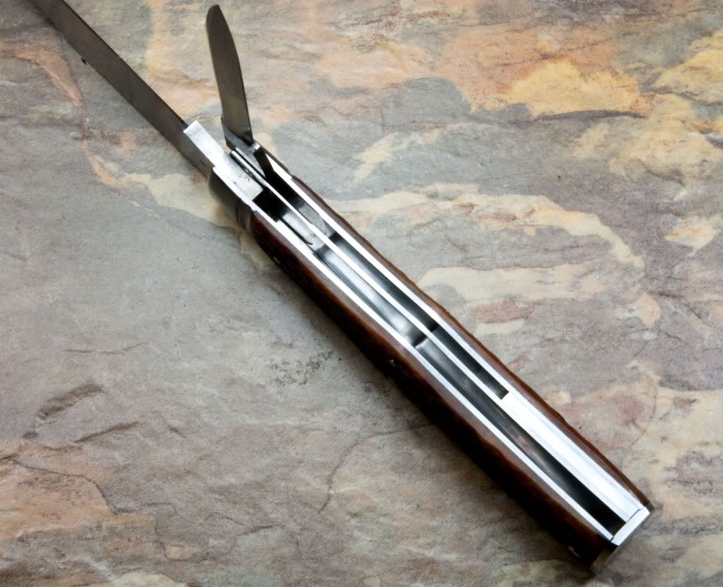

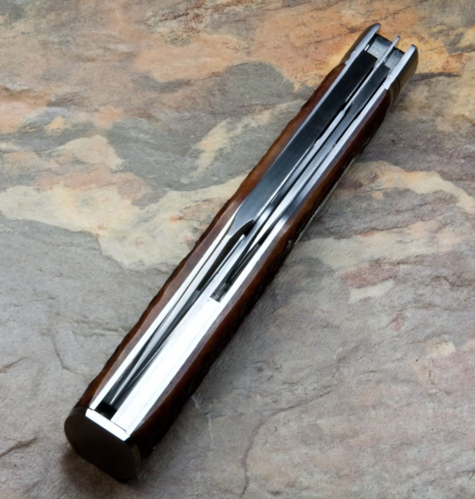

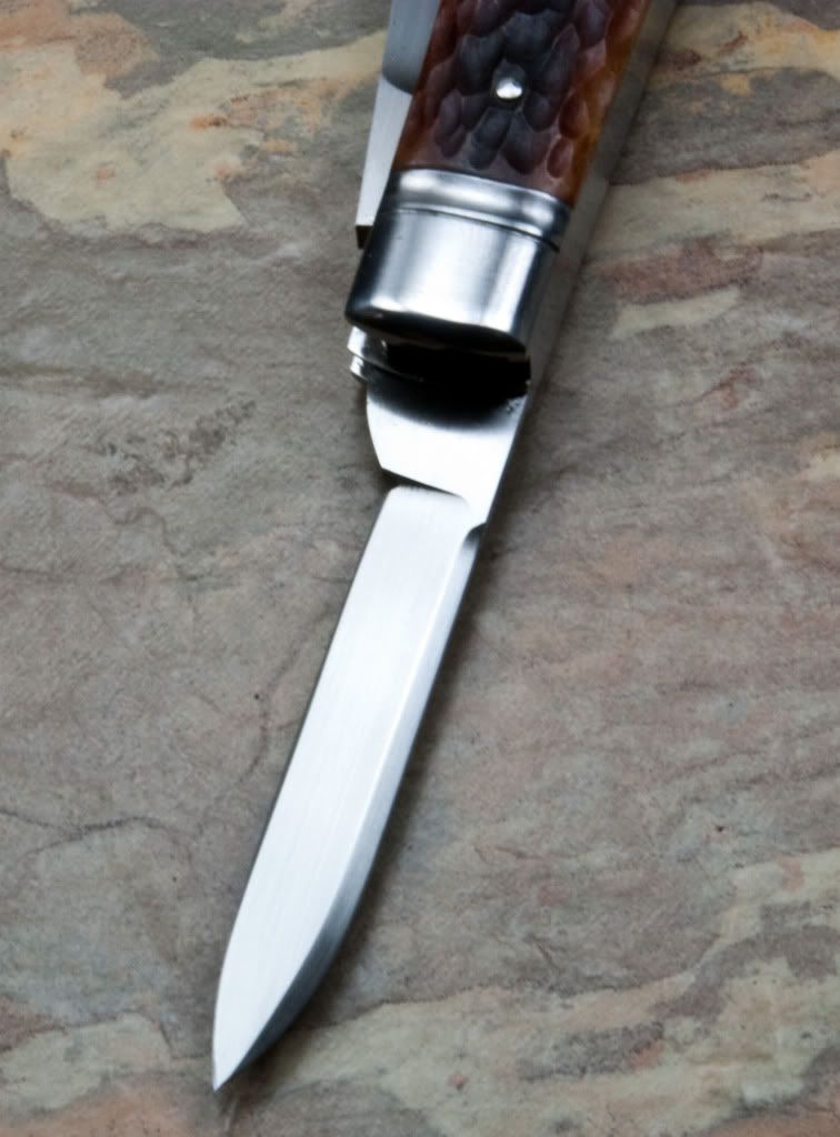

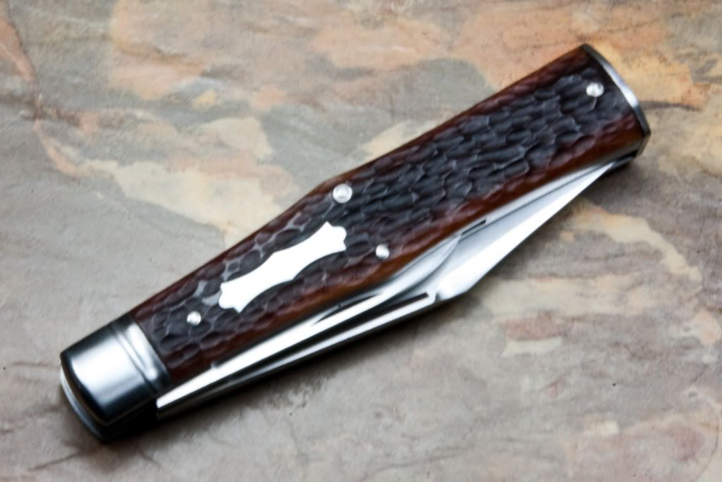

I did get a chance to work on the swell center jack. I have the scales cut, jigged and in the dye now. The grinds are done, with the swedges to follow, along with the bolsters shaped, fluted and threaded. I went with a small flute(rat-tail) and then fine thread. I like this combination. I may coin/mill the center liner but the jury is out on that one yet.
Here are a few pictures, along with a in-hand picture. Not a small knife by any means at 4" and full master.
That's a handsome and muscular looking knife there, Ken. Looks like another winner! :thumbup:
I think that is a good term for this knife Elliott. With the seal cap you end up with a nicely rounded, hand filling cross section. The blade stock on the original Schrade Cut CO. that I patterned off of uses .125 stock for the master. Many knives in this size range use 3/32 or .093 stock. Visually this knife will have lots going for it I think.

That's NICE! Great shape. Blades look
perfect to the pattern and love the extended
back spring. Can't wait to see the rest..

Ken: Another question please. It looks like the end cap is shy of the outside of the outer liners by a bit. How does this work in the finished knife? Do the outer liners grind down or......? Might be an optical illusion also.........

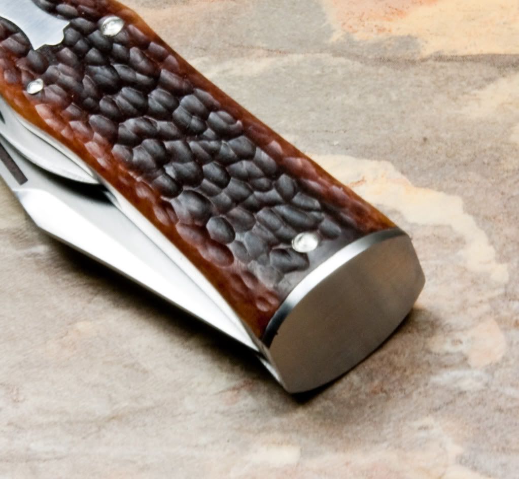

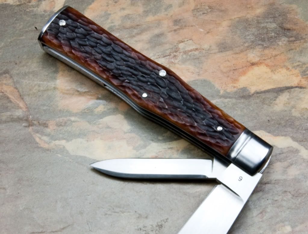

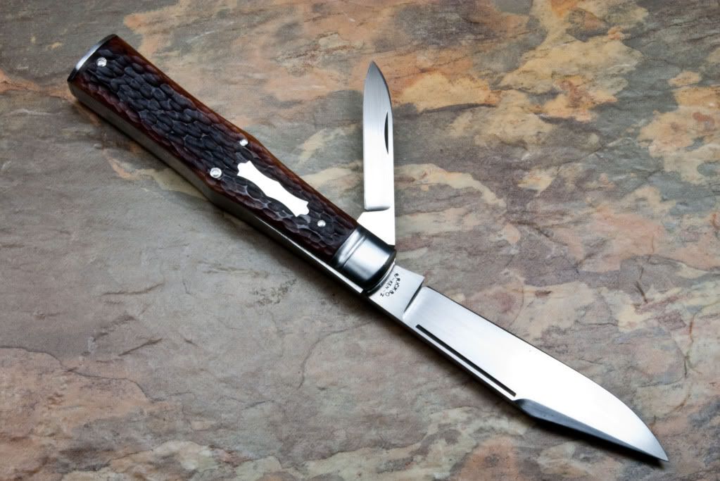

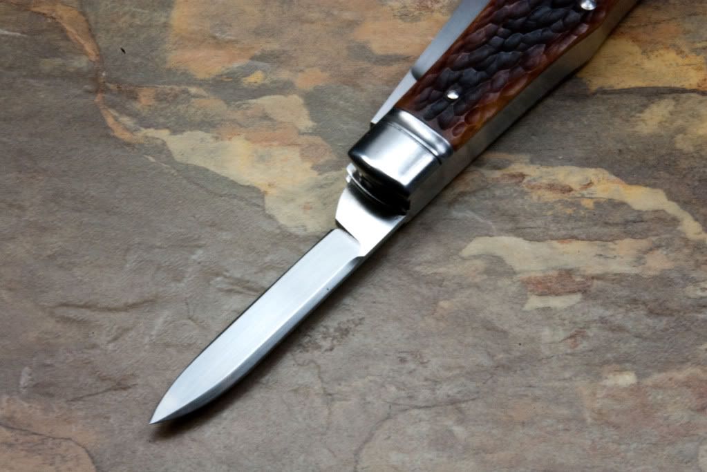

Had a chance to finish up the swell center jack with seal cap. This was a fun exercise for me, and as always I have learned. :D
4 inches closed
CPM154cm
410 integral frame/bolsters, fluted and threaded
CPM154cm seal cap
My dyed and jigged bone scales
410 double pinned shield
Half-stops
Master blade, cut swedge, long pull
Pen blade, cut swedge, standard pull
Extension spring for pen blade
3 5/8 oz.
Boy that looks to be a handful and a half! Very nice! That bone is exceptional. I like the fact that you still kept the extended spring for the pen blade, along with the seal cap.
