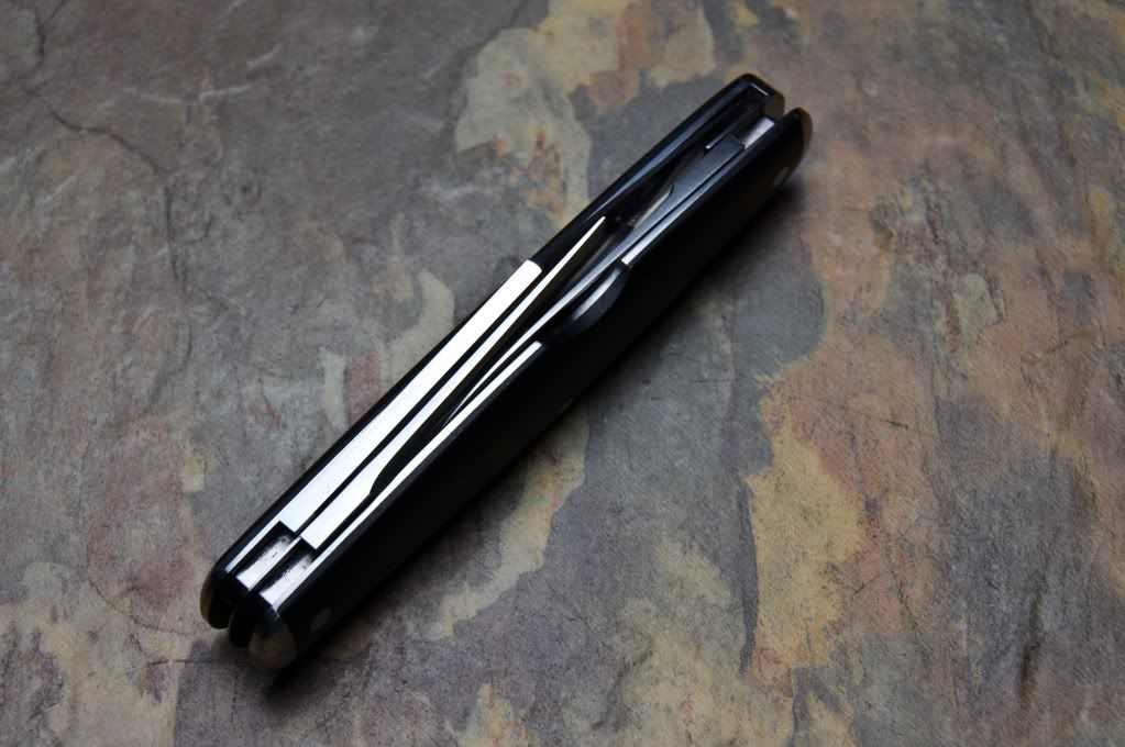

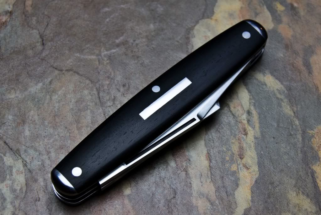

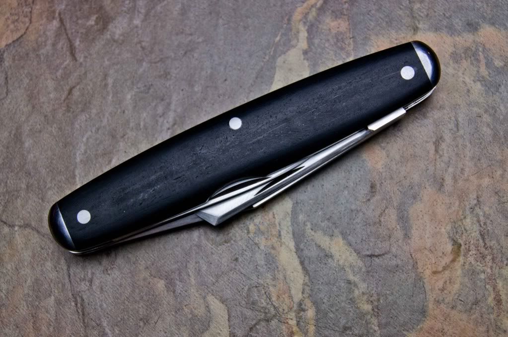

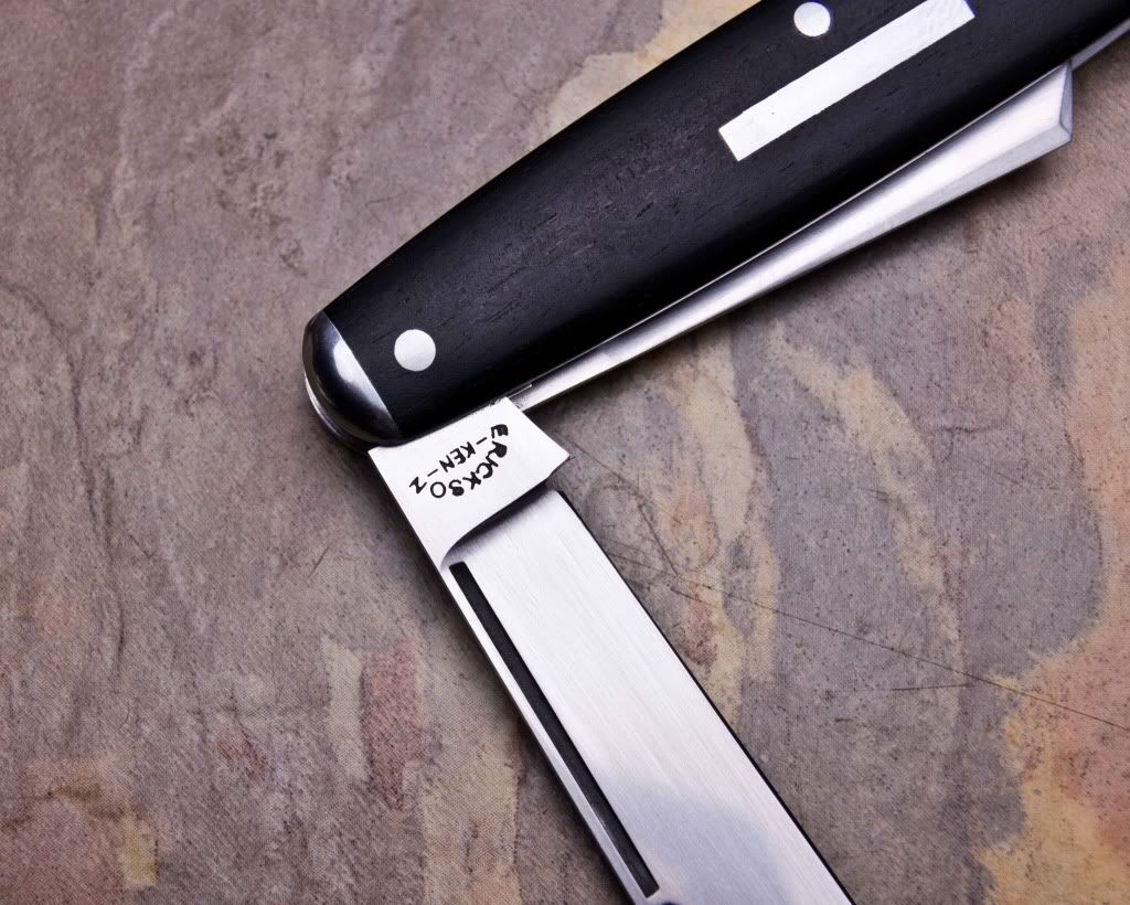

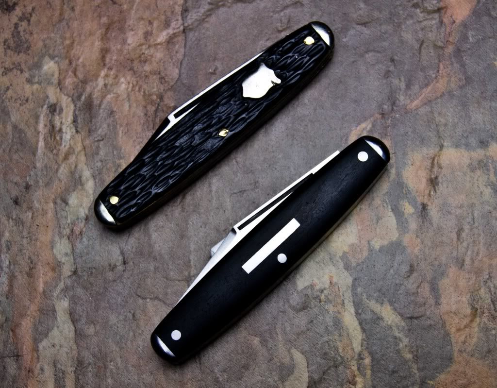

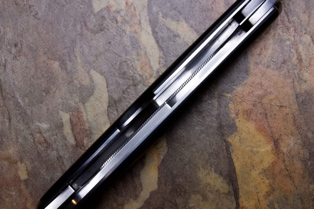

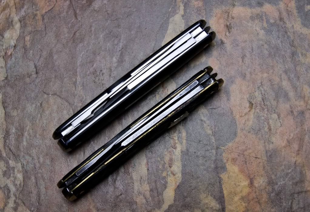

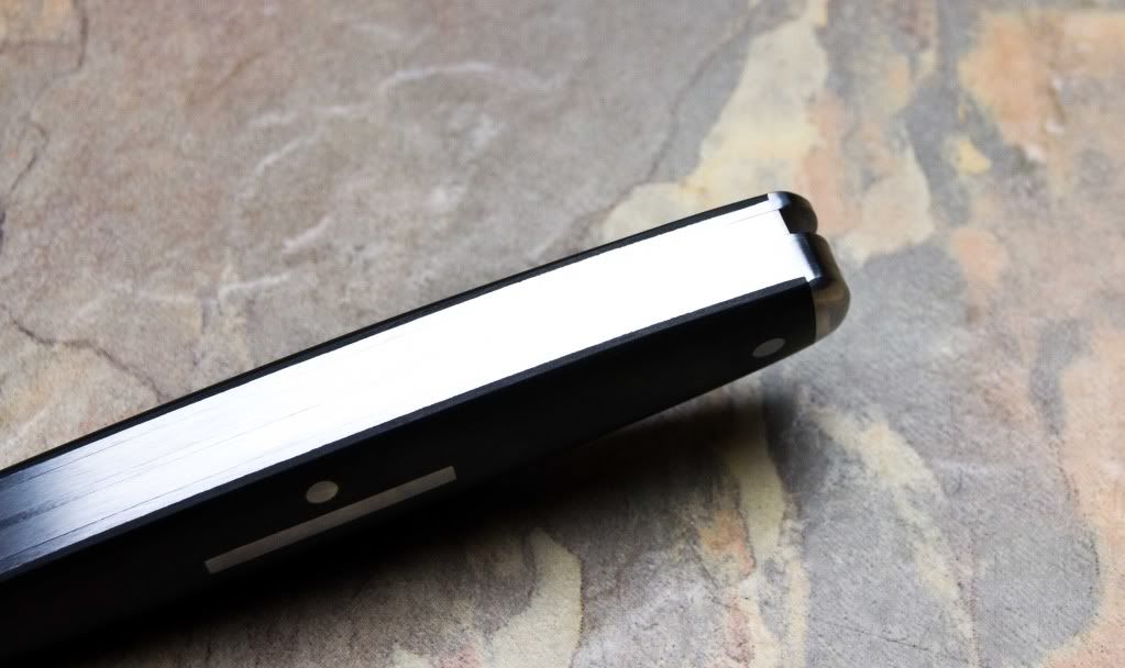

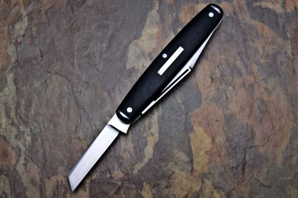

I just finished this one up for a customer who had a sent an intriguing little knife for a pattern. The knife is marked Syracuse Knife Co. I believe that Syracuse was a brand name of Camillus. Anyways, the knife is small at 3 3/8 closed , equal end with a stockman/cattle knife blade configuration.
My customer opted for a slight blade change in that a coping blade replaces the spey blade. I changed the master clip blade to a fuller profile with the clip extending a bit further back alone the spine. This knife also features 440V blade steel(discontinued) and as such does not have a number denoting blade steel. The thin pointed pen blade was also requested as compared to a more rounded traditional shaped pen. I think the changes made were all to the better on this knife. This knife comes in at a whopping 1 3/4 oz!
3 3/8 equal end frame pattern with tip bolsters
Ebony covers
440V blades and springs
Coined inside center liner
Half-stops all blades
800 hand finished
1 3/4 oz.
Ken, that's a fine looking little knife. Being patterned after a Camillus with a "Syracuse Knife Co." mark makes it very interesting to me. Living in Syracuse, NY and all ...
Ken,
Extraordinary job, once again. The blade changes and your execution thereof are stellar, especially in this size pattern (a sweet spot for me). A "lot of knife, small package," indeed!
Your customer has good taste, in proposed alterations and choice of maker.
~ P.
I sure do love those small end cap bolsters.
My wife said the same thing when I showed her the knife today! The tip bolsters add a dimension to the build that I am not used to. These tip bolsters are still integral with the frames. Because of the way that I clamp and mill my frames/bolsters when building this knife I find I have to change up my clamping methods.
This is an interesting pattern. The frame looks like a Senator to me, but the blade choices are more like a Cattle knife. However Cattle knives are stout heavy working knives and i think this one does not have the bulk of a Cattle knife.
I suggest a new name for this pattern: "Missouri Rancher".
roland
Ken that Syracuse rendition is so incredibly styley. A lot going on for less than two ounces!!!
