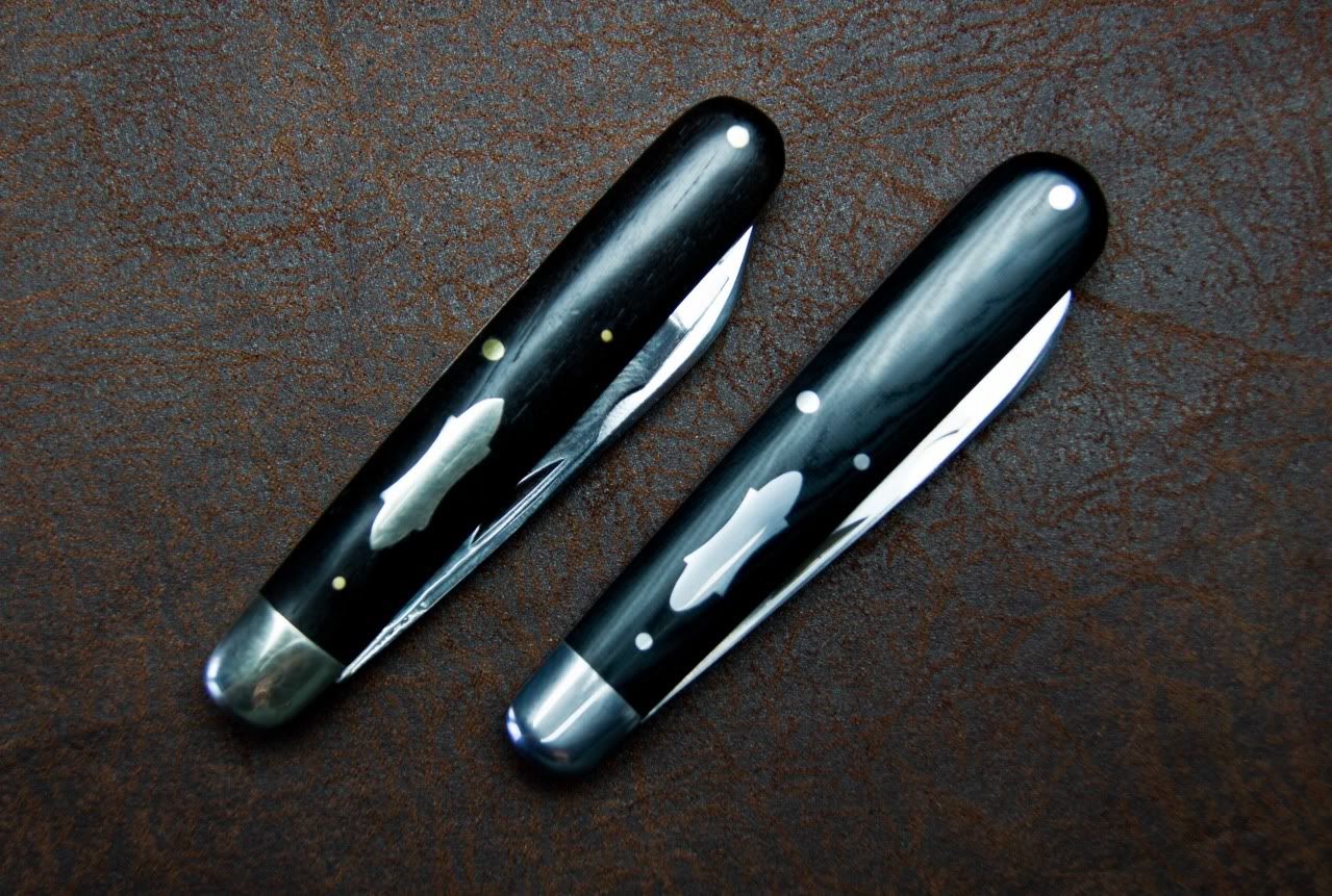

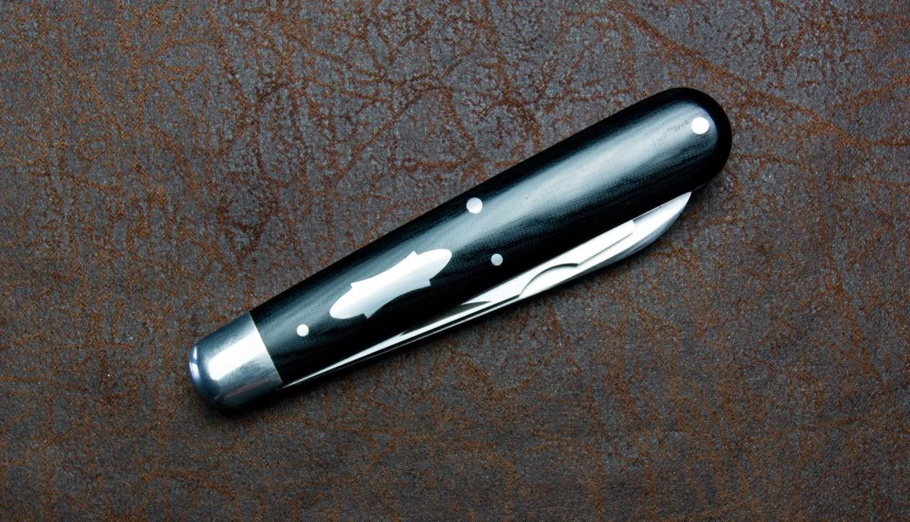

Thanks for the kind comments on the electricians knife guys! This one really kicked my butt:eek: I finished it up and overall pretty happy with the results. There are a few things that I would do a bit different in and when another one gets made. I have a new found respect for this knife, just how hard it was to get all elements working right.

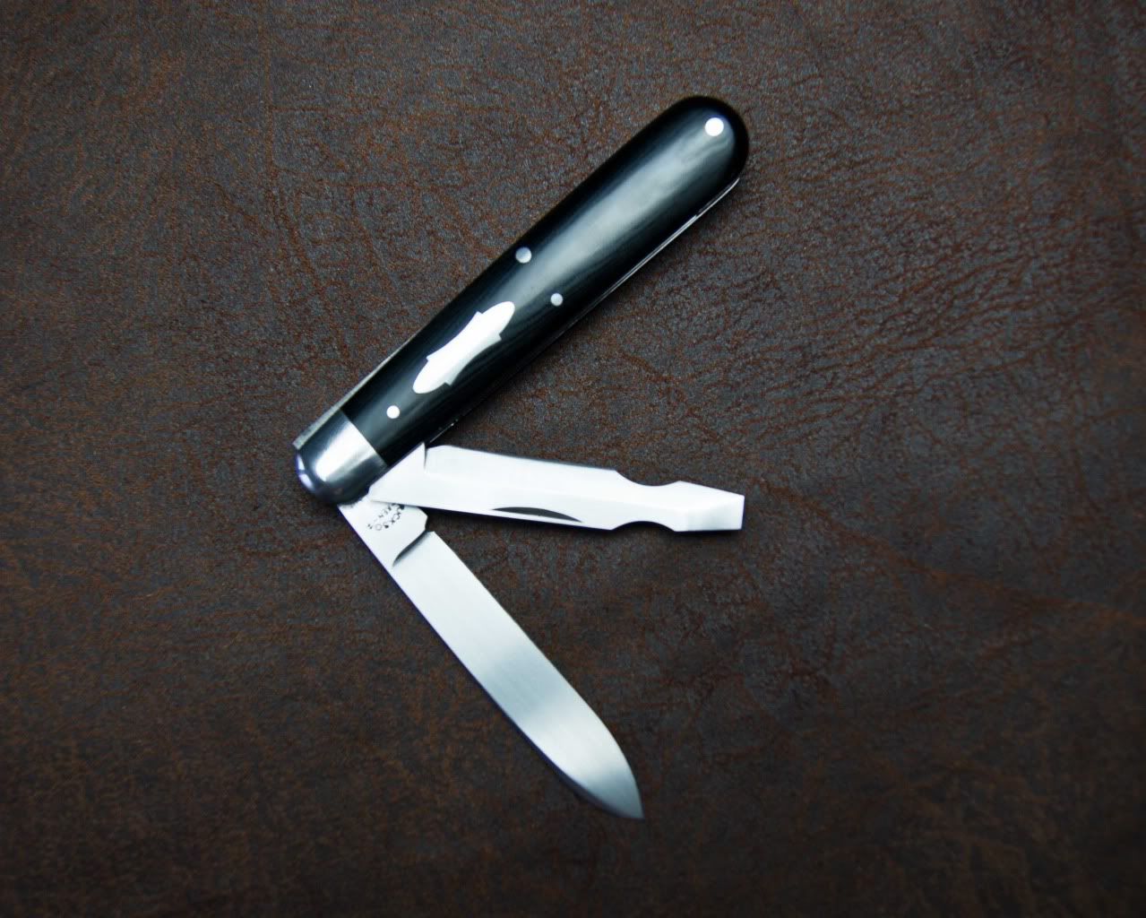

I am having a bad photo day, had a hard time getting decent photos especially of the grinds on the screwdriver blade.

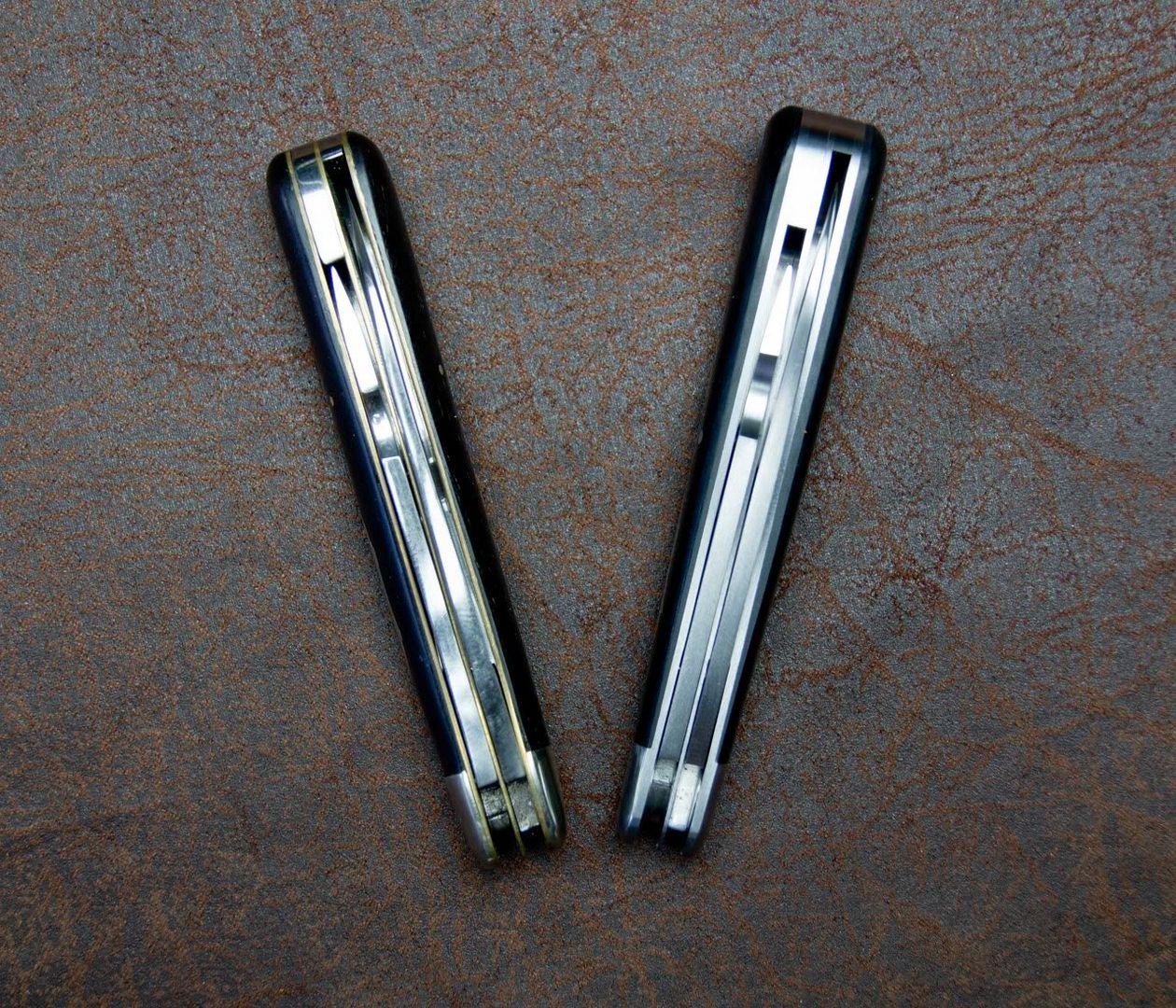

If that was hard for you then I won't even bother trying it. I do have a question for you though because I can't quite tell in the pics. Did you mill relieve the liner nearly the full length of the screw driver?

Good eye on the liner. I mill relieved the liners as normal but then tapered the top 1/3 or so to give some clearance for the screwdriver blade. That is one of the tough aspects of this knife. The screwdriver blade does not taper thinner out from the tang as most blades do. That and the fact that it is basically a saber grind does not leave any room for blade rubs. Of course in the production model, this was not a concern.

I wondered how you were pulling it off. Tapering the screw driver definitely makes more sense visually but can definitely be more difficult to grind.
