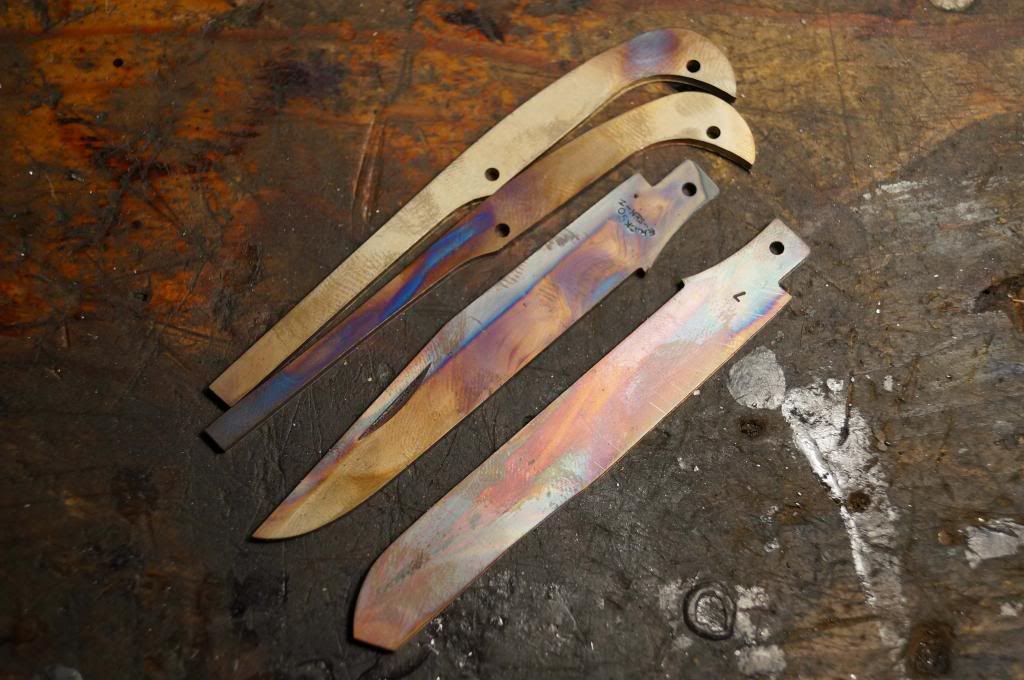

Had a chance to cut the pulls, stamp my mark and steel id, hardened and into the ovens for a couple of tempering cycles.

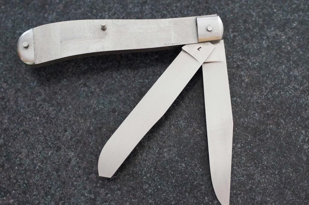

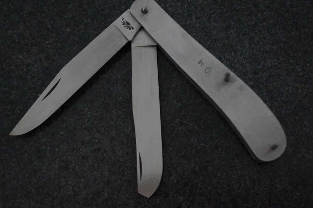

Was able to get back into the shop after a long weekend :).
Everything is fit up now, walk and talk established, liners relieved. Blades ground, still needing swedges and finishing of course. Next step will be to mill the frame/bolsters.
I love that slightly clipped spey blade, Ken.
Good eye James! Patterned after the Challenge Cut. CO. early trapper. Both I and my customer thought it would work well in a slimline.

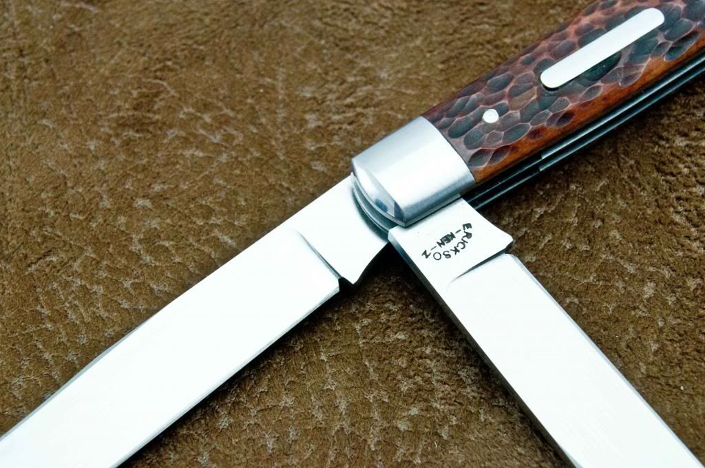

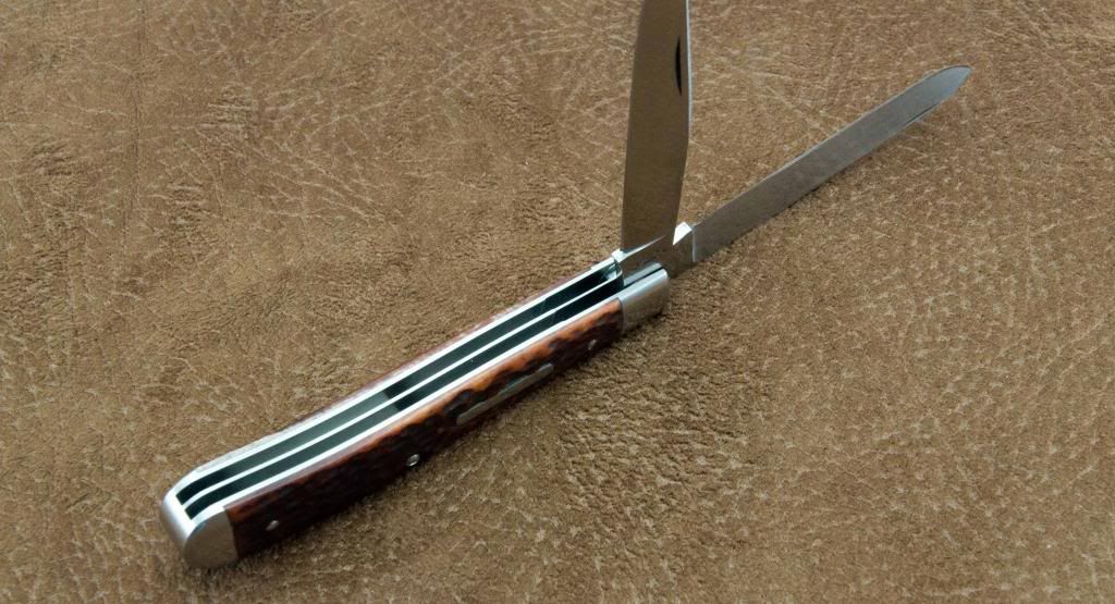

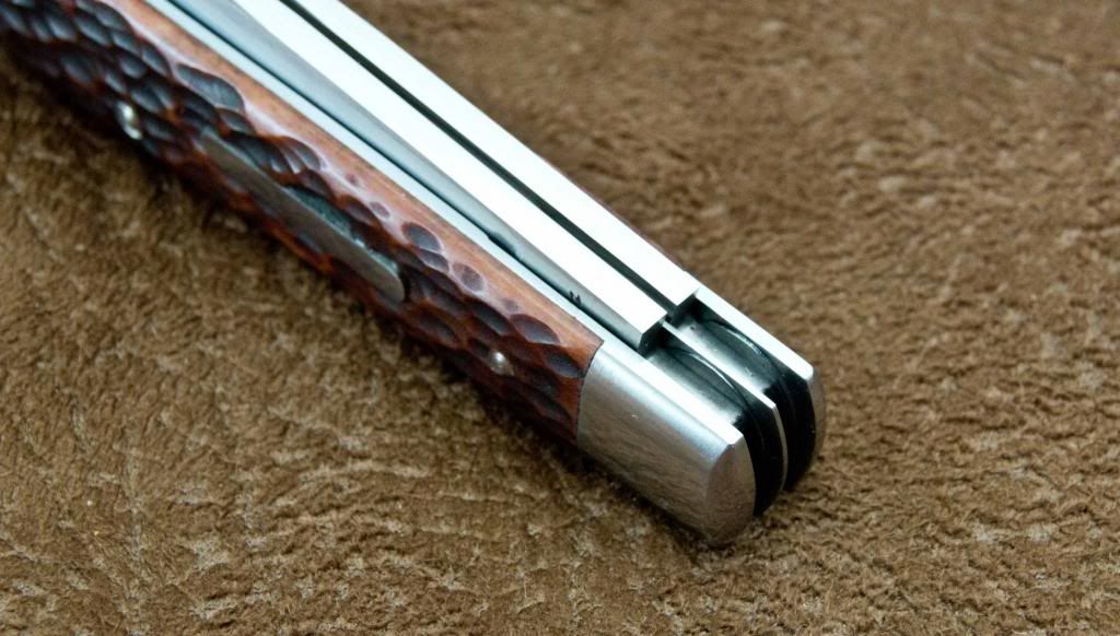

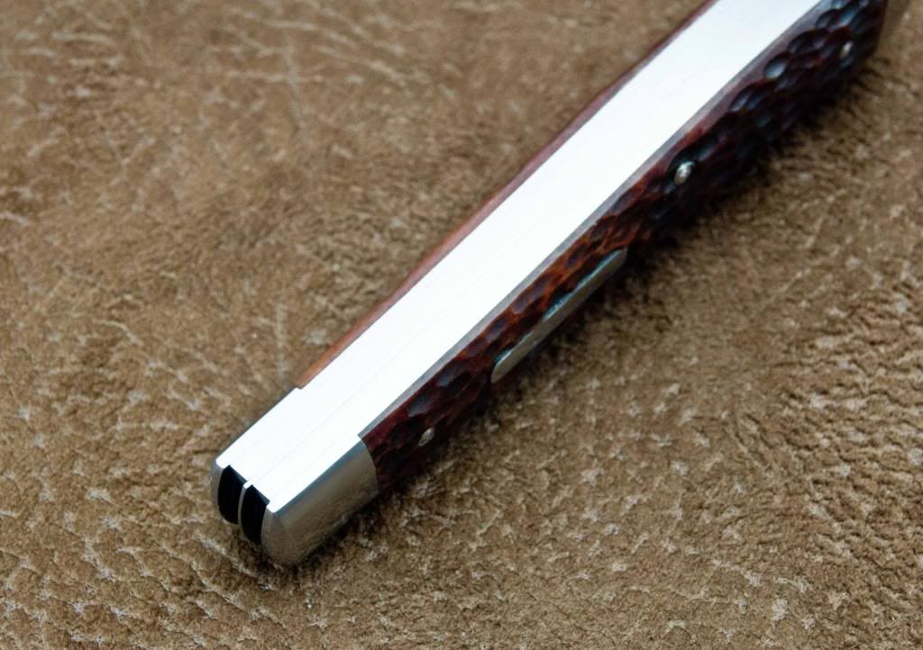

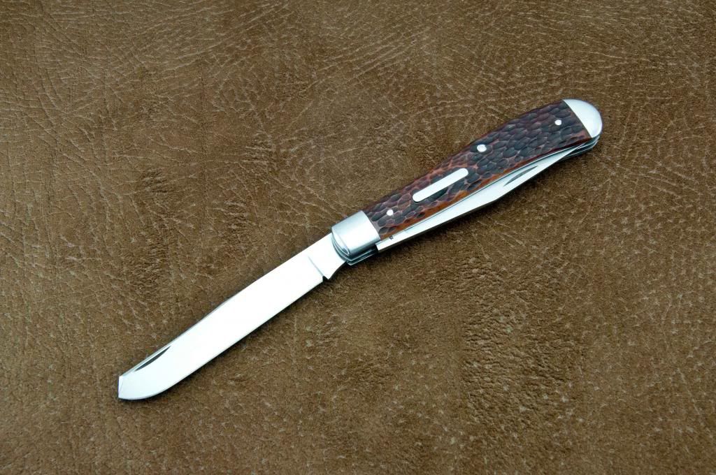

Had a chance to pretty much finish up the Slimline trapper,
3 7/8 closed
CPM D2
My dyed and jigged bone covers.
Half-stops
410 integral bolsters/frame
Pinned shield
That came out really nice, Ken. I especially like the look of the covers...jigging as well as coloration. Very nice.
