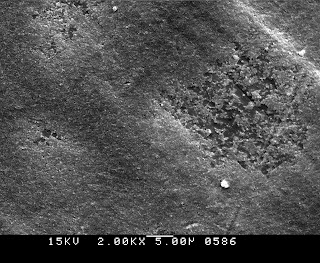

Here are a few SEM micrographs of some of my 0.125 micron or eighth micron CBN slurry formulations. This is 128,000 grit. The first image is at 2000x magnification. You can barely make out the individual particles.
We are already beyond the limits of light microscopy here for this sized particle.

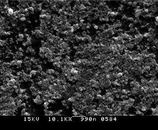

Here we are at 5x more magnification - 10,000x Note the bars in the pictures for measuring purposes.

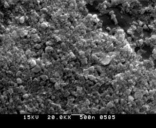

Finally here's an image at 20,000x Note the 500 nanometer measurement bar.

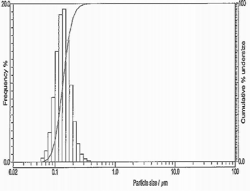

So here the individual particles are clearly resolvable, along with surface characteristics of the individual particles. The particles have a range of particle sizes. This is analyzed using a PSD or particle size Distribution analyses.
Here is the resultant output.
Now I have particluates that are 0.1 micron, 0.050 and 0.025 micron particles too, all coarser than my 0.015 poly compound. While light microscopy is of use for my coarser compounds, my compounds go well past the limits of light microscopy.
