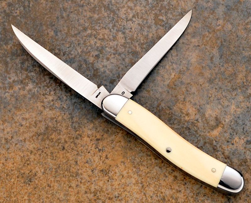

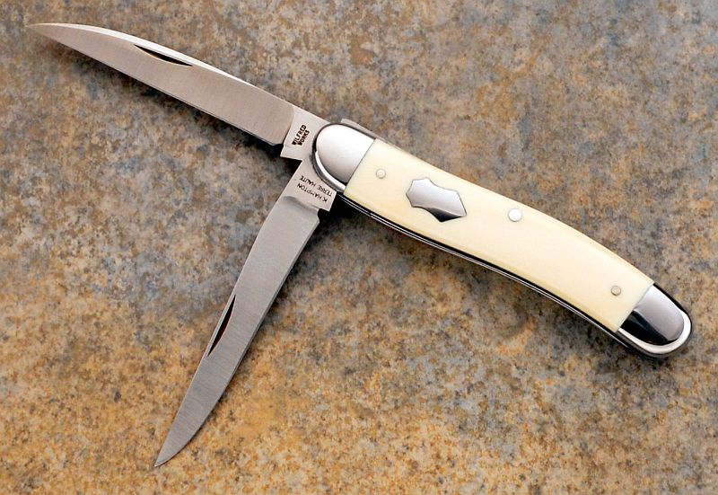

Thanks for all the various ways you guys show appreciation. I ...uhhh.....appreciate it. ;) Dang, did it really take me a month to finish that knife? :o

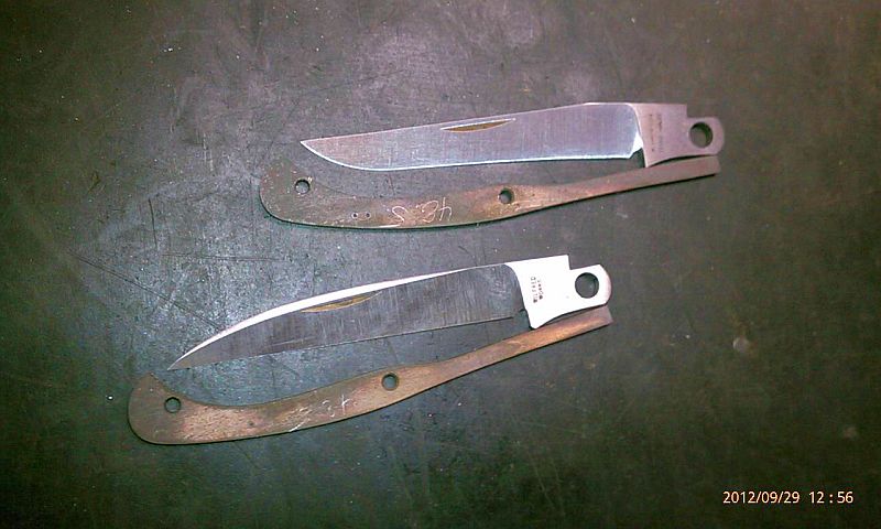

I've been working on this knife for a while as I am having trouble getting out of my summer knifemaking schedule :p I think it knocked that dang monkey off my back, though, and I am getting back to somewhat of a regular schedule. Anywho, this little knife doesn't look that difficult but those narrow blades are a bee-otch to grind, I'm here to tell ya. They are basically muskrat blades in a standard trapper configuration. I ground them on a 14" contact wheel and finished them to 220 grit and fine Scotchbrite.

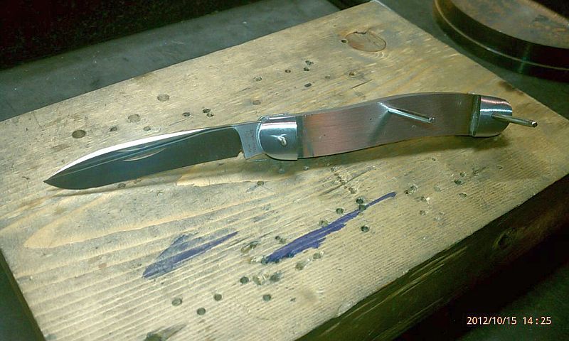

First, a couple of crappy WIP bench pix

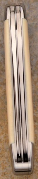

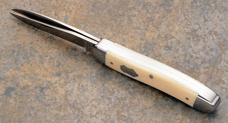

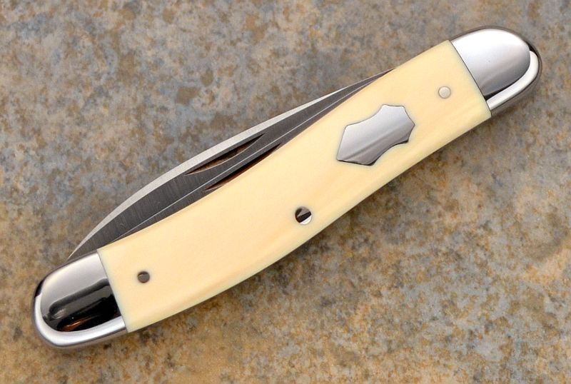

Finally finished...this is really a sweet pattern

Ahhh! sunk-joints too! Admirable curve on it, this knife has got an Old Sheffield aura about it.
Hi Kerry, You did a great job on the knife as usual and that pattern is a really nice one. WOW!
Kerry, awesome knife and incredible craftsmanship (as always). A question....any particular reason for the cam tangs (I think I have that right) as opposed for square tangs?
