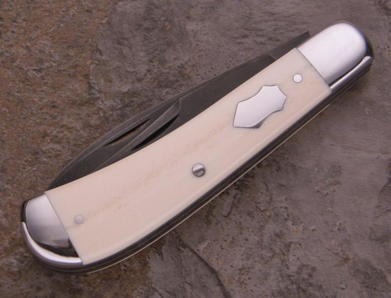

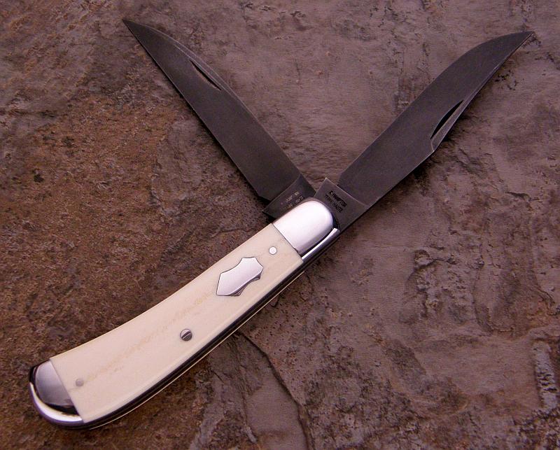

I need to baby this knife for a few days and allow it to dry out. Sanding with lamp oil always makes the ivory swell up a little bit. When it settles down, I'll sharpen it and send it South.;)

Thats a stunner Kerry ! The location and size of the pulls will make or break a knife and you nailed those (no pun intended, OK, maybe it was :D )

Do I detect an acid etch on her here too?

The ferric chloride etch turned out great.

Side note / question: Could the bolsters take an etch to match the blades?

no fear...the bolsters are 410 SS. FC won't etch it.
....but I was thinkin about what a hammered look would be like. :D
