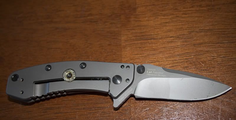

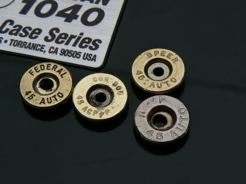

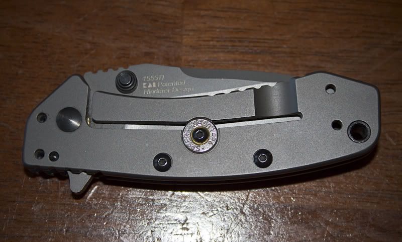

Thanks for the pointers Hatchetjack. I was hoping to use a .40 case, but it's just a hair too large. I went with a nickel case for this one and it worked out nicely.

First, I counter-sunk the primer pocket a little, then drilled out the center for the screw to go through. Then, I cut the very end of the case off, right up to the edge the extractor grabs. I used the screw and washer from the existing stabilizer and installed it onto the knife. Seems to be working well.

But isn't the primer pocket larger in diameter than the screw head? What is the head grabbing onto?
I use/recess the primer. The firing pin rarely hits center so I enlarge the hole enough for the screw to drop in.

Like hactchet's, I left the primer in and counter-sunk that. Sorry, I misspoke when I said primer pocket. I believe I used 9/64 to counter-sink and 7/64 for the screw hole.
So with the case head and primer cut in half, you aren't worried about them separating? Seems like they wouldn't stay together as easily.
Epoxy keeps everything together. Give it a try and you'll see how it all goes together. It's trial and error but you'll get it down.
