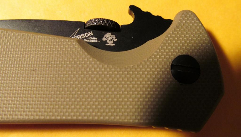

I received a 4K and 6K yesterday. The finish on both is fine, no machining marks. I really like both knives, but the blade on the 4K touches the G10 side when closed. There's also a design oddity...the thumb ramp cutout for the thumb disk is too far forward, making the blade harder to open one handed than it should be. I'll probably mod the scale to fix that.
You're right. I didn't notice that until you mentioned it. Still, the knife is by no means difficult to open. But having that cutout in the proper spot would make it even easier to deploy.

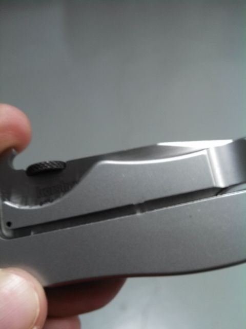

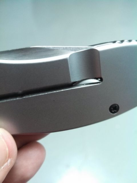

It looks like Kershaw may have to have a word with the plant that is manufacturing these about QC. I'm very happy with my 6K overall, but the finish isn't particularly impressive. I have the same machining marks in the jimping and lockbar cutout area that others have already posted, but there is a chunk of material left over from cutting the lockbar relief that wasn't removed.
However, the two-tone blade finishing is very nice and the primary grind and the swedge line-up very nicely side to side(something a lot of production knives struggle with). The lockup is rock solid and the blade centering is dead on even after slightly loosening the pivot which was a touch overtight out of the box. The edge was not sharp out of the box, but only took a couple swipes on a ceramic rod to get sharp, and the edge bevel is a pretty consistent width, especially on a knife of this price.
Something like this should not slip through QC. I'm pretty sure I can pick the piece out and clean up the area though.
