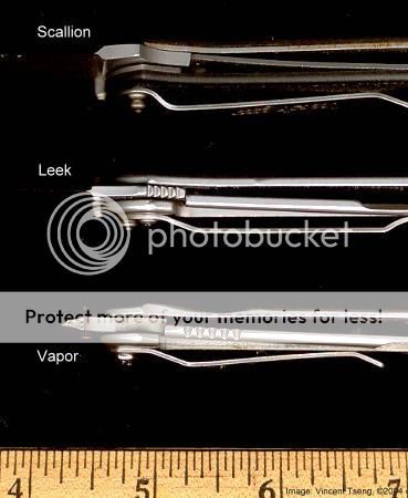

Dimensions and Weight -
The measurements are 4" closed, 7" open, blade length and cutting edge 3" - so it feels nice and right-sized for me - the handle fits nicely and the bead-blast matte finish is particularly fine/smooth. All the handle's edges are nicely rounded/bevelled.
Its weight is spec'd at 3.1oz whereas the same sized Vapor is heavier at 3.25oz - despite of the Vapor's numerous drilled lightening holes in the handle.
Why is that?
On closer examination one sees that the Leek uses a just perceptibly thinner blade stock (@ 5/64" (~0.078") vs. the 0.10" of the Vapor). Yet overall the thickness of the knives not counting the pocket clips are virtually the same.
The thinner blade is probably used to accomodate the Speed-Safe assisted opening mechanism, as well as probably offering an overall lighter blade for faster Speed-Safe activation.
