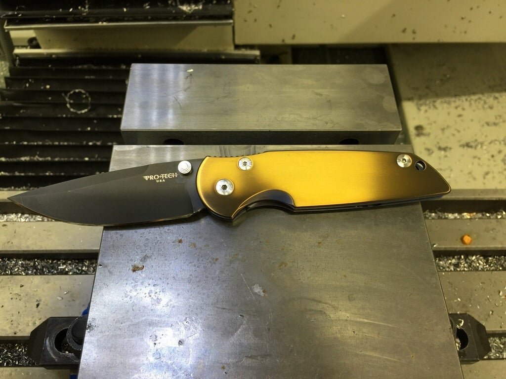

Here's mine......had it anodized.
Excellent knife!! Extremely smooth with an awesome blade shape that locks up TIGHT!!!
