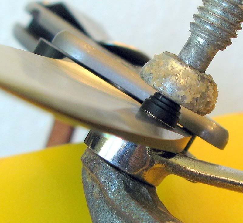

Here's a quick shot showing how I used a small C-clamp to squeeze the
thumbstud back into the blade, with a small box end wrench to act as a
well for clearance on the one side, there's gunk on my clamp from some
foaming done a long time ago...ignore that...;)
