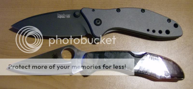

anybody have a pic next to a spyderco delica or a BM 707? I'm considering seeking one of these out but am pretty particular about the size of my edc. Thanks.

Best I could muster on short notice...
thanks. just what I was looking for. looks like a pretty good size to me. the difficulty I face seems to be overall length rather than blade length. for some reason people I'm around seem to react more to knives with larger handles and overall lengths than simply blade length alone. Looks like this one is actually shorter overall than the delica!! excellent news for me!!
