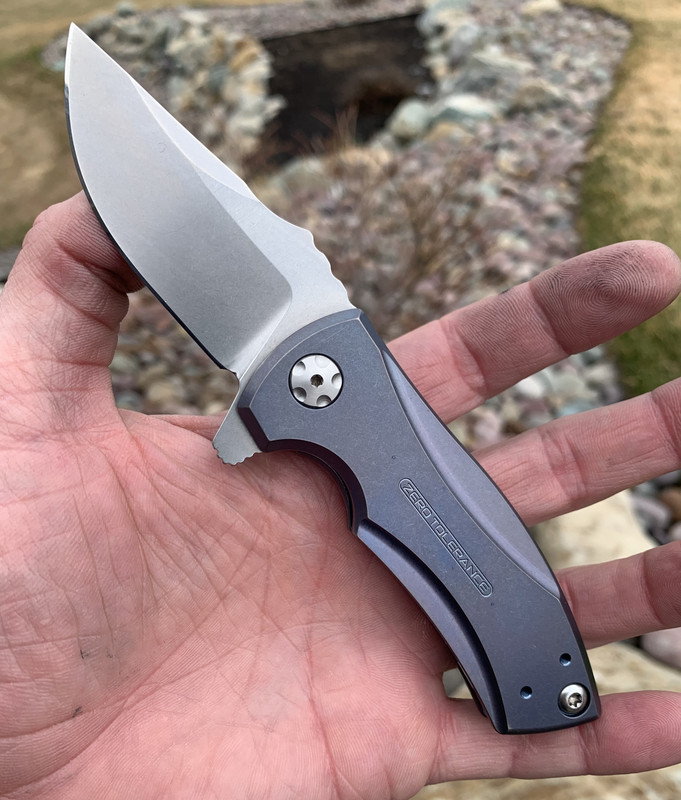

I know what you mean, it's called pivot lash and is quite annoying haha. I just checked my 308 and it's snug and doesn't have any. However as I was reading your post I was playing with my Skyline which has bad pivot lash and I was trying to think of a solution. I don't know why they made the detent hole so large, it makes it sloppy unless the stop pin hits the blade tang just right stopping it in the right place, however many aren't quite that perfectly precise. My Skyline is so bad that the edge hits the backspacer. I actually sanded down the inside of the backspacer to reduce that a lot. You'd have to have a slightly larger diameter stop pin to fix the pivot lash in your case. Honestly I'd return it if you can so you don't have to worry about that.0308 owners, do your 0308s have any blade play when the knife is closed?
I recently picked one up and while the knife is closed the blade has some movement.
I then looked at the detent hole on the blade and it’s huge - no wonder.
Just curious. It’s the first ZT I’ve owned like this, and I own a ton. I’ve seen this in other knives, but not ZTs.
Given the large diameter of the detent hole, it’s obviously intentional in the design tolerances.
Makes me wonder if they had trouble capturing that big, heavy blade with a smaller detent hole. Bounce-back on drop-shuts n what not.
I had a big dog Hinderer XM-24 that had the same thing - huge detent hole and blade play when closed.
