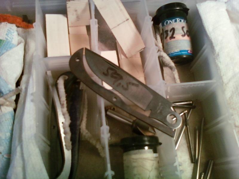

Here's what yer gonna win...well it doesn't exactly look like that now but I will show you more crappy camera phone pix as the game progresses. GOOD LUCK! Oooops, almost forgot...just post in this thread and yer in.
This is the blade and spring just after heat treat and tempering. Prior to this the parts are cut to shape, profile cleaned up, centerline marked on blade edge, rough grinds accomplished, tang cleaned up and taken down about .005" in thickness, and stamped. "59.5" is the Rc hardness

Now, judging from the scale of the OneTouch bottle(don't those make fabulous small parts storage bottles? ;) ) I'd say that's gonna be a sweet little knife!

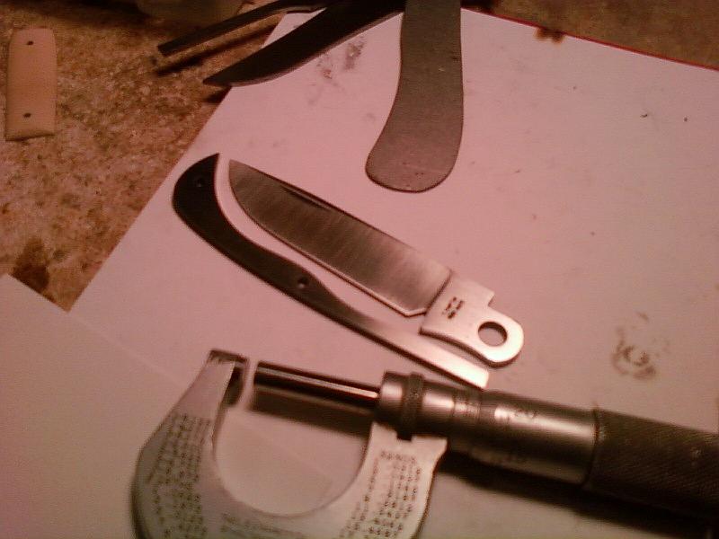

Wow, how exciting...got a few takers! So here's another crappy phone pic. Anybody want to venture a guess what color this is going to be when it's finished?:p
This is the blade right after finish grind and spring is sized in thickness to match the blade. At this point a get a bushing prepared to match the up with the set. After that, make two superglue sammiches with stainless and micarta for the handles.

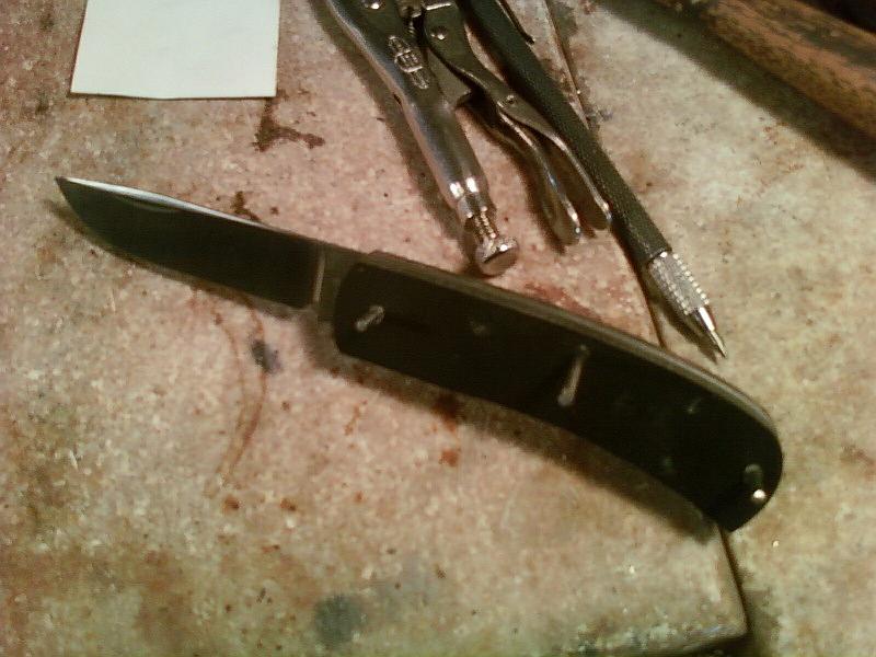

The knife is now together for the first time with rough liner/cover assemblies and will be shaped to final profile prior to milling tang relief. It's starting to look like a pocket knife eh!
