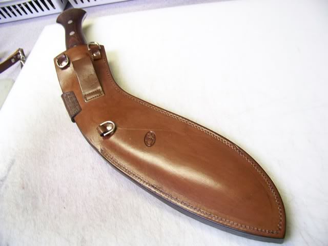

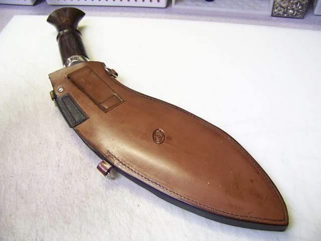

Here are some new sheaths Paul Long did for me
They are set up for baldric Carry
2 of them have Cape Buffalo skin from a Bull I harvested in Tanzania a few years back
the last one has a shark overlay
They are set up for straight up and down or canted
The doner of the overlay
CPL PUNISHMENT I used some of your design elements. Thank You
My Foxy Folly leather and Buff
M 43 leather and Buff
My BDC leather and Shark

Second, are those gusseted (3rd piece sandwiched between the top & bottom around the edge) or welted (2 thick pieces with space between them for the blade)?
Thanks for posting these it gives me some good starting points for making my next few sheaths.

I will try and answer your question
Paul's sheaths are deer skin lined so you actually have 4 layers
when you have an overlay it is a 5 layer
Paul does very fine work and has built alot of sheaths for me they wear like iron and only improve with age
I hope I have answered your question if not Paul is a good friend I can ask him more for you
Nope taking a closer look at the picture answered it they would technically be gusseted. I like leather sheaths, made right, they do tend to get better with age and gain character. My blackberry holster has taken some hits that in another case would have destroyed the phone:eek:

A couple of corrections, if I may. These three sheaths are all lined with light weight cowhide instead of Deer skin. Stronger and longer lasting under a strain and stress and less likely to wick moisture. (Since these are in transit to Joey, he hasn't seen them yet and was expecting deer Skin)
All, repeat, All my sheaths are welted with a 1/2" welt.
The thickness of the welt will vary according to the blade requirements.
I know all this stuff because the maker and I are very close.
Paul
