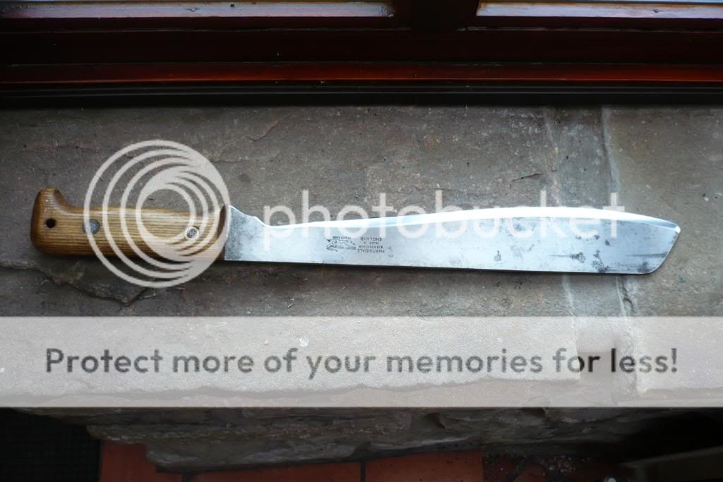

I still have my first issued Golok ...
I could get a good edge right up to the tip but the design did'nt lend itself well for "all round" use because of the lack of a proper point ...
This Golok is an old one ... it was from a batch going way back to 1966 ... made by Martindale in Sheffield the steel used back then is a lot better than the newer ones I have sharpened for others ...
The Khukri I had I have'nt got a photo of ... but it was similar to the one shown here belonging to a friend ...
My guess is that mine was a military design but not a mass produced military issue Khukri ... I suspect some of the Ghurka's use their own family blades ? May be the guys from HI might know more ...
After losing this first one I snagged a few issue ones from stores but they did'nt hold an edge well ... perhaps though they just needed a few more sharpenings to get to the tempered steel ... they did have a polished finish ...

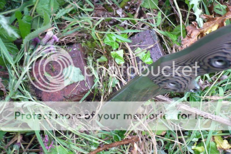

For the OP ... I did this task using both a B11 and the TTKZ ...
The B11 can chop well and is a great knife ... the TTKZ just does it quicker and IMO with less effort ... but it is heavier so go with what works best for you :thumbup:

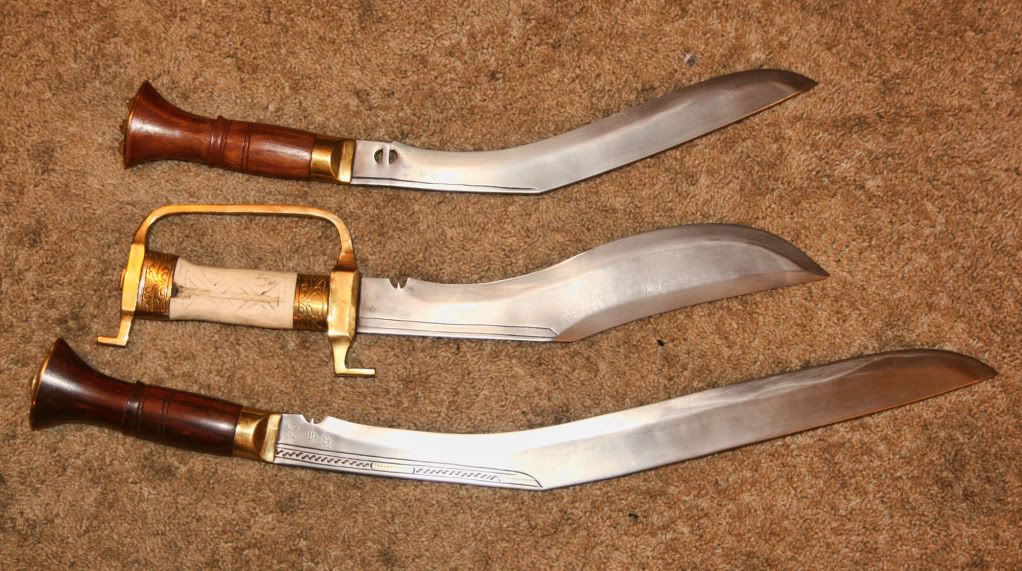

Hi Doc,
Mine is nothing compared to many meisters here.It's night-time here so i will get some pics up later.
Meanwhile these 4 are my current users:
Himalayan Imports Amar Singh Thapa Khukuri, 18" hollow forged, 35 Oz.
Himalayan Imports Gelbu Hybrid, 18" hollow forged, 26Oz.
ToraBlades Havildar, 19" Hollow forged, 22Oz.
Torablades Khrisna Budhune, 20" hollow ground, 25Oz.

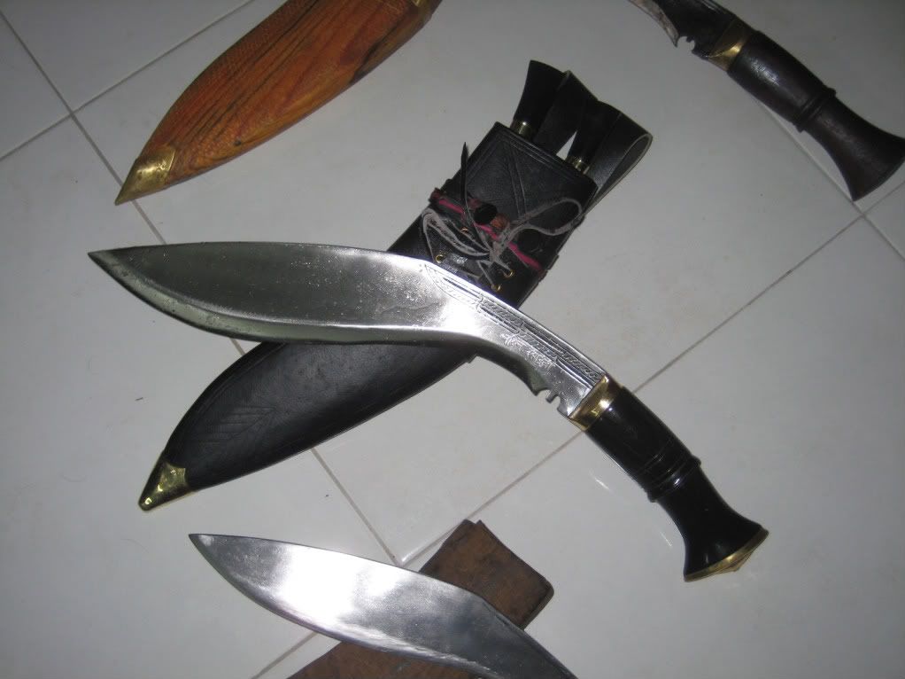

Kukris can be broadly classified into two types: Eastern and Western. The Eastern blades are usually regarded as the thinner and are often referred to as Sirupate (Siru Leaf). Western blades are generally more broad. Occasionally the Western style is called Budhuna (refers to a fish with a large head) or Baspate (Bamboo leaf) which refers to blades just outside of the normal Sirupate blade. Despite the classification of Eastern and Western, both styles of kukri appear to be used in all areas of Nepal.-Wikipedia
Notice this Gurkha has another khuk on his left, unsheathed.

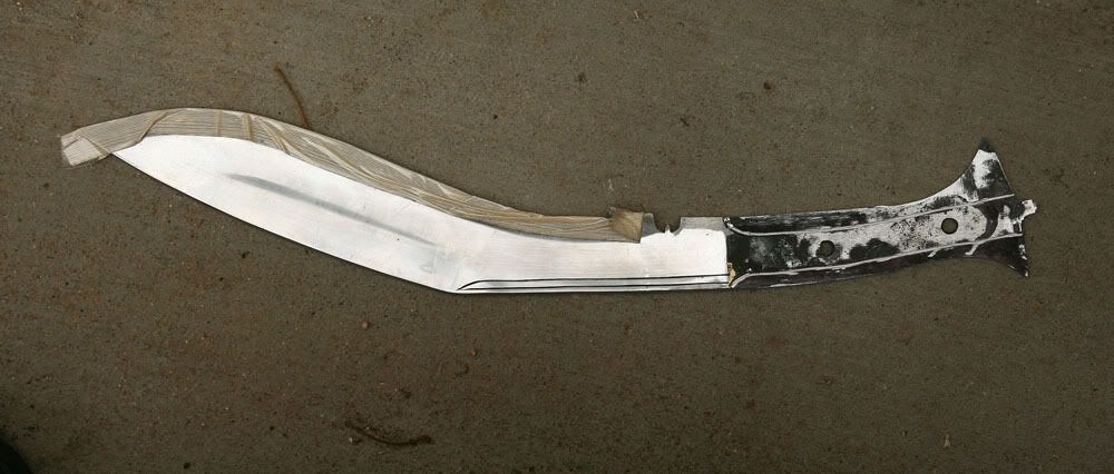

This is what I started out with, actually more than this because in the siru and ang khola models I had at least three 18" models and three 20" models, to try to get a better hamon, balance or blade shape and profile. In this image, I don't even know if I could name all of them any more.... from left to right, a bilton, 18" ang khola, I completely forget the name, an uncle bill special ultimage fighter with d-gaurd, a cherokee special with carved handle, an 18" khobra, a 20" sirupate, a 20" dui chirra (dual fuller), a 30" siru, a falcata, an uddha sword, a gorgeous tibetan sword with dual colored handles, a patang short swrod, and a katana
This is what I whittled it down to as I got a bit poorer and had to start paying bills/the massive tax debt I had accrued for that year (2006). I beleive that the 18" ang khola is by sher and the 20" siru is by amtrak. They had the best balance out of all of the models I had tried, both with good tempers that ran the length of the edge to the tip and had good ring placement on the handles. You can vaguely see some of the hamon lines, though the image is small and the lighting poor for highlighting them.
Until I got down to just the 30" ang khola by sher and the 18" ang khola by sgt khadka. This is it's original form, with a beautiful thin taper on the tang

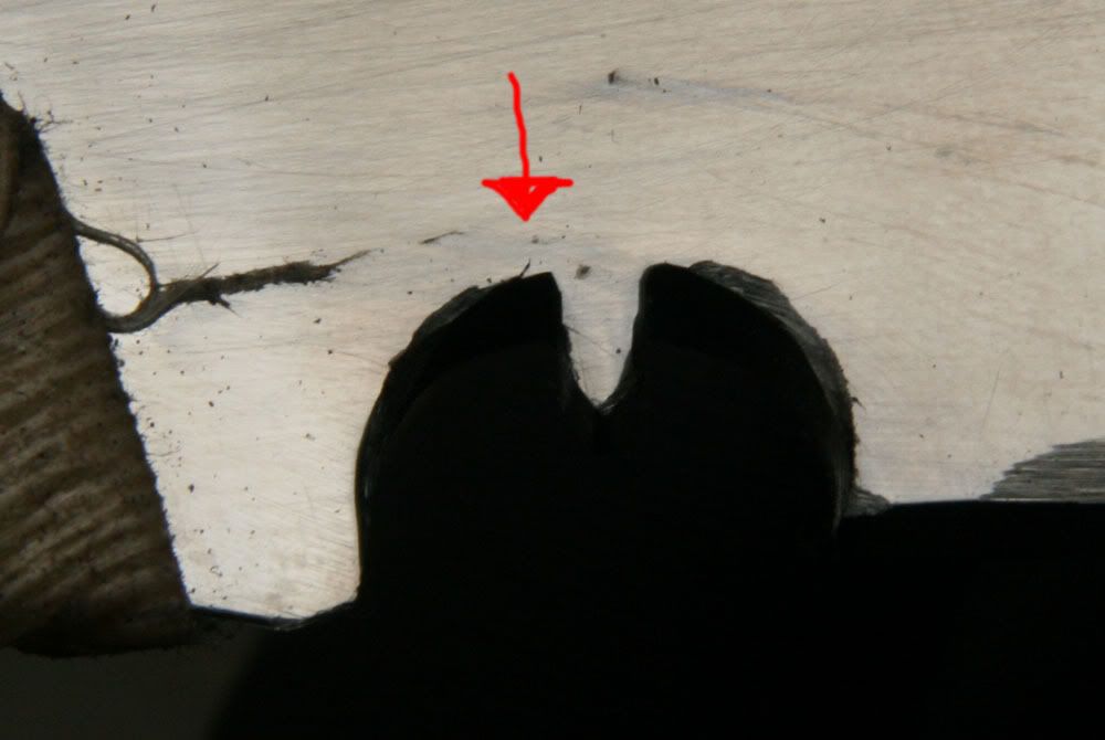

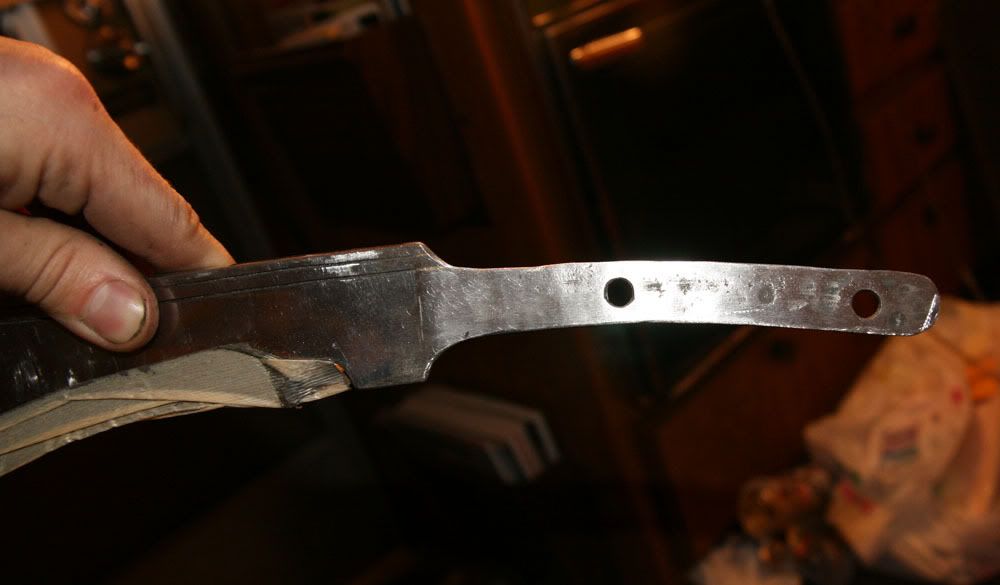

The originalform of the handle. Note the bell's size and sharpness, not all of them are like this. It depends entirely on the handle maker that carves the wood for it, or the kami who forges the tangs profile.

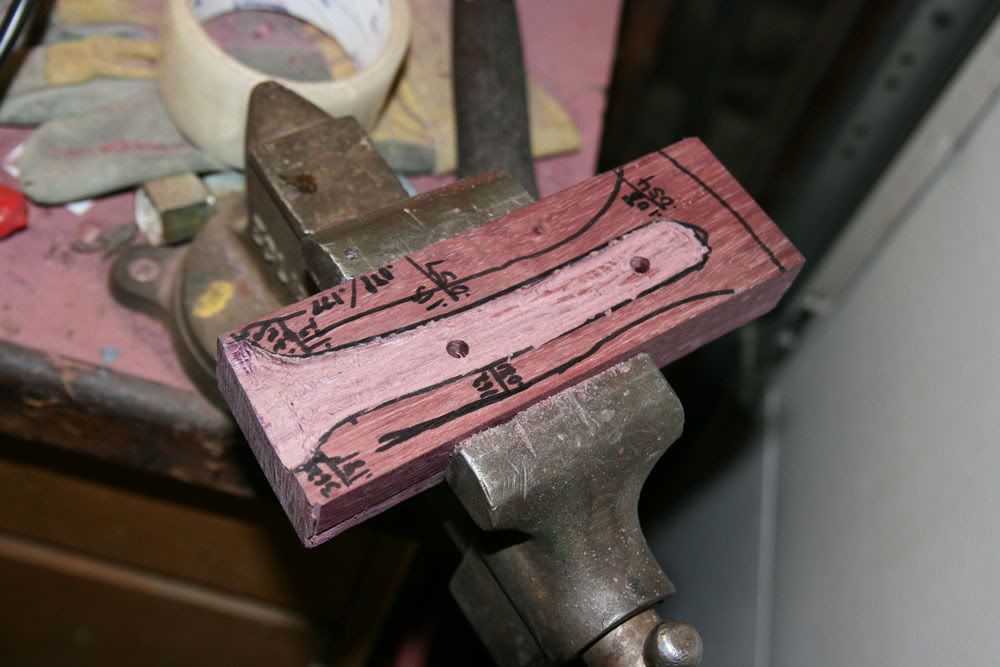

The day the tang sheered, you can see the bright edge at the pommel side of the spine, and at the pinky position on the bell. I had sanded the ring off because it was too sharp. I did this while bashing it through a 10" 1/2 log that had several large branches running straight through it. I was force-splitting one of the more twisted peices of wood I've ever processed, really wailing on the spine with a 3 pound 4" diameter baton. I didn't actually cut through the branch, I ended up knocking it out of the wood.
Tang cut down to a hidden tang
The scales
the finished product, next to a choiless BOSS jack, a B11, a KZ2 and a TTKZ.
So.... this is a visual primer to what I have, what I've had, and what I'm using now. It'll take a sec for me to write up an opinion/compairison.

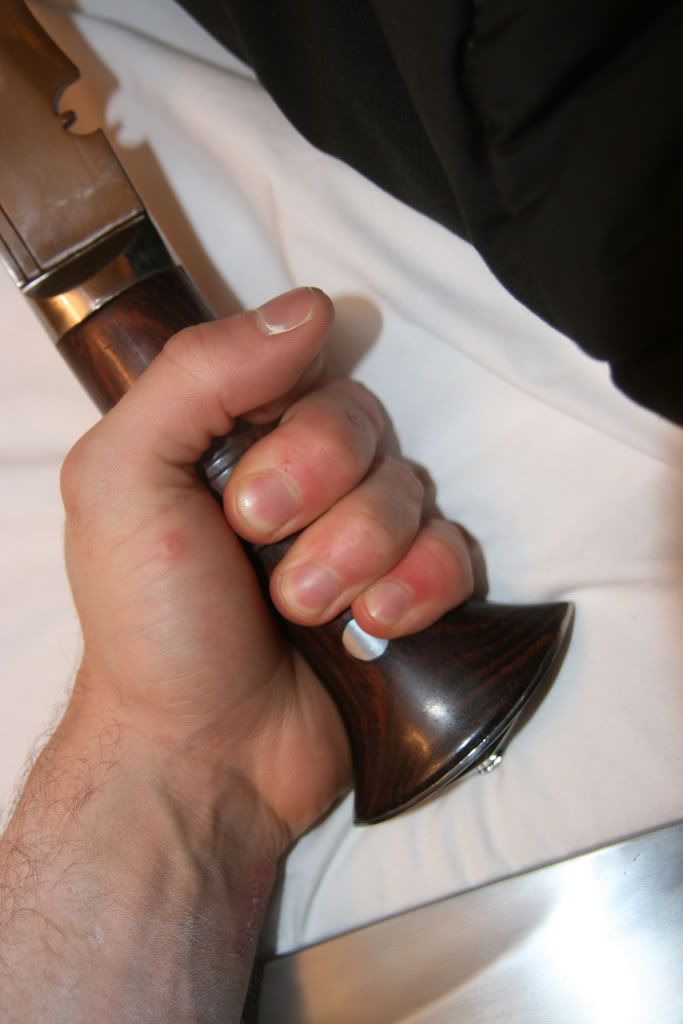

1 - Handle Construct
There are 2 types of handles that HI produces, a hiden stick tang and an exposed full tang.
This is a NOT an HI blade, but it shows the basic shape of the stick tangs you'll find:
This is what you'll find in the 'chiruwa' style, or exposed tang:
keeping in mind that the tang is heavily tapered towards the pommel. Both of these types of handle constructs differ from Busse because busse uses either a thick hidden tang:
or a full exposed tang at full thickness from ricasso to pommel:
This means that with Busse combat you have a LOT more metal in the handle. So much that it can alter the balance drastically. Many would say that a full exposed full thickness tang makes the knife stronger, in practice most of the stress that's applied to the knife ends up in the blade itself because that's the major bend point. As long as there are no sharp corners and a consistent taper from ricasso to tang, you shouldn't have any major stress points in your handle, thus the construct of the handle in regards to catastrofic failure is not as big of a factor as many would beleive. Failure of the handle material itself is very important however. The sheering of the aluminum tubes in my previous post is a good example, alluminum pins are not strong enough and do not have a high enough sheer strength to reliably hold the scales onto the knife. Busse's nickle tube fastesteners can sheer as well, but take more force. In the hidden tang knives, busse's resiprene c will split, but it takes a lot of force to do so. Himalan imports wood will split. In both knives, a loos handle is fixed relatively easily - with busse you can shove a rod, stick, or tie paracord around/through the single tang hole, affixing the rubber to the tang. In himalayan imports you can peen the pommel's exposed tang to flare it and push the handles back into position. If this tang knob fails however and you don't have enough to peen, you may have to remove the brass cap and do some shaving to get it into working order. All of Busse's handles are man made, or 'stabalized', meaning they have been soaked in a vacuum chamber filled with acrylic resin, or something similar. The result is a hard chunk of plastic/acrilic/man made product with natural materia's floating in it. Himalayan imports uses natural un-stabalized materials that can shrink, swell, and crack with varying temperatures and humidities. More care has to be taken to keep them in working order over time.
Handle ergonomics are important. This is just a generic example of the difference between a a large belled hidden tang handle from himalayan imports and a machined ergonomic grip from Busse:
One is very simple (with the ring too low for my tastes), which is workable form every angle but will turn more readily in the hande, and the other is highly textured and with a lot of various curves. Both have a similar pinky position curve, but the bell pommel has a curve that will interact with the palm and wrist more. it is very much a matter of preference. Neither is perfect, Both are highly functional.

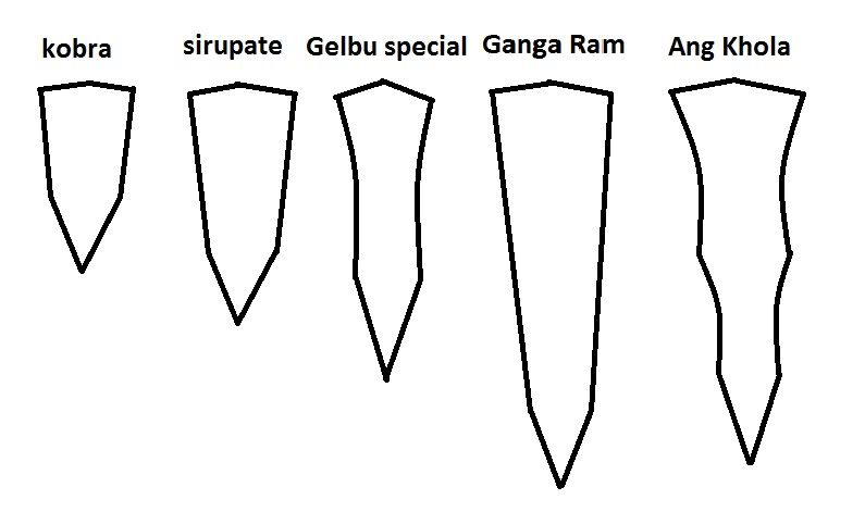

2 - Balance
There are two factors that effect balance, handle construct and blade shape/thickness/geometry. Himalayan imports has much, much, much less metal in their tangs - this pushes the balance point towards the tip. Himalayan imports are consistently thicker at the spine than busse, ranging from 3/8" to 1/2" thick - this again pushes the balance point towards the tip. On my CS TTKZ the balance point is 2" forward of the index finger, on my sgt Kadka AK the balance point is 5 3/8" forward of the index finger. That is a HUGE difference, and is immediately felt picking it up and in use.
You can see how much thicker the 19.5" Ang Khola is at the ricasso, and that it continues on to the tip. Also note how much less metal there is towards the hand.
The AK takes less force to get the downward swing into motion and thus feels more like an axe or a hammer. Yet it weighs less overall than the TTKZ because of the reduction in metal at the tang and because of the 2 long/tall fullers. You get something that chops equally well but with less weight. I can tell the difference in feel, with the AK putting less strain on my forearm/hands to get it moving than the TTKZ, but not in how much wood is removed:

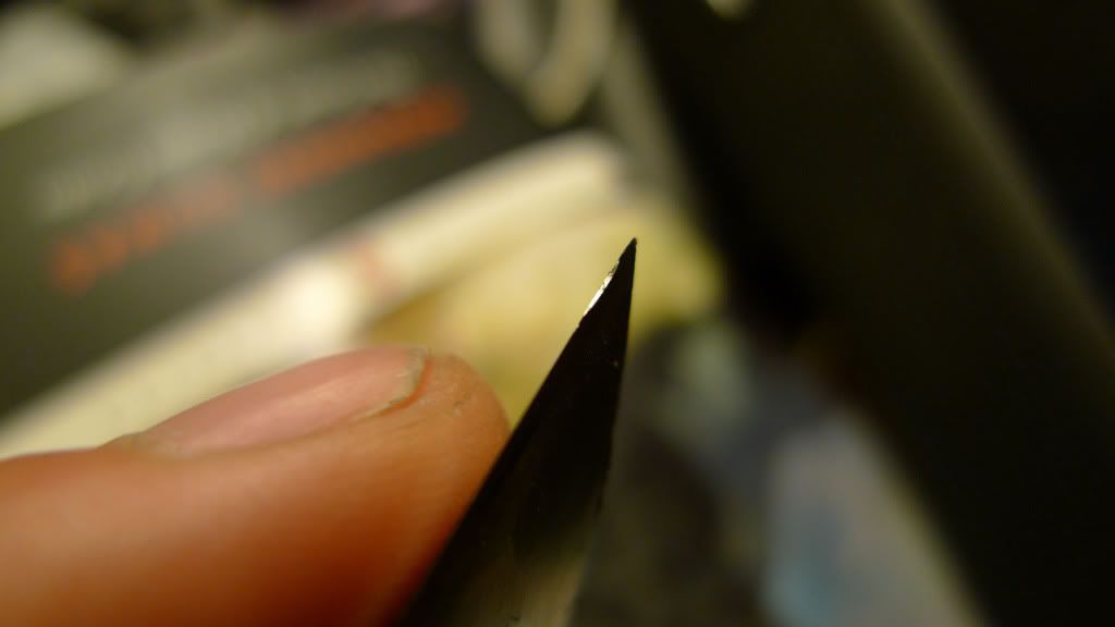

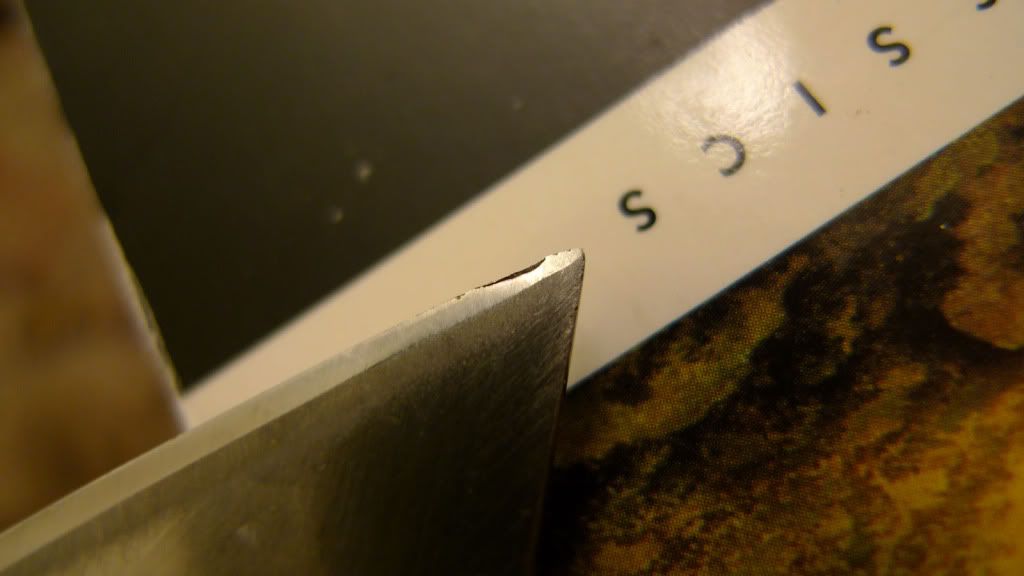

4 - edge and blade geometry
Busse has a huge variety of edge and tip thicknesses. On the blades that they expect to see heavy abuse, they tend to go with much thicker geometries, and with their slicers they go much thinner. this is a Tank Buster next to a Mini Sus Scrofa
This is normally mostly consistant on the cg models. The cg KZII had a thicker tip than the TTKZ which was much closer to being a custom shop type knife with it's satin finish. But, here is the tip of a TTKZ next to my 19.5" ang khola. It's worth noting that the 19.5" ang khola actually has a substantially thinner edge than the TTKZ. Even though the tip appears to be equally thin and sharp, it does not continue like that into the edge, the TTKZ has a very robust and thick edge that leads into a very thick, robust and not-tall convex grind. See the thickness chart on this page for reference.
The thinness of edge and tip isn't isolated to just the smaller models, this is the tip of an enormous 30" ang khola:
Busse often makes VERY, VERY, VERY robust tips, and often has robust edges. I've found, through the variability of makers, that tip and edge prifles with HI vary in the extreme. I've had super thick edges on smaller 16" siru's and I've had paper thin edges from sher on his 30" Ang Khola. This varies almost entirely on the maker of the particular blade. Jerry also has variability such as the MOAB geometry vs. the CABS, where the CABS is really really thin at the edge and the MOAB is really really thick. But as far as the TTKZ goes the edges are tuck, and the tip is relatively acute. For a reference of overall geometry between my 18" Ang Khola and the TTKZ (and it's custom shopped form):
You'll note that the HI AK is both thinner and thicker, the geometry is just very different, but not necessarily worse. A direct comparison is complicated more by the variability of geomtry between models from HI. Busse only has a few types of profile - 1/2, 3/4, high saber or full, flat, hollow, deep dish or convex, and single fullered. But most of those are isolated to random models, not to the khukuries. The khukuries only have 1/2 saber convex, and full flat. HI on the other hand has multiple grinds that vary between convex, flat and hollow depending on the maker. Heres a basic idea of the geometry types, all of which can bee 18" long and in the TTKZ catagory for size:
This goes back to HI allowing you to really sift through different models, weights, balances and geometries to finda khukuri that best fits you. with busse you have 2 options, unless you have the custom shop modify it for you - but even then you won't have the sheer number of variations present in HI's catalog.

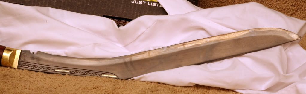

5 - steel and metallurgy
This is one of the biggest yet often not understood differences between the companies. HI has always sourced out 5160 or comparable metals, though it may be something slightly different as there are different steels used in car springs like Nissan and Honda's. Their heat treating varies drastically by maker. Generally the sweet spot is always hardened with the spine left soft. Depending on the maker, you may get hardening at the tip and recurve, it may be less hard or it may be very close to the same hardness across the entire edge. The most important part of this is that you NEED to acid etch your blade to see what is going on with the heat treat. If you don't you are gambling and will have to guess at it as you use it based on rolling/mashing/denting tendancies at different positions on the edge. Here is a series of etches I've done:
One of the most beautiful hamon's I've seen on any model, good hardening at the tip, good depth, good on everything. Only a small portion of the ricasso edge is unhardned, but I'm okay with that because it reduces the likelyhood of a stress risor in the often rough edged cho -
all three of these have hardening from the sweet spot to the tip, but all of them are softer at the tip then at the sweet spot. If they are hardened in the recurve, it is less hard than the tip. This is because the water is poured on the sweet spot, the moved to the tip, then moved back across to the recurve, meaning it has air cooled the most before being quenched.
While working around some rocks doing a test between the 18" ang khola and the TTKZ, I bashed the tip of the AK on some of the rocks. This was the resulting damage, and the reason for the slightly softer tip area:
When you view this damage I want you to use a critical eye for the size of the damage and the type. It's very small, not going past my very small 24 degree per side secondary bevel, and it is a roll - not a chip. I have done the same type of miss-swing strike on round rocks with busse's and the damage was almost identical. This is the ideal situation for a khukuri. If the edge was brought up to a full 58-60rc it would have been much more likely to chip. I've done this on too-hard siru's.
This is a very different type of heat treatment from busse. If you say that busse's is significantly better, that does not necessarily detract from the quality and function of HI's methodology. When done correctly (again, etch your blades and find a Kami that is consistent like Bura, Amtrak or Sher) the sweet spot is hard and holds a great edge, the tip is damage resistant and still holds a decent edge, and the recurve is hardened enough for pull/push cutting but soft enough to resist stress risors at the cho. It is a good working system for making knives int he fashion and situation that they are made in, in the hills with a coal fire and a kettle of water. Remember - this is not so different than the water quenches used by master smiths in america who sell their blades for 1,000$+. The quality of the end product is dependant on the skill of the maker.
Which is the point that we come to manufacturing consistency. Busse has this hands down, without question. You can't really hold up an argument that the old methods produce a consistently better blade than modern manufacturing technique because they simply lack the scientific metrology and quality control methodology. Himalayan imports relies entirely on the ability of the maker to see temperature based on color - He will not have control of the temperatures down to 5 degree's like busse will, nor will he have the ability to perceive time down to the second like a modern heat treating oven. They rely entirely on the Kami to see cracks and defects, Busse uses penatrant dye testing with modern equipment like microscopes. The kami relies on assumption based on experience for how hard the blade is, or on the feeling of a fresh file running across the edge - Busse uses rockwell testers that are accurate down to an RC point (or moreso). You can't reasonably argue that HI produces more consistent blades or is less likely to have failures. It isn't possible based on the equipement, technology and education involved.
That said, I go back to my original argument that unless you are in life or death situations you likely won't need the level of consistency Busse affords. Things like this:
are technically stress risors that can lead to failure, but the vast majority of the time they do not develope into larger cracks. And with a slight modification like what you see in my modified handle (I rounded out and polished the cho), the stress risor is almost entirely nullified.
As far as steel and differentially/full hardening - If you can produce a blade that has a higher bend strength (more pressure required to get it to bend, and more pressure required before it breaks or takes a set), and maintain chip resistence across the entire edge while having a a fully hardened blade - There is no benefit to differential hardening. However, if you want a super hard sweet spot that has amazing wear resistance, you can get that out of HI where you can't with busse. All of busse's standard INFI is the same, there is no variability in wear resistance. 5160 put to 62rc will have higher wear resistance than 58rc INFI, but it will be more prone to chipping. It's all in what you want, what you need and what you can afford.
