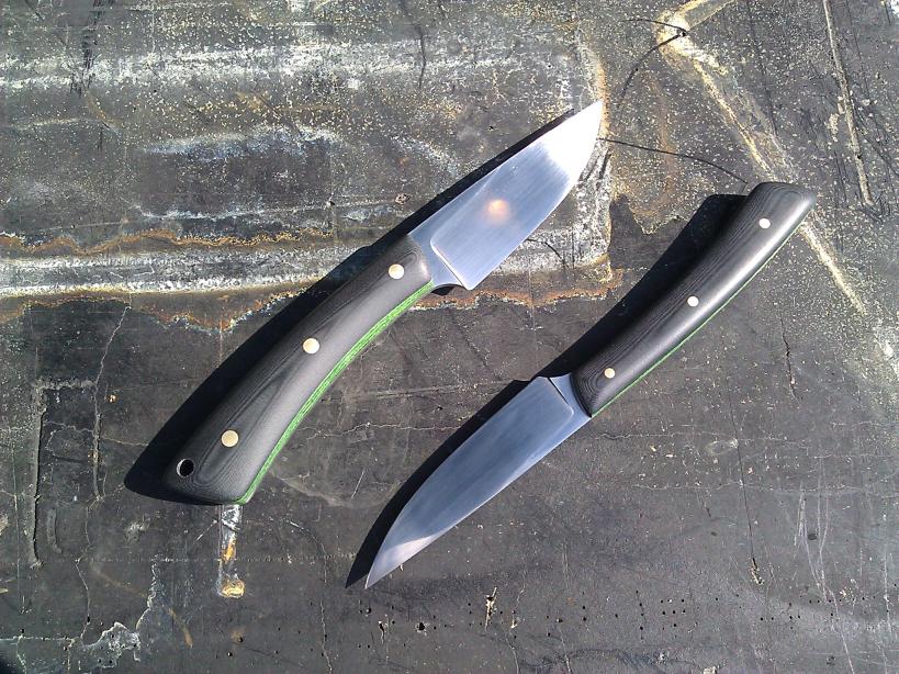

Here are a few paring knives that were featured in the gallery.
The first two:
A matched pair hiker and paring knife for a couple:
