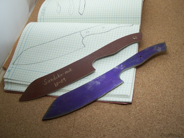

A birdie tells me there may be pics of a Sandokumuk today.
oooohh... that looks great Andy...:eek: i have really been wanting to pick a few nice kitchen knives lately...:)
AND, I'll tell you that I'm in love with 440C after grinding it! WHOA! That stuff grinds like butter!
Two!! Whoa. Man, I ground on it today. Tender. Gentle. Lots to get used to. The blade is 2" wide, and 1/8" thick. Imagine what angle you're trying to stay within! Glad I had some experience making Nessies. I wish I was Dan Koster sometimes.
OMG - this is right up my ally. I've been searching for a good Santoku to replace my existing one. Glad to see you are doing this in 440C. What angle are you going for on the edge. My Shun chef's knife is 17 degrees and it cuts like a dream.
Did I say I'm excited about this project? I'd love to have a custom kitchen knife. What are you thinking about for the handle? I really think a stacked wood handle would look great or even some type of bone like camel or something. I can't wait to see what this one looks like in the end.

The handle is probably not going to be wood. The thing should be dishwasher safe IMO. It'll have three corby rivets, and probably g-10 handles. Paper micarta also wears well in the dishwasher I've found.
Y'all might get a passaround. Its a thought. Depends how good it comes out.
On the angle I really have no idea. Its hard to measure this on a convex knife!

You should see it partially ground. The blank sat on my lap all last night while I watched TV.
