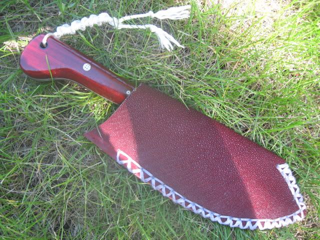

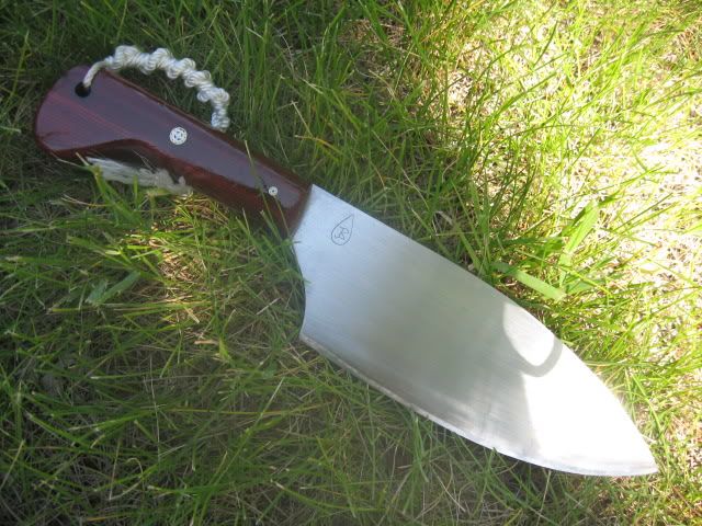

Would you comment on how you would change my design to fit your criteria? I made this knife this summer for my best friend's wedding for the uses you describe (camp and kitchen). The blade is a hair under 6" so I know it is too short, but otherwise 1/8" 440C (I usually stick to 3/32"), dropped tip, handle clearance and dropped blade to get close to the edge. Can choke back on the handle pommel for some chopping, yet is balanced @ the blade handle junction.
Thanks for any feedback on what you would be looking for with this design (anybody feel free to comment so I can get better).

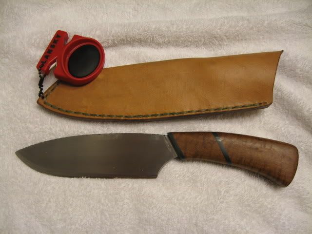

These two follow the same mould (similar lengths, 3/32" CPM154):
Not trying to plug my stuff, just looking for feedback as this was the purpose for each of these knives. Thanks
