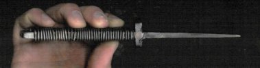

I decided to be a smart ass, so I made my entry for the ugly knife contest and packed it in the box with a really nice cardboard sheath (corrogated!) :p My actual entry for the KITH was a small 440C framelock, which I put inside an evelope marked certificate of authenticity along with the paper with the specs and packed it in with the ugly knife :D
So here is what Marcel should have pulled out of the box first. Its ground from 1/4" thick stock thats off of a plow or feild cultivator, don't know what kind it is but it wouldn't harden much. The finish is a nice tactical black (read:heat treat scale) and the handle is wrapped in genuine black diamond baling wire. Gaurd is also 1/4" thick steel,arc welded on because silver solder is for pussys :p

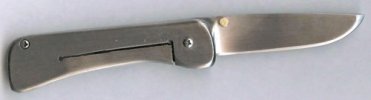

Here's my real entry:
Blade length: 2 9/16" long .125" 440C
Handle :hardened .125" thick 440C, both slabs and the back spacer
Thumbstud: brass with copper
Pivot: .125"
Made for easy takedown. There is a hardened steel pin in a blind hole through the spacer and one 2-56 screw through the butt of the handle. Very solid knife if I do say so myself.

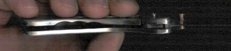

Lock up. I'm hoping it will wear in for him. Its only my second frame lock and both started out really stiff. I could hardly work this one with one hand, but the first one was the same way and it loosened up pretty quick when I started carrying it.

Was I supposed to open the envelope? Thought is was just packing material and threw it out. That fixed blade is a real show stopper and is the highlight of my collection. Just kidding. Got busy over the weekend and couldn't take pictures. Too busy shoveling out from our latest snow storm. That little folder is definitely stiff but it seems to be working out of it as I play with it. It's just the right size for pocket carry . Thanks Matt for doing such a fine job.
