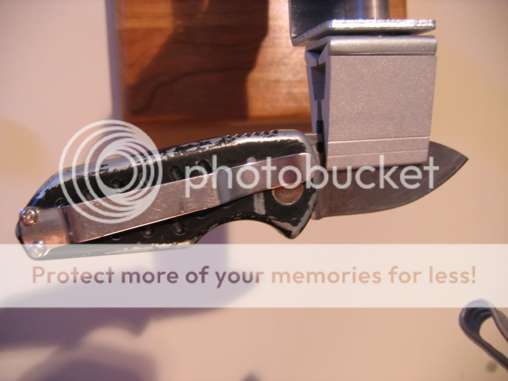

Kershaw Chive.
Another smaller knife.
Got the front curve to the tip very sharp.
The internal curve got sharp but not as sharp as the tip end curve.

I was asked the following (paraphrasing):
>> How short can you sharpen?
I got this knife to hair shaving sharp.
