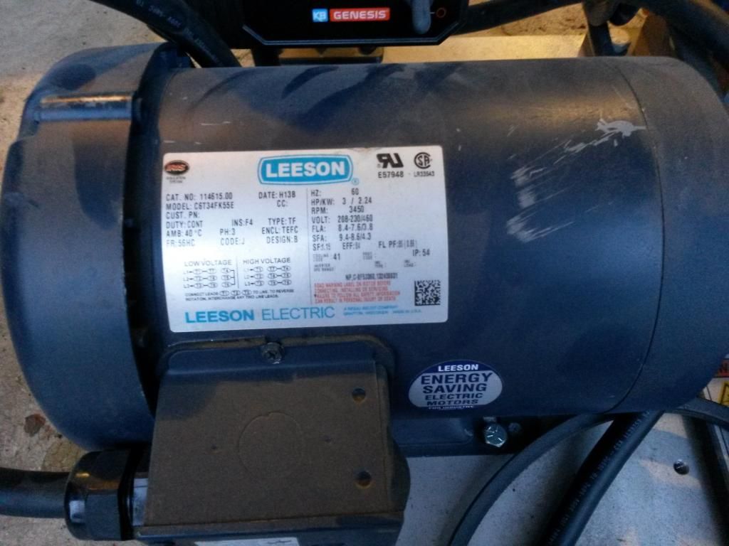

scuffing on the motor. Oops.

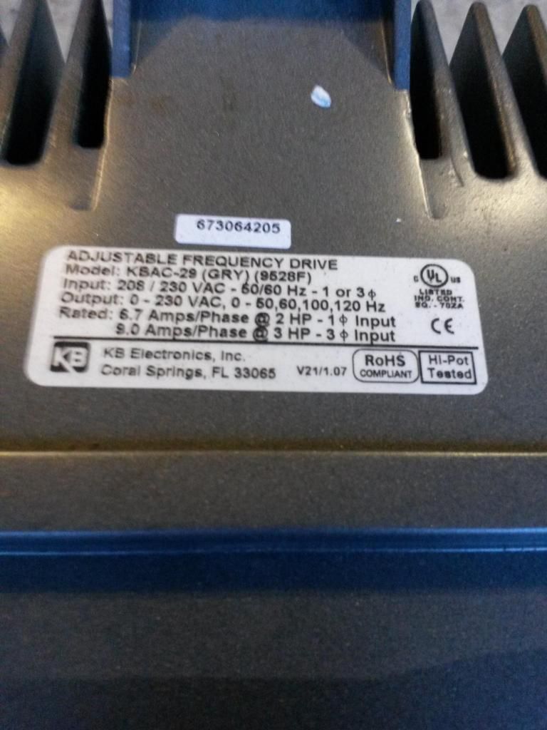

if i am reading this correctly it looks like you will need three phase power to run that motor with that drive, right?
You'll need that to get 3hp output as far as I know, but you can run it with 220v single phase input and only get 2hp out of the motor basically.. Not sure if that'll cause long term damage to the motor or not, but I've run one like that with no obvious ill effects.
KB Electronics makes two versions of the KBAC 29 unfortunately, one that needs 3 phase input to hit 3hp, and one that doesn't. I ended up with one that does, like this one. Running from my phase converter now.
The VFD can run on single or 3 phase but the Motor I believe can only run on 3 phase. At least that is my understanding. So you will need 3 phase power to work this unit or a phase converter. Someone please correct me if I am wrong.
The VFD IS the phase converter. It runs on single or three phase power in - three phase power out. The motor runs off the three phase power coming out of the VFD (phase converter).
