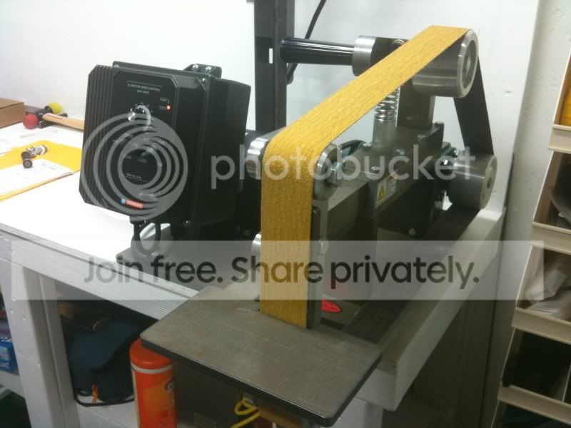

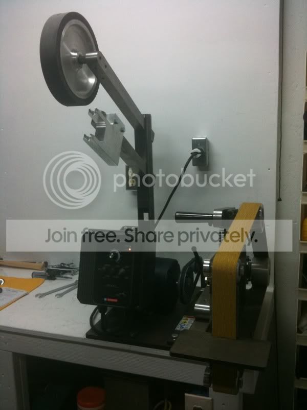

I wanted to thank everyone for their help. I decided to go all in and went with the 2HP Variable Speed setup. I sold a couple safe queens and went ahead with the full setup. I could not be happier, thanks again for all the help.
Now I was thinking about the MAP Arm. Any thoughts? Would it fit on this setup? Worth it?
I don't have a Map arm, but want one, I believe that it would fit directly on that.
Did you buy your tooling arm tree from Beaumont?
it's different from the photos on the website
It looks like the socket is just milled out of the vertical tubing itself instead of the additional welded on socket, a very ingenious change that suits his CNC equipment and reduces welding setup and time.

The entire setup is from Rob at KMG. It does look like he did change the tooling arm tree slightly. It works well either way and saves bench space which is limited in my little shop.
