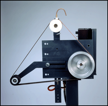

Just wait till you see the new grinder(s) we will have out soon:rolleyes: Cad is done. Probally start producing the prototype next month. 10 are already pre-sold. All I will say is you will never need to buy another attachment or another grinder.;)
1 - Angled Tool Rest instead of rotating flat platen
2 - Some kind of setup to run the smaller Bader wheels (1/2" to 1" diameter) - for slack belt grinding.
http://www.dozierknives.com/images/grinder4_small.gif
3 - Direct drive instead of pulley/belt system (can be an option...since having belt/pulley setup is less $$ than a VFD)
4 - Right-hand-side tensioner pulley tracking adjustment and better tension release (no need to have air-fed tension on the KMG)
The tension setup on the KMG is a weak spot that many have made their own adjustments/attachments/alterations to.
5 - lighter tooling arms. 2" square steel bars are too much.
6 - plug-n-play

But there's a reason I upgraded to a Dozier...yes it's an upgrade. To say the KMG does everything the Dozier does would be untrue. To say the Dozier does everything the KMG does and more is not untrue in any way.
I don't think the question is "Is there anything wrong with the KMG?".....but rather...."What could be done to make it even better?"
Why couldn't there be a "1st class" version of the KMG? (and still keep the budget version) *shrug*
I don't think even the most loyal of loyalists would assert that there's no room for improvement.

I cant think of a degree of movement that cant be obtained with the MAP Arm. If you already own a KMG, you can get a MAP Arm for $430 plus shipping. Thats a alot less than the $3500 for a Dozier.

I never had a chance to work with the MAP Arm...so I don't know. But I did use both a KMG and a Dozier for about 3 years before buying my Dozier...and when I looked at the MAP Arm...(which was very, very tempting)...I realized it would only solve a part of what I wanted for my "upgrade"...while the Dozier did it all.
KMG-CH = 605 (only need the chassis if you're getting the Caffrey platen)
Base plate = 115 (I included this since the Dozier comes with a stand)
14" wheel & tooling arm = 495
Small wheel attachment w/ tooling arm (not a fair comparison) = 163
2HP motor & drive = 814
MAP Arm = 430
Caffrey platen = 350
I get $2972 actually....*shrug*
I save $28....and I still don't have direct drive or a good slack-belt setup....and have to fab a better tensioner arm and tracking wheel.
I used my KMG for 4.5 years before getting the Dozier. I used BOTH a KMG and a Dozier for ~3 of those years. I have nothing against Rob or the KMG...it is what it is - and does it great. I'm supremely grateful for it...remember this? http://www.bladeforums.com/forums/showthread.php?t=281333 = ME.
I have just outgrown it, that's all. I wish I could have kept it, honestly. I would have been happy if it could have matched the Dozier. More crap to give Tom. :D

Why direct drive? Who's belt is slipping...why not tighten it? Direct drive goes against the original design philosophy in that it limits your options and versitility. An intergrated motor means that you no longer have speed choices unless you use a VS motor. It also limits you to a specific motor frame size..and somewhat to a specific speed range. With an integrated motor, the package space of the set-up is also dictated, where as a shaft drive allows you the versitility to mount the motor where you choose in order to optimize your shop space. One of the biggest reasons for a shaft drive is the enourmous costs savings potential for those that already have a motor laying around. If you want "direct drive"...you can still do that by coupling the motor to the KMG drive shaft. With a drive shaft, you have all of the choices and options of a machine with and integrated motor...plus more. Do you really want something less? Take a look at Dan's thread listed above. It exemplifies this concept.. It's an $875 variable speed KMG. This is the very core of the KMG concept.

Yes, the KMG work rest is very basic. It is more about liability than anything else. I don't think many here were around when Burr King was in litigation over a knifemaker's accident which took the machine off the market for a while...and introduced the "Hardcore". Anyway, a knifemaker sued BurrKing after his blade fell in between the work rest and belt. It was forcefully ejected and stabbed him. I heard of more than one old-timer tool and die maker that lost a thumb the same way on a bench grinder. Work rests can be hazardous. The hazards increase with the amount of adjustments and articulations which presents more oportunities for an accident. So, Beaumont Metal Works has elected to stay out of the specialized work rest business. We've made them...and given them away for evaluation, I use them daily...but we won't market and sell them. It has been our experience that this aspect of the machine becomes somewhat personalized and it is difficult to come up with a single design that works well for most. It is the most difficult, awkward and risky part of the grinder business. This would also limit your own imagination as to what you can do with the KMG.
On another note, back to the EC platen. That was basically a blatent copy of the Square wheel platen. Ed really wanted another Square Wheel..but didn't like the quality of the machines.....So we came up with a KMG that was "Wilton-ized" to meet his requirements. Yes, you can use a Square Wheel attachment on the KMG. It has a 3/4" stub shaft for mounting requiring the tool arm for the Rotary Platen.
