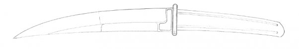

Hey guys... I've been sitting on this one for awhile. I was really excited about trying some new things... but translating them from my head to reality was trickier than I had planned. I made a few mistakes along the way, but ended up with a knife that I liked enough to see through to completion. Because of the problems, however, this is one that stays with me.
First the concept drawing.
Guess this would be a small O-Kissaki tanto.
And here's what I came up with.
Some Stats:
Length: 11"
Blade: 6-1/2" (tip to tsuba)
Steel: Differentially heat-treated ~3/16" W2 (from Don Hanson) Flat-Ground
Handle: WSSI Stabilized Thuya wrapped in epoxied paracord
"Tsuba"/Guard: W2
Habaki Panels: Copper
I learned some stuff on this knife that will definitely help me out on future projects.

Wow guys... all the positive feedback has me drawing the following conclusions:
  1. The design is a good one.
  2. My photo isn't clear enough to make out the problem areas. ;)
The main issues that I have with this knife do show up in the image... though maybe not clearly. Probably most bothersome is the fact that the swedge (on the side pictured) encroaches into the primary bevel. This was just carelessness on my part; poor grinder control combined with a 36-grit belt running mach 2. My plunges are atrocious... it's much easier to see in person (or in the RAW image from my camera zoomed in 10X). :eek: :D The angle of the "yokote" line is off slightly. Being a long o-kissaki, the yokote is 99.9% cosmetic; made by differing the polishing technique for that section of the blade. It's just off by 1-2degrees, but it is enough to disrupt the flow in my eyes. I'm also a little disappointed that the handle pin didn't end up hidden behind the wrap as I had planned. Visualizing a wrap a dozen steps ahead of time is an art I have yet to perfect.;)

Honestly, the swedge into the main bevel doesn't bother me in the least. It looks like a panned occurrence and creates an almost "barbed" look while maintaining an unbroken flowing profile. Honestly, I had to google what a yokote line was :D, but I see where you're referring to. As for the plunges, well, they look good from a distance :).
Remember that you're your own worst critic. And that's how it should be. If you weren't worried about your perceived flaws, then you're not striving for the best work you can do.
