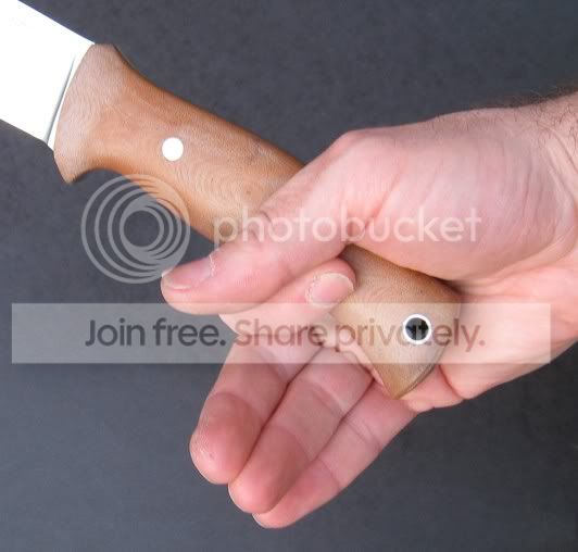

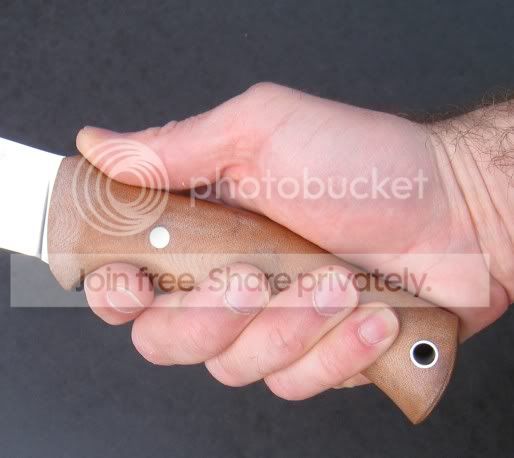

The rule of thumb that I use is for handles on this size knife to measure something between 4.25 and 4.75 inches between the start and finish of the wood. In your case, I reckon that the wood is starting too far from the blade and that comfort would be improved if you took the wood further towards the bevel. Short handles work when gripped like a hammer, but, in such a grip, for doing power cuts on wood and such material, the tendency is for the hand to ride forward. You get more power by having your hand closer to the cutting edge, and it looks like you will run out of handle.
Longer handles work when you hold the knife in a sabre grip.

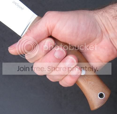

The handle shown was a bit big for me, maybe as much a 5", but I have smaller hands than the guy it was going to, and this is what I had pictures of uploaded.

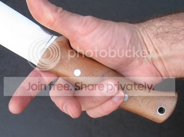

Those are not the only grips you want to think about. I have been told by great makers that they aim for a knife to be comfortable in any grip that is used, I am not so great, so I tend to be satisfied if it works in five or six.
Reverse grip for chest lever cutting.

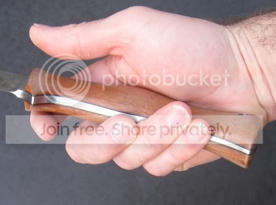

Side grip, good for skinning and food preparation.
And on knives with blades over 5 inches that have a bit of weight, a rear grip for performing snap-cuts can be useful.
A longer handle allows you to flare the butt, which is good for both hammer grip and rear grip, without the flare digging into you in hand in some of the other holds.
The other thing to bear in mind, is that the deepest part of your palm may not line up with your middle finger. If not, then you might want the widest/thickest part of the handle, when viewed from the spine, to be 1/4 inch nearer the butt than the deepest part, when viewed from the side. Parallel handles are easy to make, which is why they appear on factory knives so much, but your are making a custom, so go ahead and do some sculpting so it fits you like a glove.
