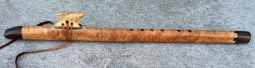

I find my own wood, cut it up on my bandsaw and then send it off to be stabilized. Works out to about $7 a handle for some very beautiful wood.
Two ways I find it. 1) Maple and alder that I find down in the woods. A few very beautiful curly pieces have come off my wood pile. I'm always looking for spalted wood, or burls on trees that have come down. I dry it and cut it up into pieces that are about 2.5x2.5x24. That way I can use them for native american flutes or knife handles. I cut them shorter if I am sending them off to be stabilized.
2) I get on craigslist and search "Burl." I have found a few burl clocks and tables for $10-50. Cut them up too. Just picked up this clock for $10. Its 3"x12"x20". I could get 6-8 flutes out of this plus 4 or 5 handle blanks. Or probably 15-20 handle blanks. If I bought 2x2x18 burl blanks like this for flute making I would pay $60 each for them from a pool cue blank supplier.
Here is a flute I made from one of my burl clock acquisitions too. Beautiful wood for handles too.
