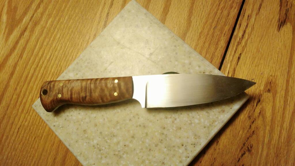

This came off my wood pile. Just a tip, if it's a pain in the butt to split, it may have nice figuring.

Sweet! Any other pointers? I have a big pile to look through so any direction would be great. Do I need to dry or treat the wood in any particular way?
I kind of lucked out in that I cut down this tree 5 years prior to my start of knife making. It was plenty dry. Look for pieces from the crotch areas. They tend to have interesting figure. Rule of thumb 1 year aging per inch of thickness. Paint the ends with oil based paint to keep the checking at bay, store it in a cool dry place and wait. 😁
