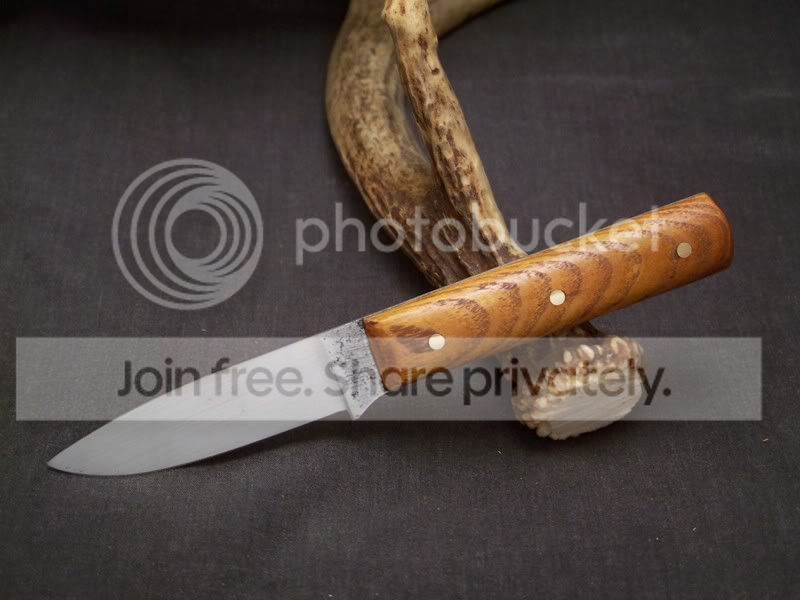

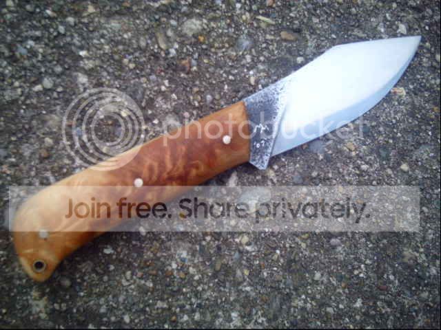

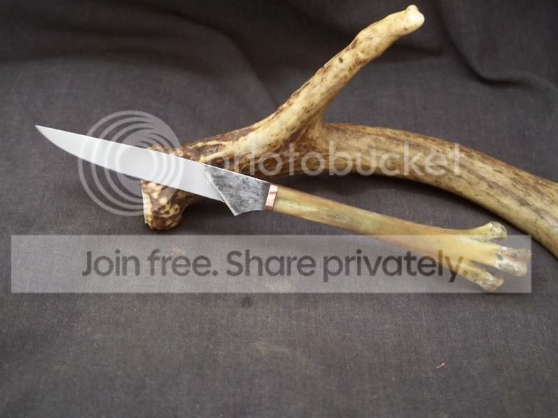

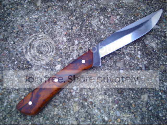

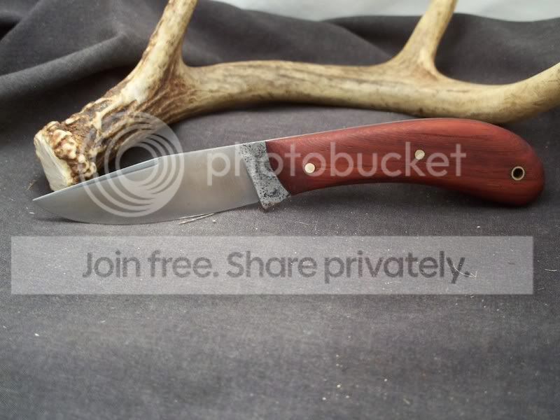

Like FB said, try to plan everything on paper, if you don't like the design once it's finished you man make minor modifications off paper. Here are some blades i've made (some i've sold) in no particular order.
I am a big fan of MM's work, and was lucky enough to win a raffle, so now I own one (6th one down I think). Man has skills. His grinds are PERFECT!
