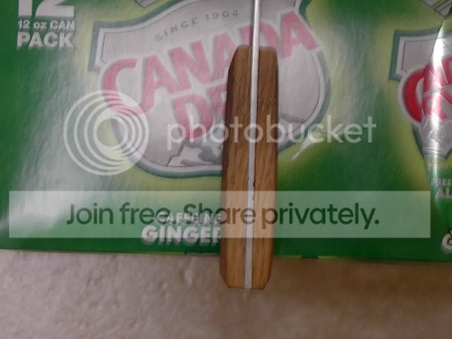

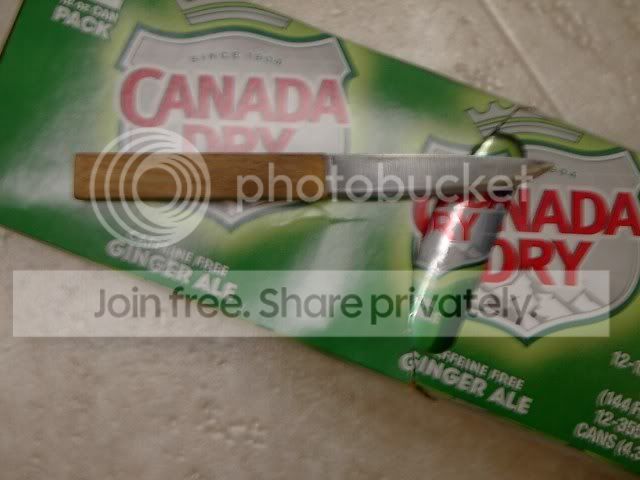

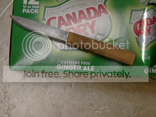

As Requested :)
this last pic has my hatchet and Opinel#10 as well , for a size comparison . The knife is just a section of all hard high speed power hacksaw blade , sharpened along the spine of the sawblade . I wasnt sure what I could and couldnt do with a knife when I made this one , so its very basic , it did get me hooked on flexible blades with a rockwell exceeding 60 tho , they are AWESOME blades, adictive :)
