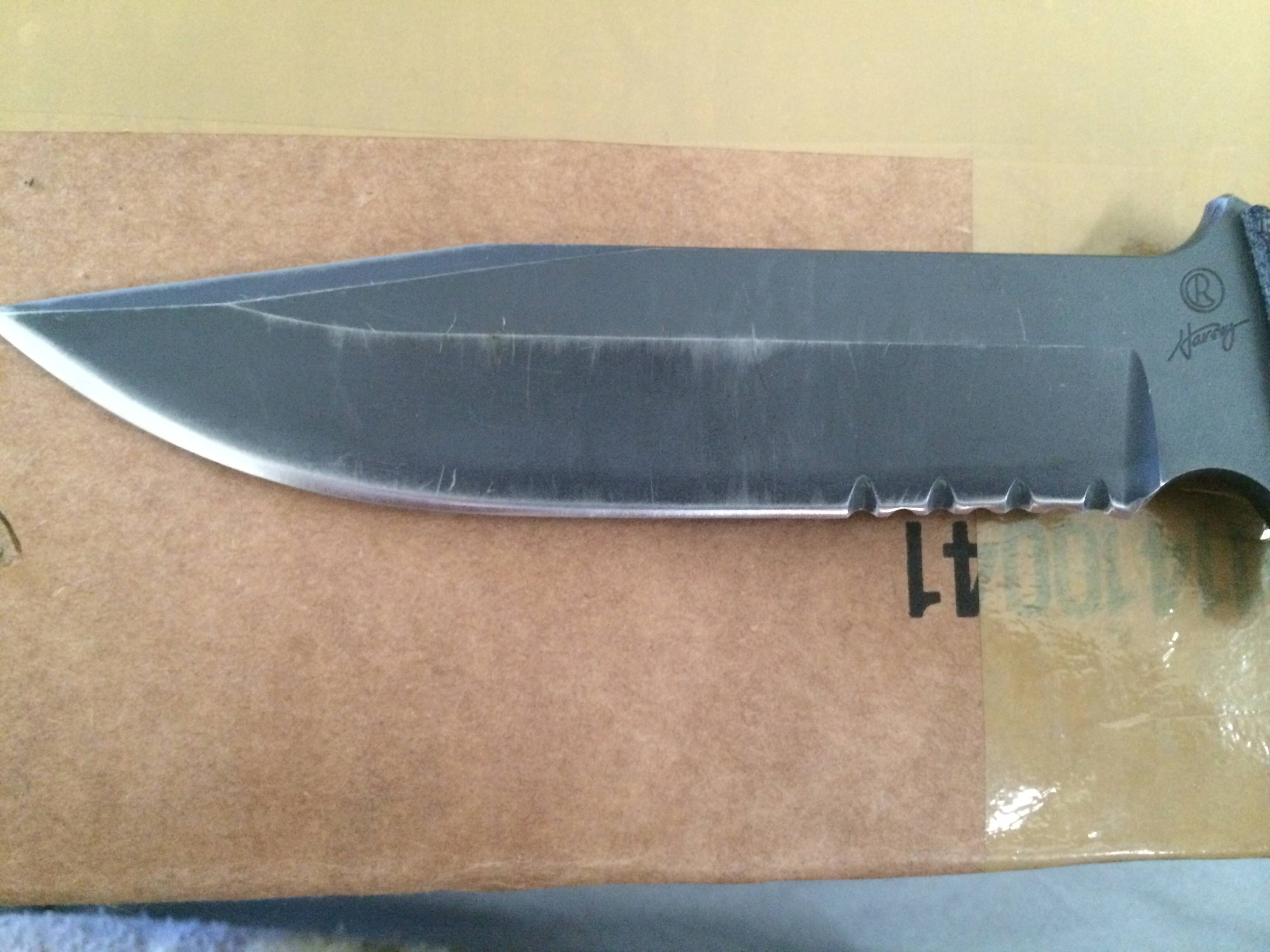

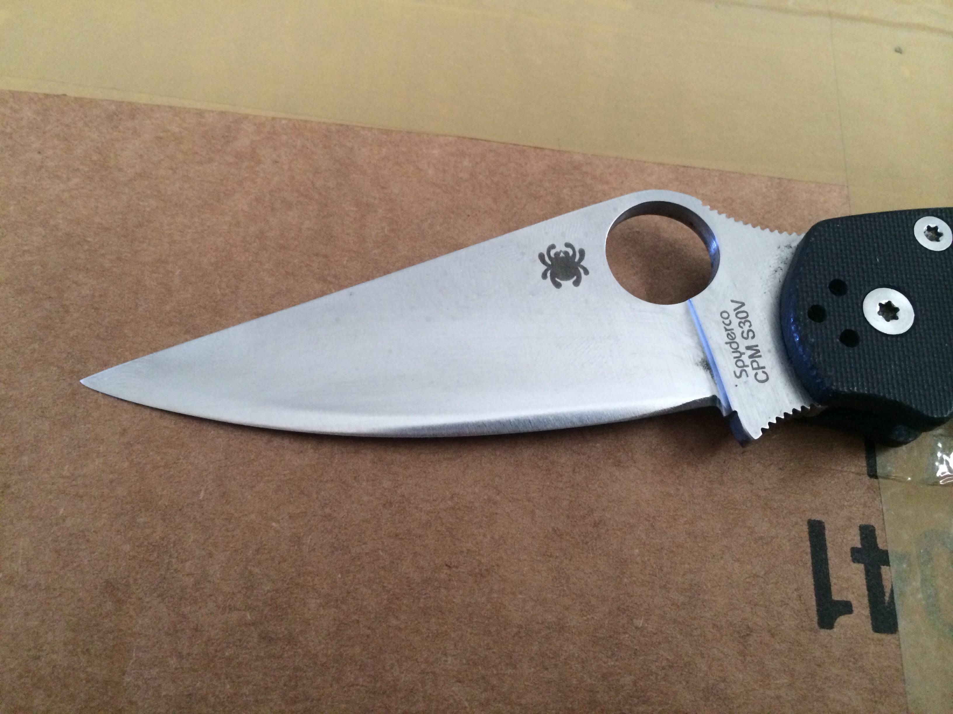

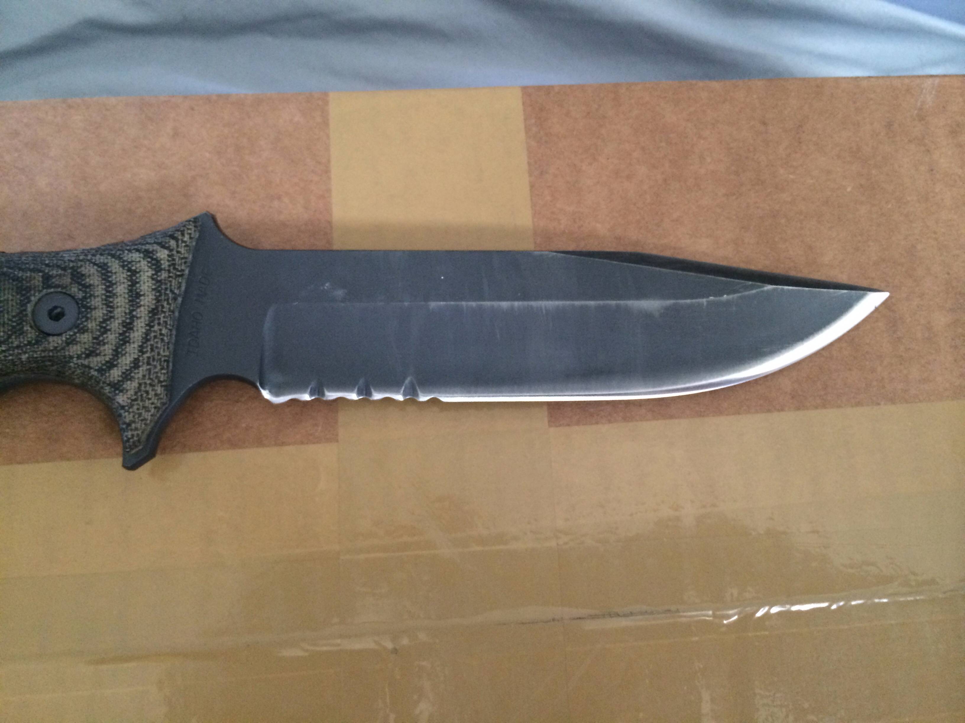

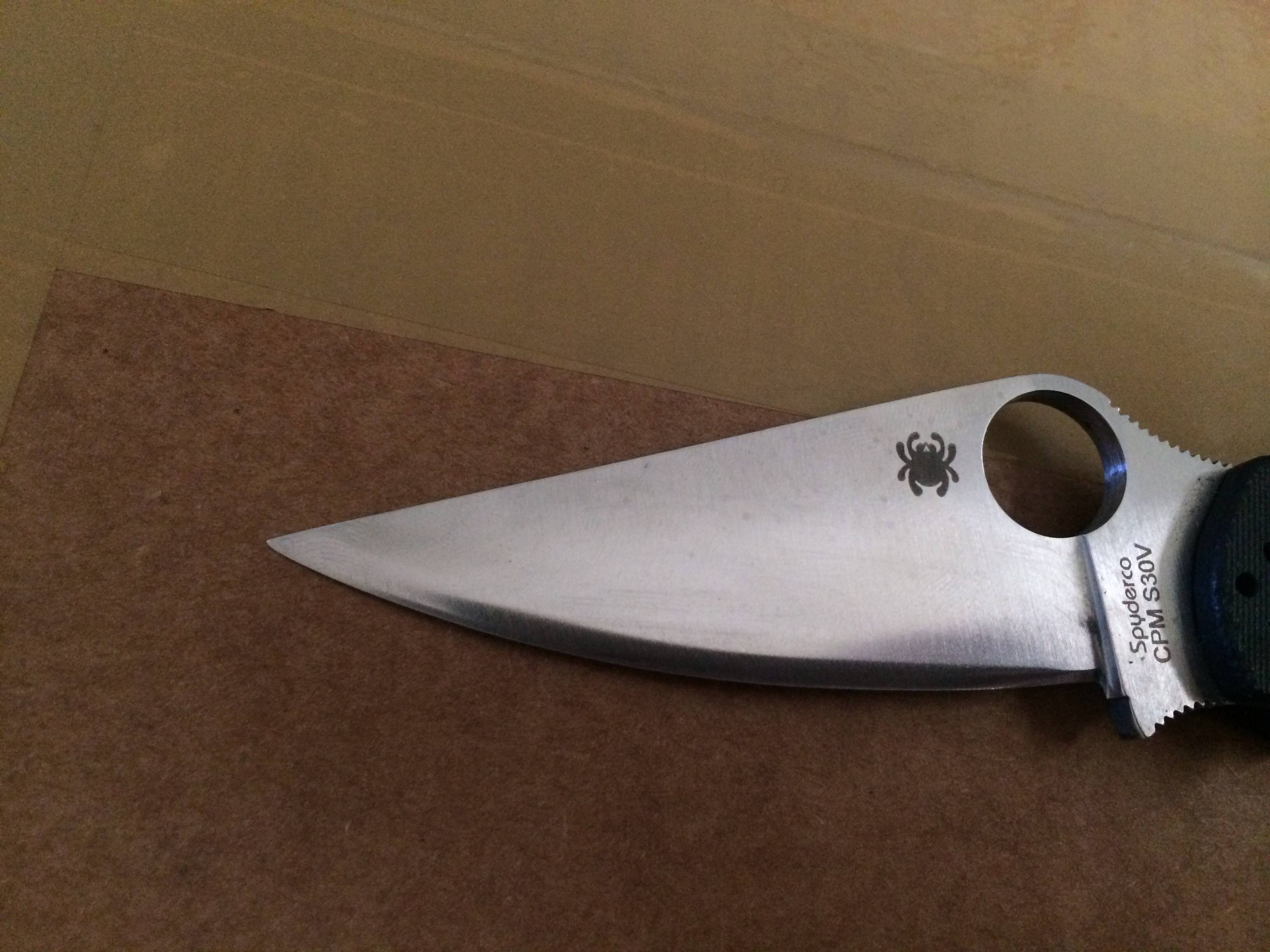

Today I received my knives back from a well reviewed mail-in sharpening service and I can't describe my disappointment. The bevels from both knives have been smoothed and turned into one long convex grind. To be fair, the PM2 is sharp enough to cleanly slice paper, but the CRK is hardly sharper than it was when I sent it in (it had an okay working edge, I wanted it out-of-the-box sharp). I know it's not the worst sharpening job to appear on the forums, but am I wrong in feeling majorly disappointed? Would it be wrong to ask for a refund? This cost me $27 BTW.

What a just strange sharpening job. Like they knew what they were doing but purposefully did it in a weird way.
I would be pretty choked with both of those sharpening jobs, the PM2 is convexed, but not the entire length (WTF?), and the CRK looks as though they didn't sharpen the serrations at all, just ran it over a buffing wheel and rounded off the teeth for ya.
Beauty. That's something I would do to my knifes 10 years ago when I didn't know a thing about sharpening....actually no, it's not, I would never leave a section of the blade untouched when sharpening.
I feel horrible for your CRK. I am really curious who in the world you sent these things to. Plenty of us guys do it as a hobby and can achieve a near professional edge. That is just pathetic.

Id be livid. Those knives weren't sharpened. They were completely altered. Even go so far as to say ruined. That PM2 especially. No good at all comes from an edge that thin on that blade.

Wow, Don't think I've ever seen a job botched that bad.The folder would have to be reground and the edge thinned out and then resharpened.The straight blade can be resharpened but the serrations would be a repair.Ask for a refund. No tell him he just bought them!
I see a lot of knives at the shop I work at, so I see all kinds of "sharpening." To me that looks like he used a work sharp on your knives. The grind is more pronounced on the CRK cuz its thicker, and it would also explain why the serrations look like that too. I would ask for a refund. Charging that much and sending them back that way is pretty bad. I *definitely* wouldn't send them back cuz that'll just be that much more metal youll be missing. Its apparent the guy doesn't know what he's doing. I'm starting my own sharpening service, and I would honestly be freaking out if I did that to a customer's knife - and I sharpen freehand. Correcting that is going to suck too because a bit of material will have to be removed again. The CRK can handle it, but that Spyderco is starting to get worn back a bit. I dont like leaving bad reviews, but I'd also hate to see this happen to someone else cuz no one ever says anything. I'd just post these pics on his review site and let people make up their own minds. If they know anything about knives, that will quickly make up their minds.
All that can be fixed, geometry and edge wise, but you can't put steel back into a blade - and it looks like he removed a lot of it especially judging from the heel of the edge on the pm2. Those serrations would need to be completely re-ground/profiled into the blade to make them pointy and sharp again - it looks like he took a power buffer cloth wheel to it of something.. very *interesting*.
All that being said, what condition were they in when you sent them to him? had they ever been sharpened before and if so, on what? Just trying to get an idea if most of that was his damage or somewhat existing.

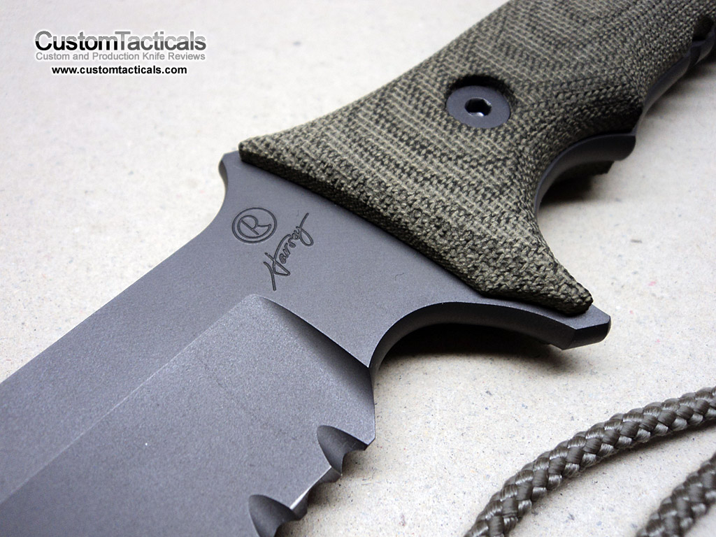

edit: i just saw where you said they were sent to him w/ factory grinds. And I just looked the CRK up... looks like that actually is how they sharpen them at the factory, so other than being dull i don't see too much of an issue w/ this one other than that a lot of steel looks to have been removed, but it is the PM2 that looks butchered. The CRK probably just needs to be sharpened/fixed up. I would ask for a replacement on the PM2. And I would not mention his name until you contact him to see if he makes it right... common courtesy =) Lord knows we've all messed up blades before but good customer service can make a big difference.
