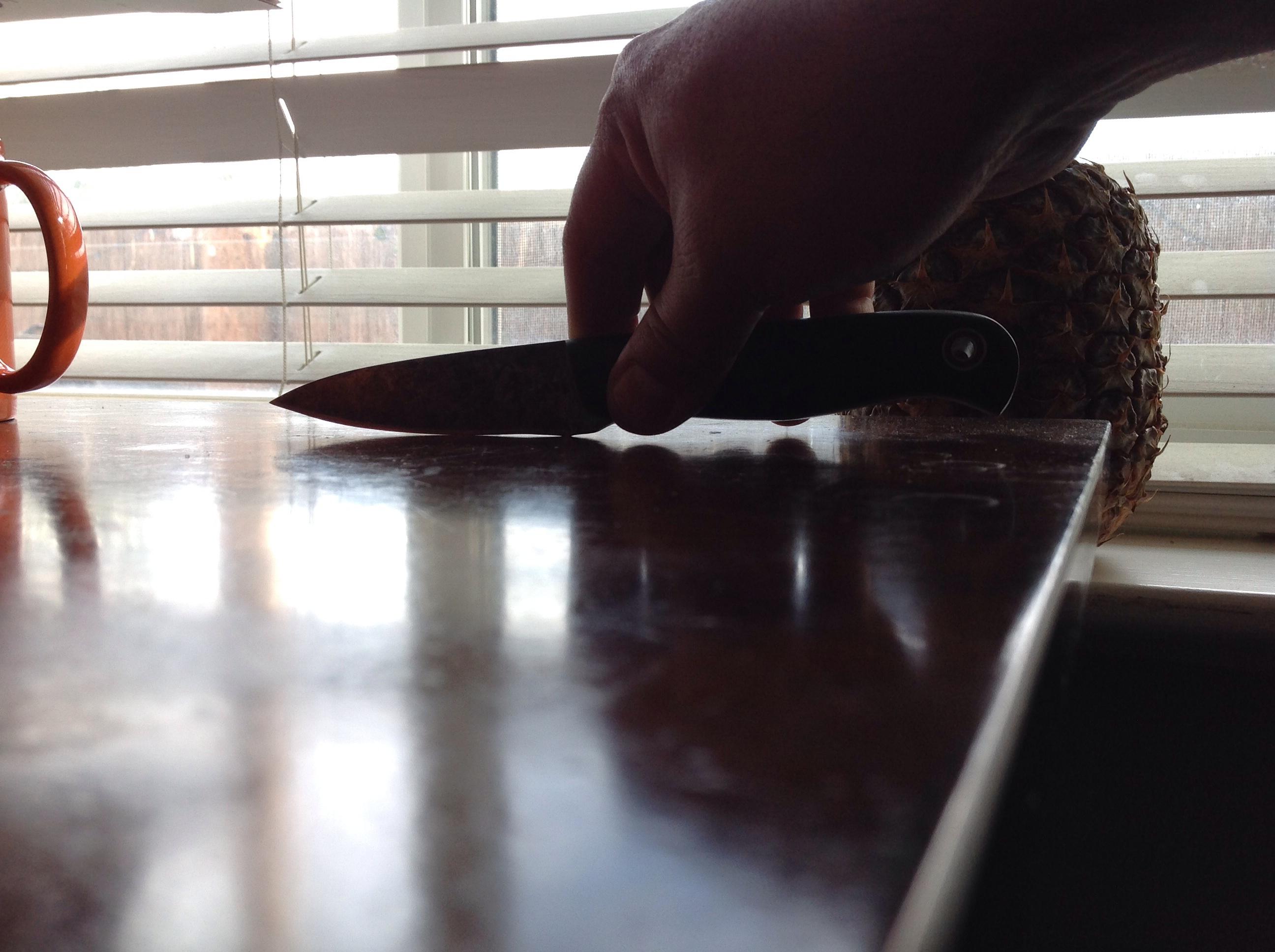

LOL, you have to get the right kind of light, and it is darn cold outside here. Send me any knife you got Josaiah, and I will put a spit polish on it for you. Regarding pictures of a polished edge, I'll see what I can come up with in the short term. In fact, I could get a cell phone pic below.
FWIW, I find that having a little tooth on a knife edge is not necessarily a bad thing in the functionality department. Especially for food prep work. For wood working, a little polish with some remaining tooth is what I tend to prefer.
My new favorite EDC knife, the Lone Star
Edge is 16 dps with 18 and 17 dps micro bevels, stropped to form a convex edge.

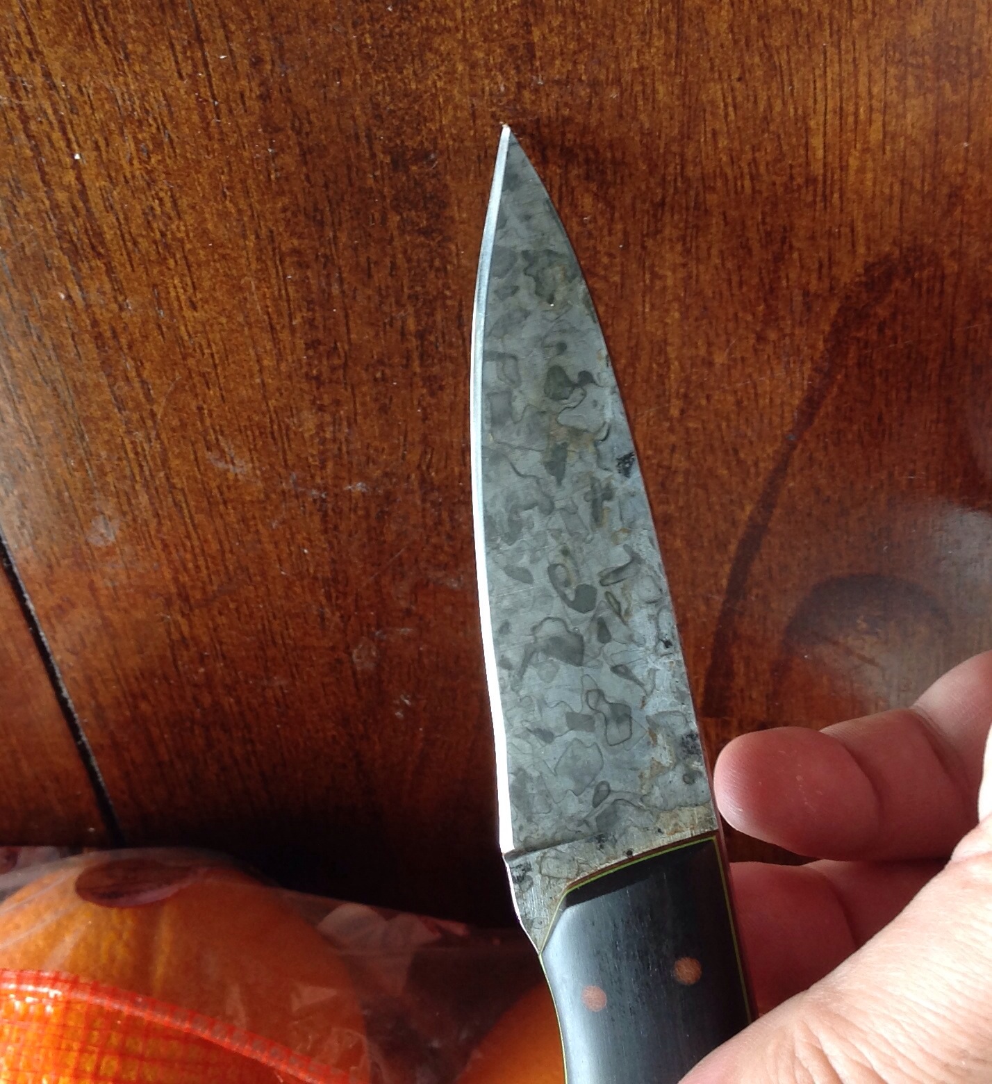

:eek::eek::eek::eek:Well I completely funked my ship up!!!!!:eek::eek::eek::eek:
I went out to the tool shop to use my Lnasky to prove it is a good system and forgot one little, very important detail- tighten all the screws and bolts of the system before using!!! This blade is probably the sharpest I've ever sharpened a knife; I was whittling hair, but I really messed this beauty up. Walter do you see my SOS beacon.
My poor Bushie... Where's the whiskey?
Notice the recurve near the top and near the guard?!?!
Yup.... I'm that guy. I'm gonna delete my BF account now. Farewell y'all.

If you don't/can't send it in to the shop and don't care about implied warranty, please send it to me and I will fix it. Granted, it will be a bit slimmer, but I should be able to get the general profile back to a KEB-like shape with some patient filing and shaping of the entire edge. I'll post an example in a sec.
Dylan's been working on some recurves lately. Just call this a Fiddleback/Fletcher collaboration.
I did a similar fix on a few knives for a friend who went WSKO crazy -- recurved all of his blades. The process takes a while, filing by hand, but the results are pretty good. If you are comfortable doing the work, it is pretty straight forward; tape everything up except the edge, mark with a sharpee, and begin stock removal with a medium grit file along the edge. Granted you will need to create a new edge, geometry might be a little different and the HT steel will be hard on your files, but your knife will (somewhat) be back to normal ;)
I'd say that most of your work will be ~1/16" of steel; the majority of the work will be near the tip and the finger guard.

WRT Duder's problem (or clever regrind), I would actually propose taking a file perpendicular to the edge (on-top) to re-profile very gingerly. Once the general shape is obtained, then re-apply an entirely new (convex) edge
In the straight razor world they call this bread knifing in order to eliminate frowns or extreme smiles, especially on vintage blades where improper honing over years has occured. Once acheived then re-set the bevel. This could be done on a DMT or any other abrasive stone as well. In the case of a knife though, the thicker blade might warrant a file as the best approach.
