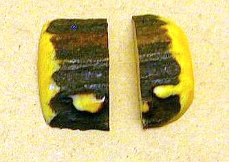

I've been doing some experimenting with stag and was able to drive some color into this. It takes some patience and a combination of pressurizing for a time and just plain soaking.
I did this piece in 2 days...pressure over night and then soaking in the same dye for 24 hours. This was just leather dye combination of a couple of colors to make a amber-ish yellow. I cut this piece in half AFTER I dyed it and the color goes through to the center. Stag is all different and some pieces take dye better than others. This piece was paper white before dyeing.
