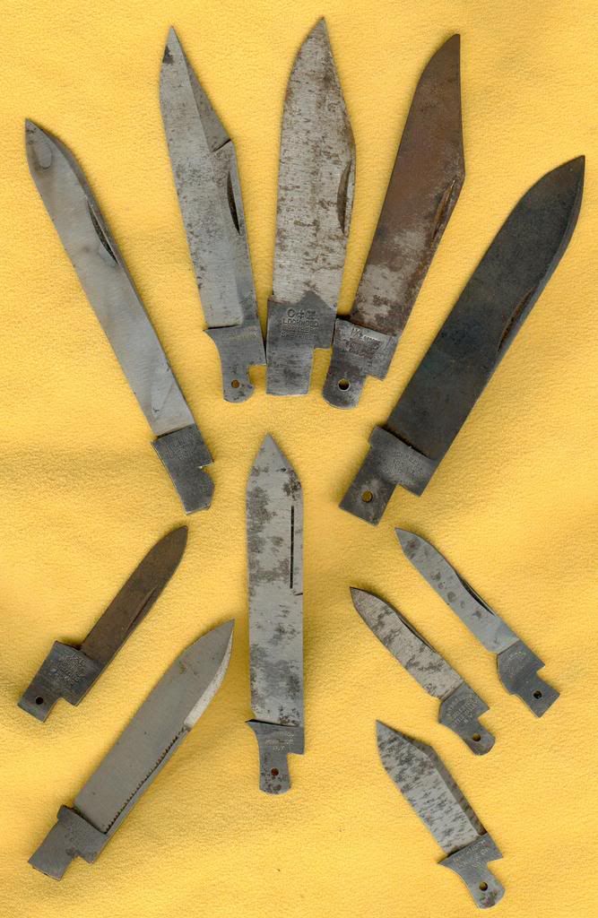

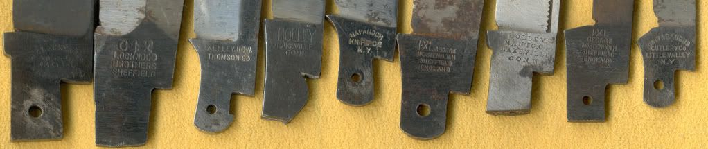

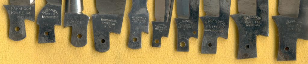

A knife is essentially a blade to do work, and here are some old blades, some unfinished, but none ever used, so they reveal unspoiled visions from the past. They show how ancestor knifemakers viewed a successful blade! Note the stamps; Holley, Cattaraugus, Naponoch, IXL!
Can you see what knives the blades are intended for? Can you envision the shape of handle ideal to hold any given blade? Powerful knowledge is concealed in this rusty old pile of metal! It takes some vision to suss it out!
Here's a separate post of the tangs, as the don't show up in the first post;

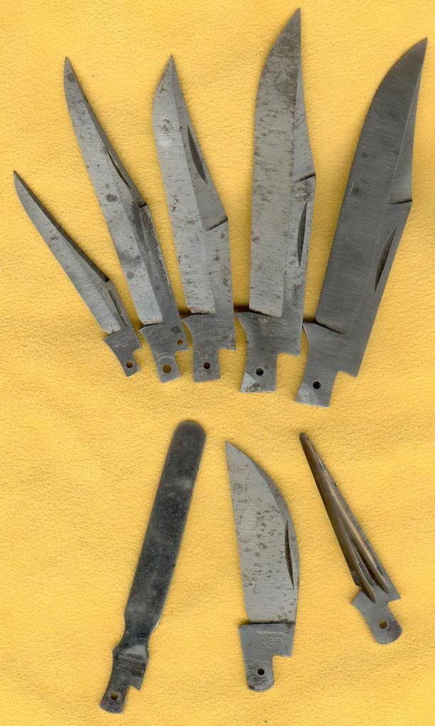

Extraordinary pile of metal you have their, waynorth. I particularly like the very bottom scan at the top of the photo where the larger blades are set up fanned out. I had some very old Case large Jacks with those. I think they may be called Clip~Saber blades but I may be wrong.

Thanks waynorth, that certainly is an education for me. I never realized just how much geometry is involved in the fitting of a blade. I now understand just how a half stop works in relation to the spring. Great stuff..
Dave
A lot of very cool knife history and technique in those blades. I like the swedges on the bigger blades too.

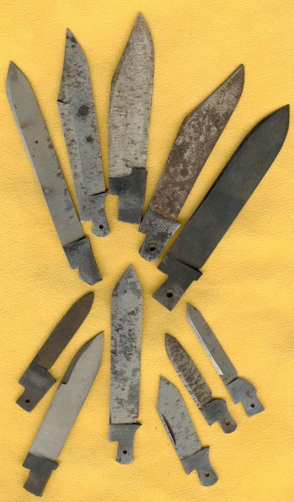

Upon reviewing those scans, I found them less than "inspirational"! This is what separates the hacks with a scanner, like me, from the talents, like Kerry, with their cameras! To help out, I took some more at different angles, and these show the grinds and swedges much better I think.
With apologies, here they are;
Nicely done, Charlie. Thanks for your time and effort on this labor of love.

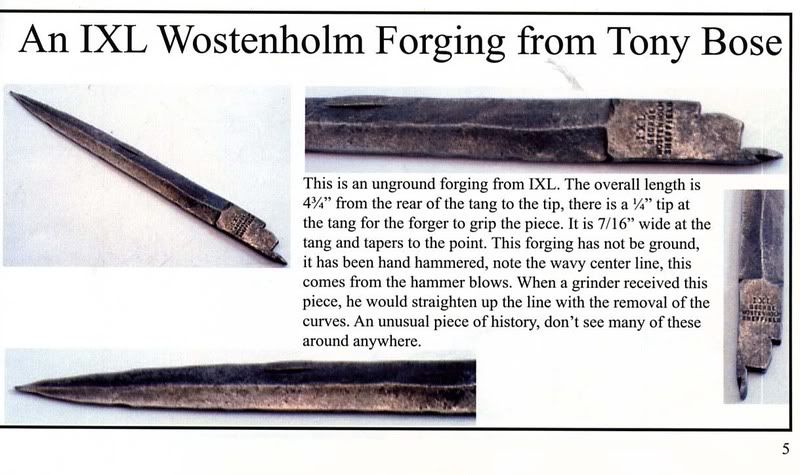

This was in a bowie collector newsletter. The unfinished blade must have had quite the trip over to the United State before ending up in Tony's hands.
Anyone who thinks they are good with a hammer and forge should try one of these. It would be a good heat check as they say in bassaba.
The forging belongs to a friend of mine. I was with him when he bought it in Louisville over 20 years ago. He lets me keep it here so I can CF and CE it.
