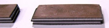

This was a PITA as well. G/flex left overnight for curing. G10 liner slipped and cured out of place.
Bob,
I drill and pin each spacer onto the guard-side face of the handle scale with 2 different 1/16" diameter pins to prevent their movement during glue-up or forever after. It takes quite a bit of extra work to get things flat and squared.
There's a lot of photos and steps left out, but I glue spacers together using CA, attach them to the scale with CA, mark, drill, pin, and then square them up.
Mike L.
Mike, i was gonna ask you how you did that. Thanks a lot.
