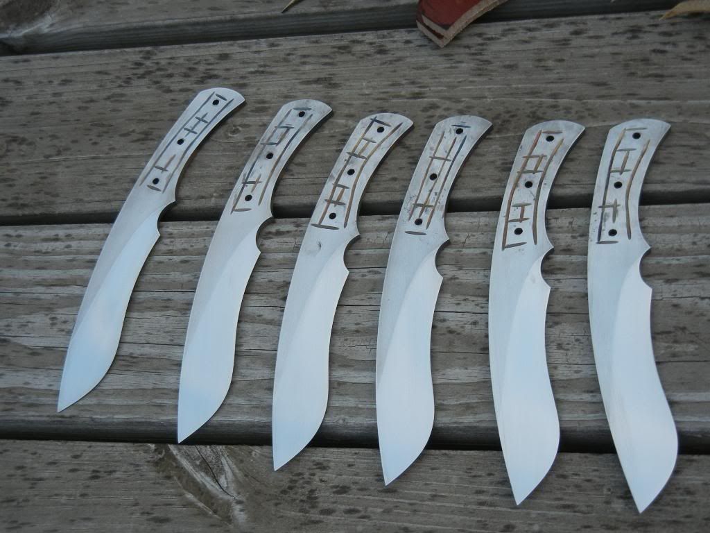

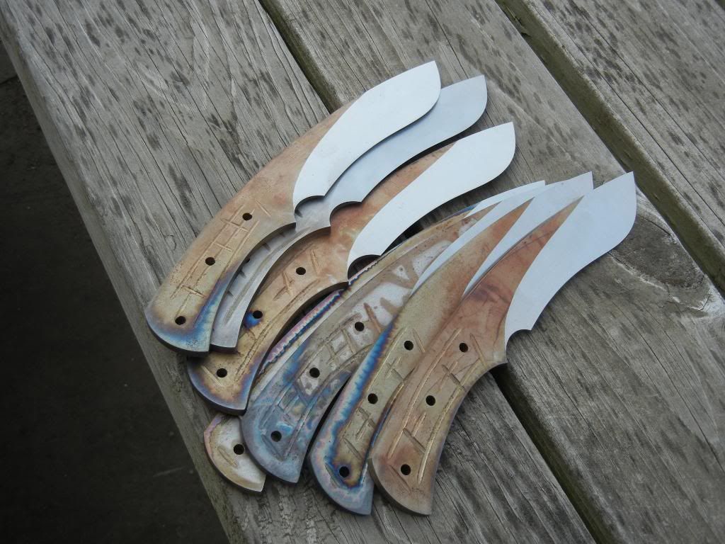

Phillip got me the first set of blades heat treated and ground.
Damn, he does nice work. There's definitely a world of difference between a hack like me and an artist like him.

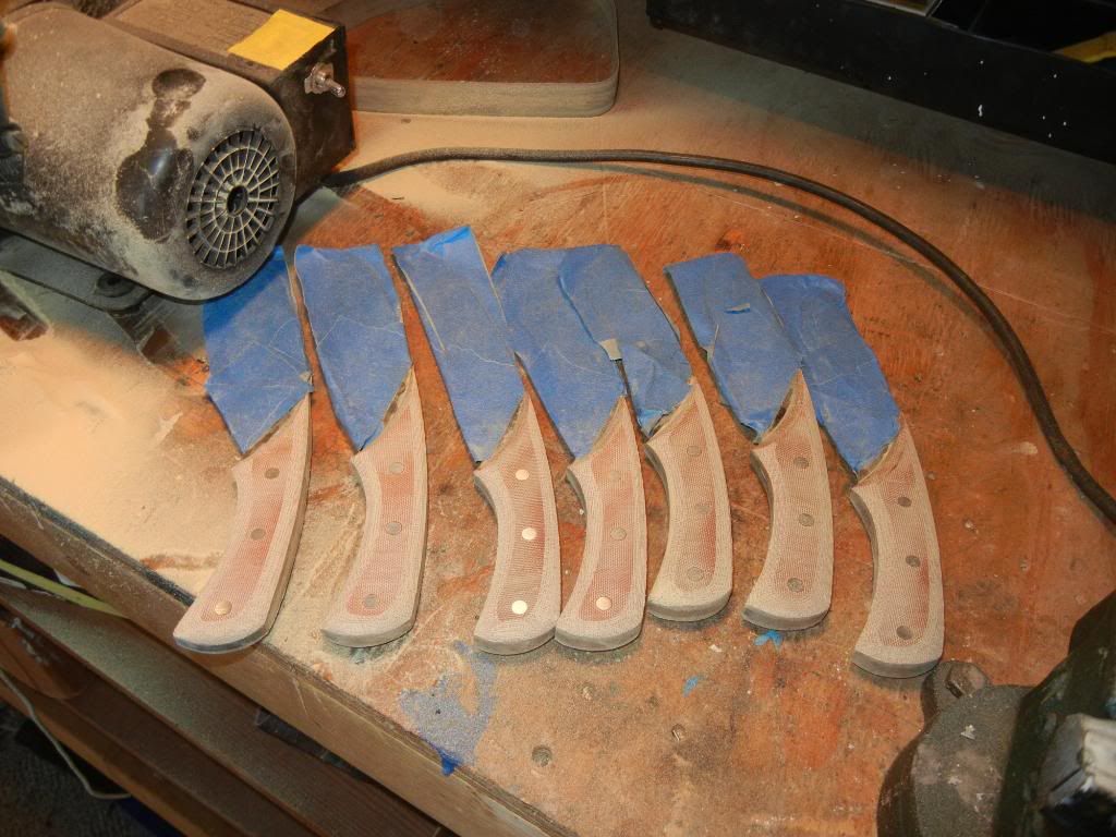

Cut out the first group of scales:
And it's time to sit down with a bunch of 400 & 1000 grit paper.
Oh, and some supplies to help it go faster :cool::
And we're ready for some final polishing before the scales get attached:

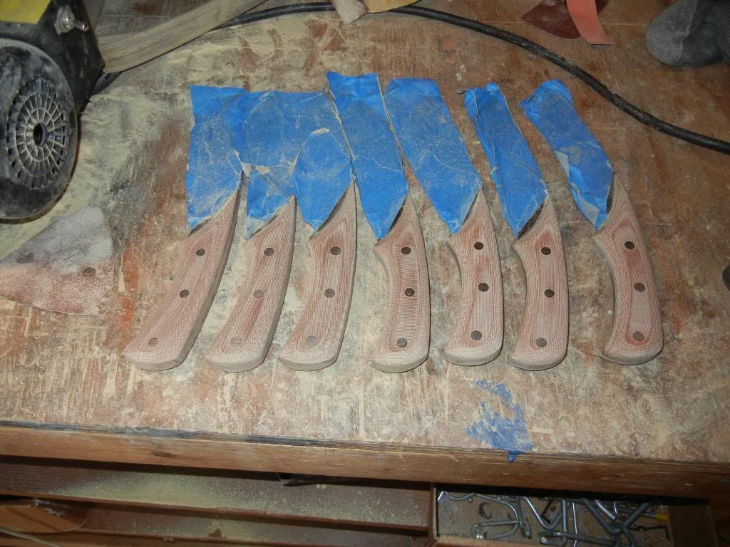

First set of blades with the scales epoxied and corbys installed:
Corbys ground down:

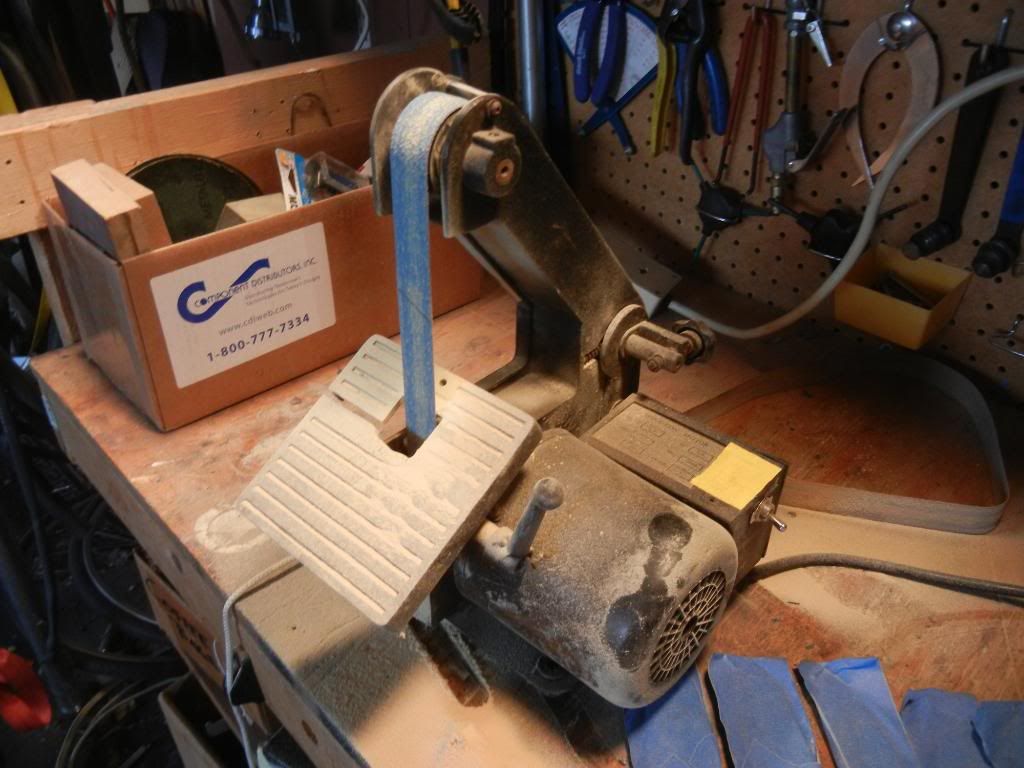

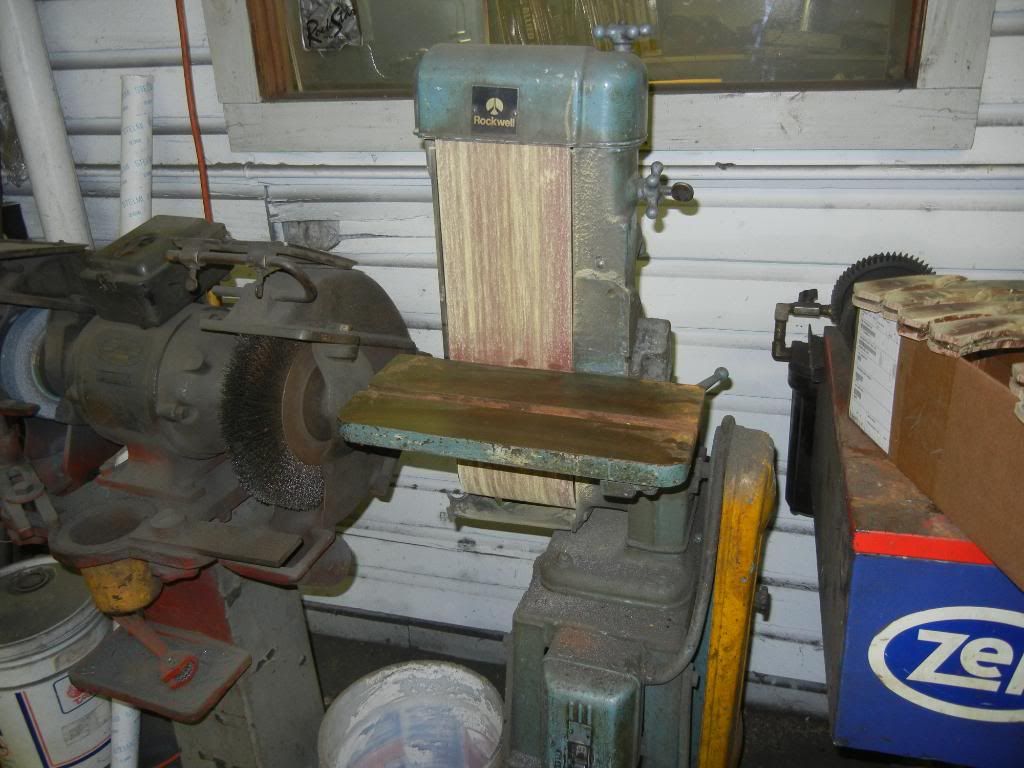

Tools of the trade
-Home built 2x48:
-Old time badass 6x36:
-Baby 1x24 for light stuff:
And then lots of old fashioned, finger numbing, hand sanding.
Almost there:
