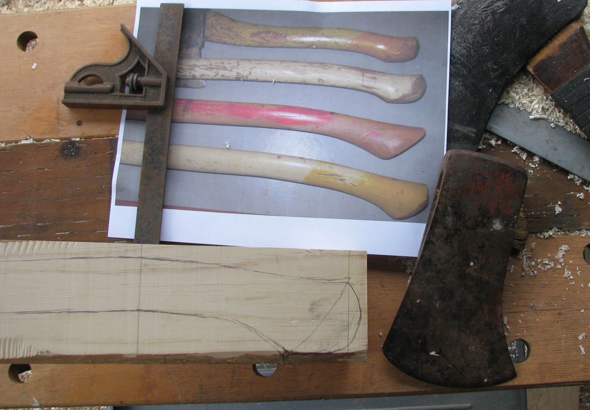

When my rough handles arrive, this is the first thing I'm gonna make if I can. I contacted HH to tell them to leave the wood on the bottom if I wasn't too late to ask for it.

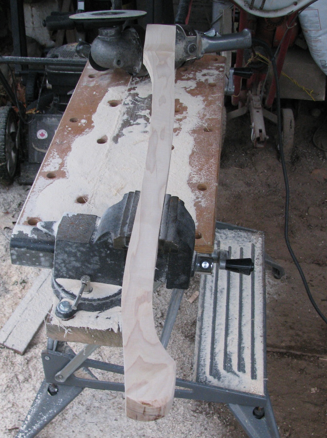

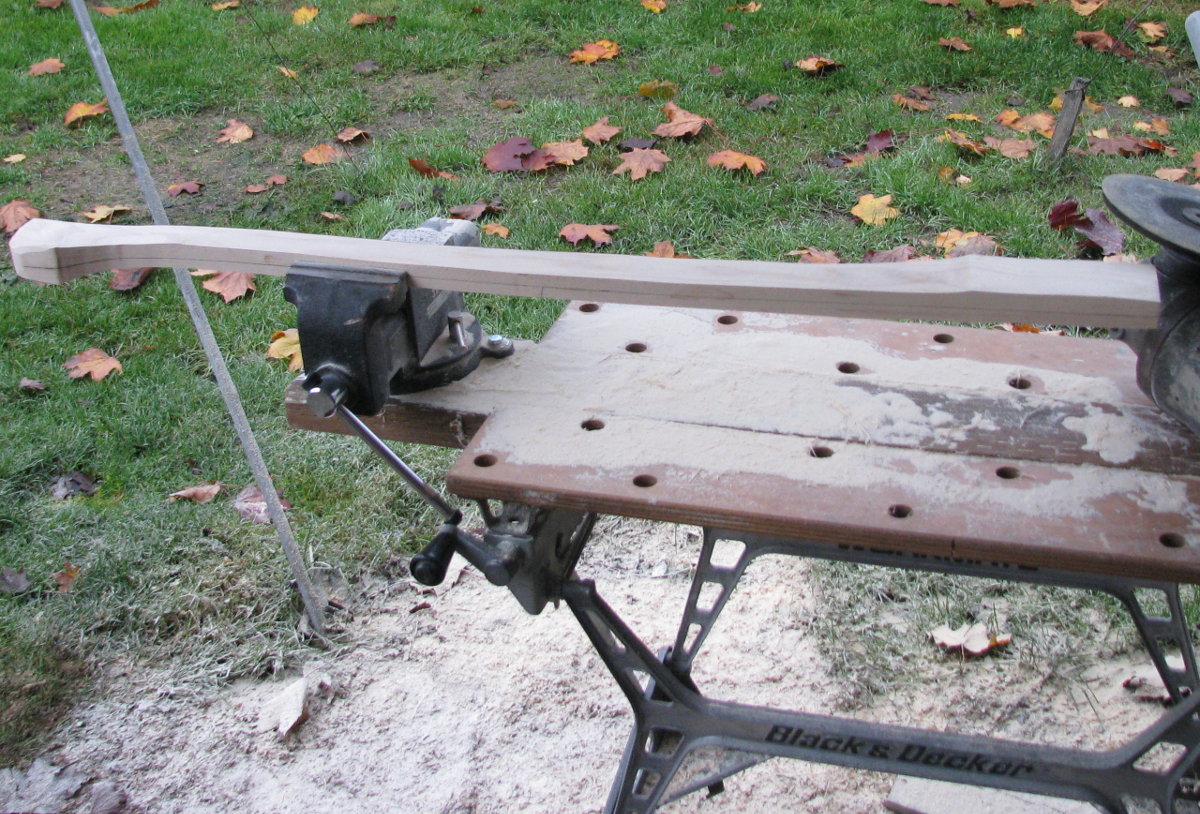

Here's a knob end handle I'm working on. It's for a light full size Walters. I'm making it from a hickory stave that Quinton gave me. The stave can only be described as perfect. Straight grained white hickory, air dried, optimal grain alignment, ~11 growth rings per inch with a predominance of late wood vs. early wood.
At this point I consider it a handle blank. When I'm finished I'll start a thread and show my process.
Looking good, Square_peg!
