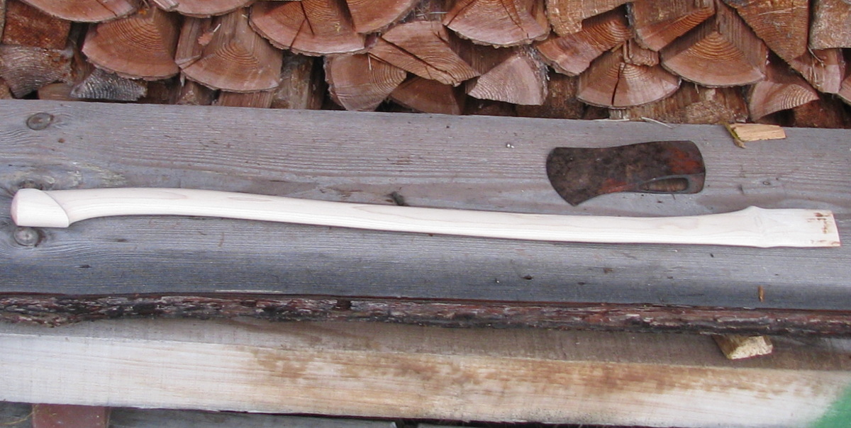

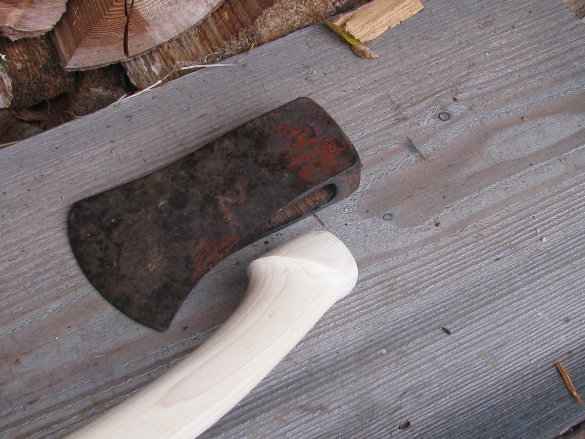

The handle is shaped and sanded. Now it just needs some some BLO and other finishes before I hang the axe. It's long and slim and feels terrific in the hand. Most of the haft is 3/4" x 1-7/16", much thinner than current store bought hafts. I expected it to be fast, flexible and whippy. Should make a great trail/underbucking axe.
I'm debating whether to leave this with a clear finish or to paint it traditional Walters knob-end colors. I might do some of each, paint the knob and axe head Walters colors and leaving the rest of the haft with a clear BLO & tung finish. What do you guys think? What would you do?
Painting the head and the knob would be cool,excited to see it.Would you prime it first or cold gal or just sand it and spray it?
Great looking, made from quality wood, slimmed, and the swoop/rise into the swell looks awesome.
The shoulder into the back looks like you can get your grip right under the head.
Painting would be interesting to see. I’ve never done. What about taping it off like you were going to paint it but stain the end instead?
Im sure your usual mix would look just as classy.
un-intended product features make things better. like a leaf blower thats really just me goofing around with a chainsaw
I am sure that Best Made Company people would make this handle a marketing hit(no additional paint needed :). Family Heirloom!!! " this is the oldest tool.... actually, the oldest art form know to mankind. It has to be embedded in our DNA..... capsule of stored energy ,,, you put it in somebody's hand and they feel empowered
Prime and paint. I would mask off the bit in a traditional Walters pattern. I think I could paint over fully cured and lightly sanded BLO. So the whole haft will get a few coats of BLO.

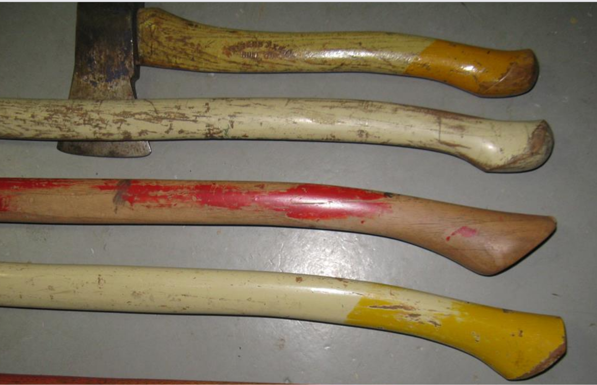

This is a hybrid knob end based on this old handle I have....
....and this handle that 300Six posted.
