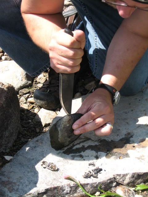

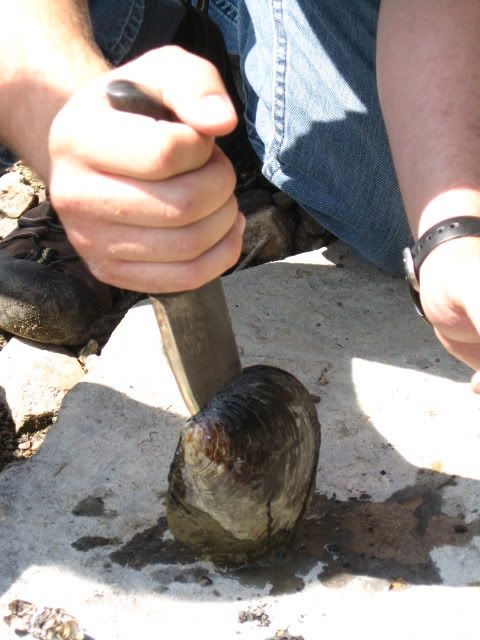

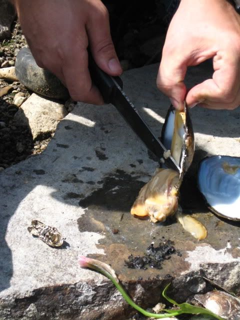

I left the Cray as we were not actually eating out there but wanted to show Ananda the insides of the clam so back to rookie action (with proper safety):
Continued:

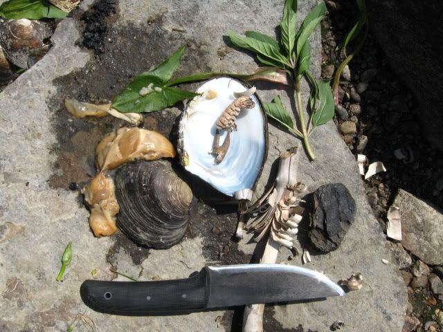

Ok, we have meat (clam and hypothetical crayfish), and add some veggies (Arrowroot and natural mint) and look what we have here:
Made the fuzz stick, and adding the coal lying on the ground and we have a sure fire (but did not actually get it made). We have been coming here for a number of years now and just found the crayfish, they are not even supposed to be in this area. From now on I'll probably add the foot of nylons to a survival kit as I cannot bend over well enough yet to be able to catch them well so being able to make a net would help, and would have been able to add the multitudes of small fish to the meal with the net as well. A nice meal caught within a 20' radius without looking too hard, not bad. Did not feel too bad about killing the clam as we left him as an offering to the crow that was informing us constantly that it was his river, got to keep the host happy after all!:D

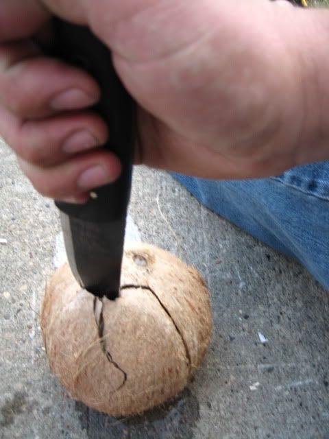

Got this primarily to test out, it was a good excuse as I really like cooking with them but Juli does not care for 'em, but it is for the review!!:p

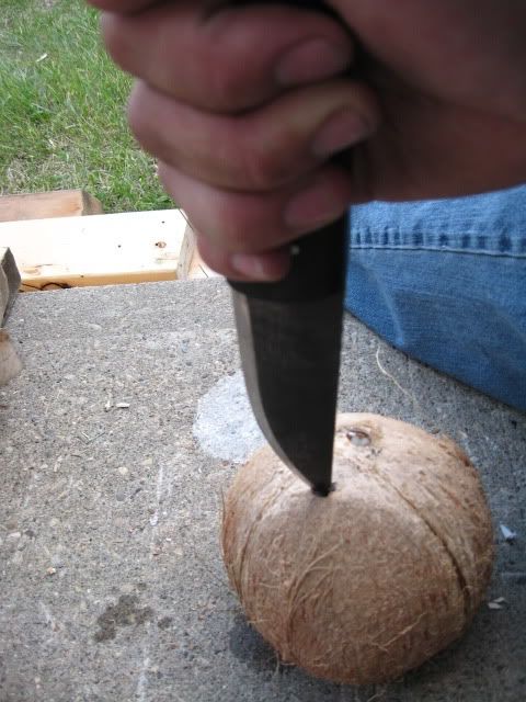

Now for the stuff I normally don't do but seems like it is testing necessity, plus I just took down mu wheelchair ramp (guess I'm not enough of a cripple any more, says SWMBO):

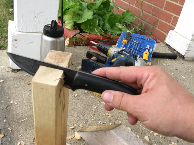

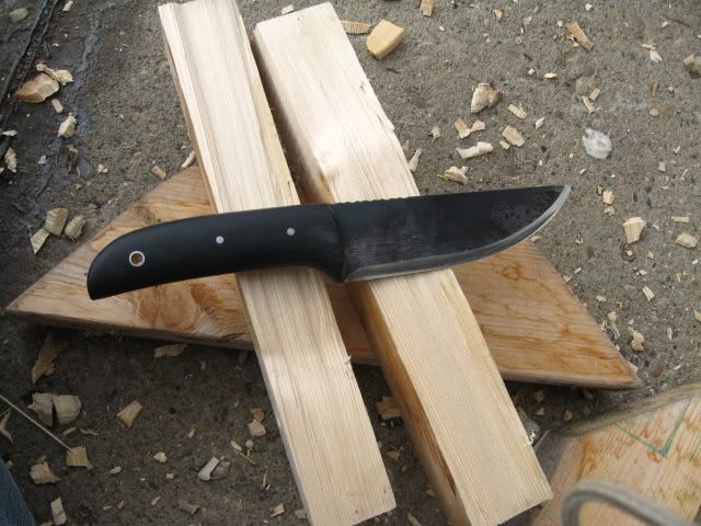

2.5 min of chopping gave this, not bad as I was seated and they were not full power, more rapid fire persistence:

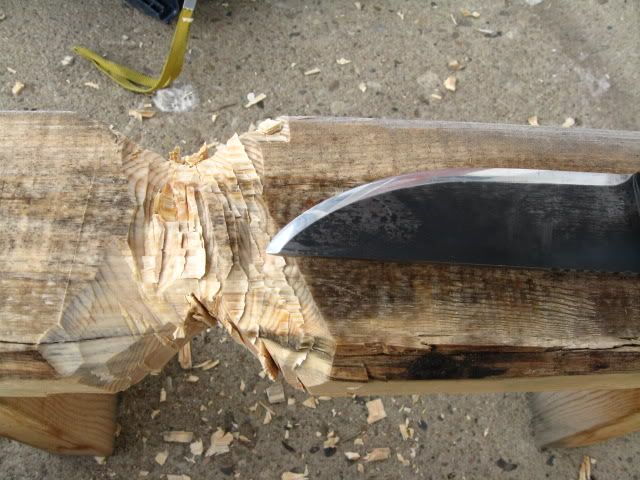

Batonning to make a baton:
first hit
Second hit:
Yes, it was started in an existing crack but why work hard instead of smart?
Batonning a v-notch cross grain with a light baton. I guess I had to work hard a bit:
On to the actual review now.

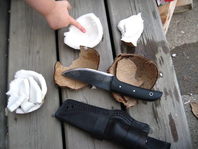

I am really impressed with how it worked. The thin blade is not at all frail, despite what some think (I told you guys I like the 3/32 though). The handle was very comfortable throughout, and when chopping the sloped pommel had better retention than I thought. The convex grind required that I hold the blade at a higher angle than I am used to, but that is where one has to use a tool to learn it first. My curls were not too curly, but were adequate. I did not hit the pommel when breaking open the coconut or clam, instead hitting them on the ground to transfer force, which worked very well. The edge was not indestructible, and there were a few small rolled edges after the bush, but that is operator error (on purpose) digging in the ground and dealing with hard shells. I was amazed at how easily I was able to return most of them with a ceramic Sharpmaker stone and home made strop stick. The home experiments dulled the edge, but would have been more than adequate for survival- it was still sharper than any knife I have EVER seen an Inuit use in my time in the arctic.
I see this knife as a stand by itself travel knife or combined with an axe/chopper in purpose. I usually would carry something with a thinner grind as some tasks seemed a bit harder to control than what I am used to. The edge held up respectfully and returned from bush condition much better than I expected due to my inexperience with the convex grinds. I still have some work to do on the tip to get it sharp to my liking, hopefully I'll get the entire edge to hair shaving- which is my standard.
A couple of changes that I would like if it were mine:
The jimping on the spine was a bit rough for my thumb when bearing down on cuts, more shallow or a bit more radius to them should help (similar to rounding the edges when doing an undulating/serpentine filework after initial scallops are cut- if that makes any sense). The top/front of the handle scales are a bit angular and could use being hit with sandpaper a bit to remove the angularity of an already smooth, flowing knife.

Great review Kris. Never thought of cutting coconuts like that. I'm going to try that one myself I think! Beware the river clams, they will harbour e-coli for up to 96 hr so unless they are cooked right and proper, you can get a bug from them. Still, lots of meat in those clams. After cooking that will satisfy a hungry stomach for sure. Also interesting about the crayfish invaders. Maybe you can capture some and post a thread with pictures to W&SS and we can identify them!

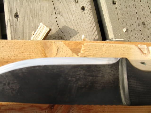

I've already switched my filework out- that was done in a 1/8 round and I had the same "sharpness" issue with a few of the early PSK knives. I've switched out to a 3/16 diameter filing and it's helped a lot. I also run a strip of 800 grit over the edges quickly now.
I have a hard time knowin what to say about the edge- I always prefer a roll to a chip if it's gonna happen but I'm not sure whether or not it should happen opening clams and coconuts and banging around like that. I'd rather have it be fixable than chipped, though. Heck, I throw enough of them into stumps in testing.
I'm glad to see the edge maintained for you with a strop and a little ceramic help. that's about the limit of my kit and I strive on the hunters especially to have them be maintainable just with a loaded strop.
I'll think on the scales. I have a fair number of variations on how I do the fronts of the handles, but I think that one might be in the "full width to the edge" category. a 1/4 inch radius would probably be enough to fix that?
I'm sure that the dings came from digging the arrowroot out of the gravel bed so I would not worry too much about it, I knew beforehand that it would probably happen, and they worked out very well.

Okay, banging in gravel is definitely a pretty reasonable "edge abuse" test- and fixable rolling sure beats chipping.
