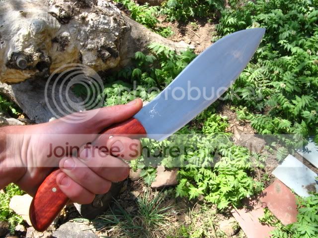

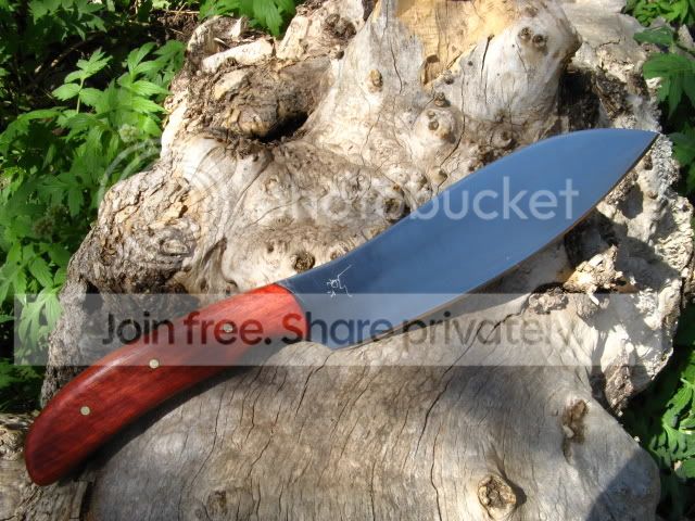

I have had this blade waiting for a handle for about 4 months now.
After seeing the first one David made in this thread I had to have one.
http://www.ramanon.com/forum/showthread.php?t=53155

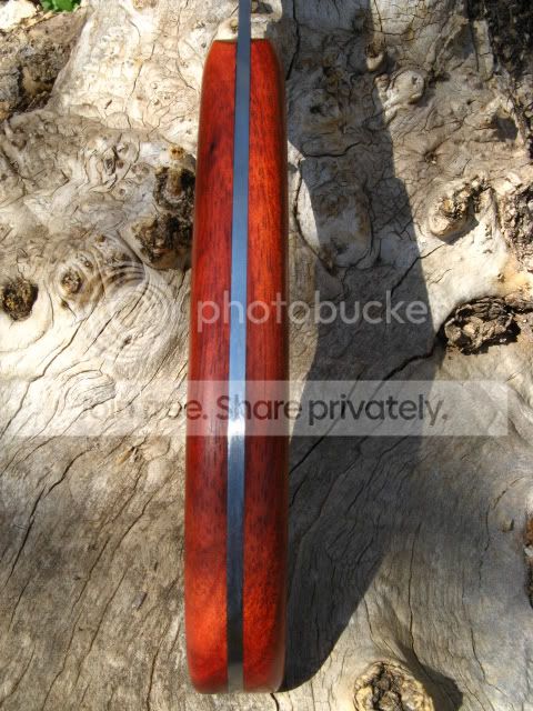

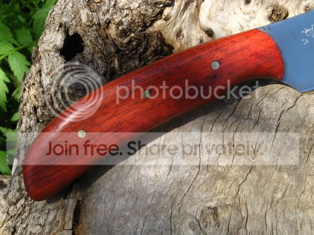

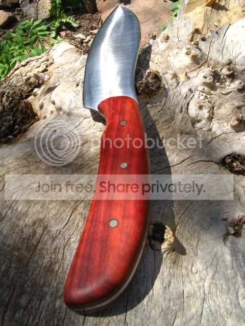

I modified the handle shape slightly to better fit my hand.

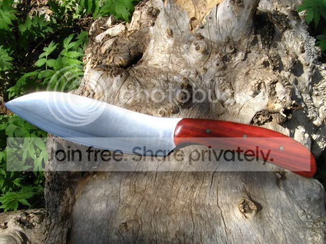

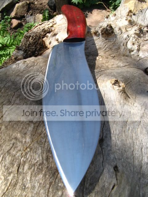

The blade is 1/8" thick 1095 with his superbly sharp convex edge. OAL is a little over 13" with 7 1/2" of blade. The scales are bloodwood with brass pins.
http://dfarmerknives.com/
In hand shot.
The balance point is right where the handle meets the blade. :tu:
Batoned through some wood after chopping some random small limbs around the yard.
They cleaned it off and cut up my buffalo steak for lunch. It's a damn good blade for kitchen work.
All told I'd say this is my new favorite big camp knife. I don't think a blade this size needs to be super thick at all. I plan on beating the hell out of it. David is likely to track me down if he knew I wasn't using it.
I still have a smaller 7" OAL, 3 1/4" blade companion knife to finish. I might make up a piggyback rig for both of them.

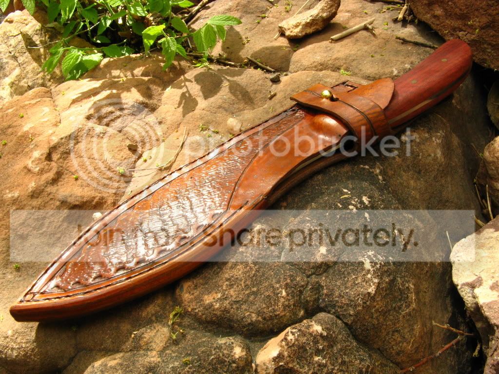

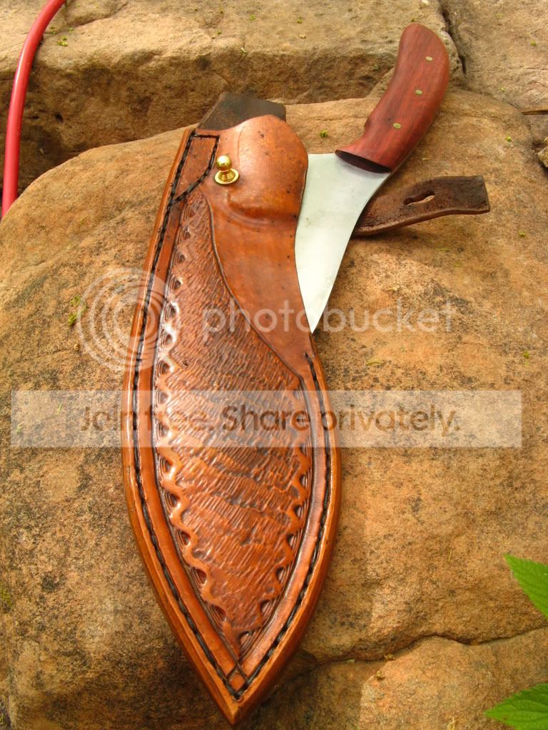

Made some pants for it.
I really wanted to take this guy camping this weekend so it needed a sheath.
I made a quickdraw for it. It rides pretty good on the hip, barely know it's there.
