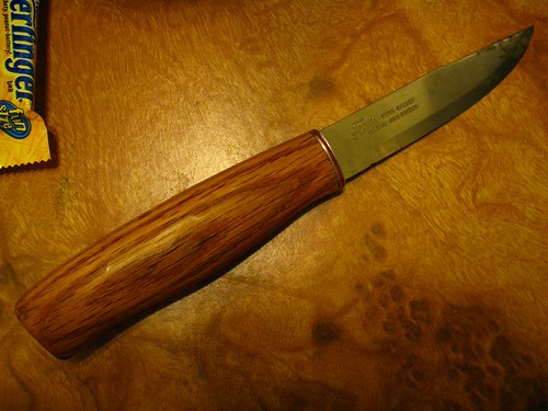

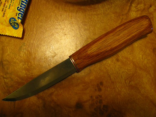

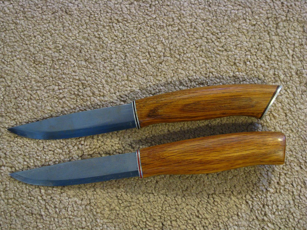

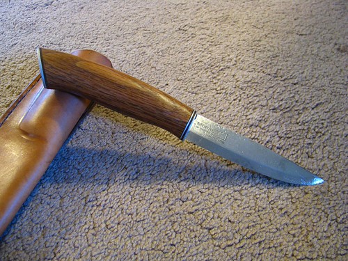

Knife ONE: Frost's Laminated blade cut down to ~4"; Aluminum and leather sandwich bolster; Oak handle; Leather spacer; Aluminum pommel.
Knife TWO: Frost's carbon blade cut down to ~4"; Aluminum and red spacer sandwich bolster; Oak handle. This is my favorite handle profile so far, and will probably become my staple handle shape.
Together:

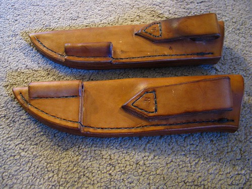

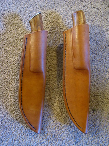

SHEATHS: Well a knife ain't very useful without a sheath. Although not shown, the firesteel loops came with firesteels in them, with spycapsule handles.

Very very fine work. Those bolsters look snazzy! The sheaths look very well made too. I need to get into leatherworking.

I like the sheaths also, intersting location for the fire steals.

Wow those look fantastic ,I especially like the one with the slanted end because it has a very Swedish style to it. The oak looks very nice as well. If you are looking for nice pieces of exotic woods check out people who make custom gun stocks and musical instruments.

Also, how does it feel to wear with the knife on the belt and the fireloop on the inside like that?
