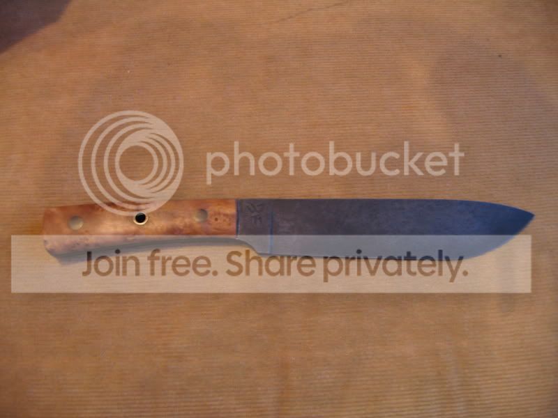

I just put the handle scales on after dinner today.... just gotta to finish the edge now... It'll have to wait for tomorrow...
This one is screaming for a leather sheath with a Kydex liner!! Have to talk to Eric at On/Scene Tactical about a colaboration.... Oh, yeah.
Rick
Wow. I really like the looks of it before the scales were put on, but I was blown away afterward. That is beautiful.

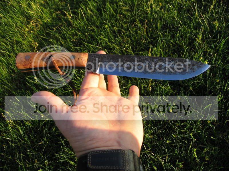

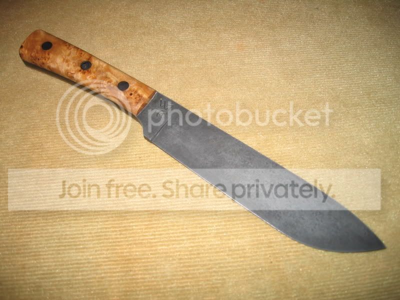

Well, here's the final product, folks.......
Bushtrekker
Material - 5160, handforged
Thickness - 1/4" at spine, full convex bevel
Blade length - 6" cutting edge, 6 7/8" incl. ricasso.
Blade width - 1 1/2" at widest, 1 1/4 at ricasso.
OA length - 11 1/8", balance point at center of ricasso.
Handle slabs - Curly Birch, 4 1/4" long, buffed with beeswax.
Finish - Rough forge finish with mustard patina.
Misc - Brass Corby bolts and lanyard tube.
Sheath - Coming soon!

Well, I'm not keepin it so I won't do a full field test on it.... but to test the edge I chopped up a dozen or so pennies into 4pcs and cut through (6) 2x4's and it still shaved. No cinder blocks or side of beef to be had, so I had to do work with what I had... lol
