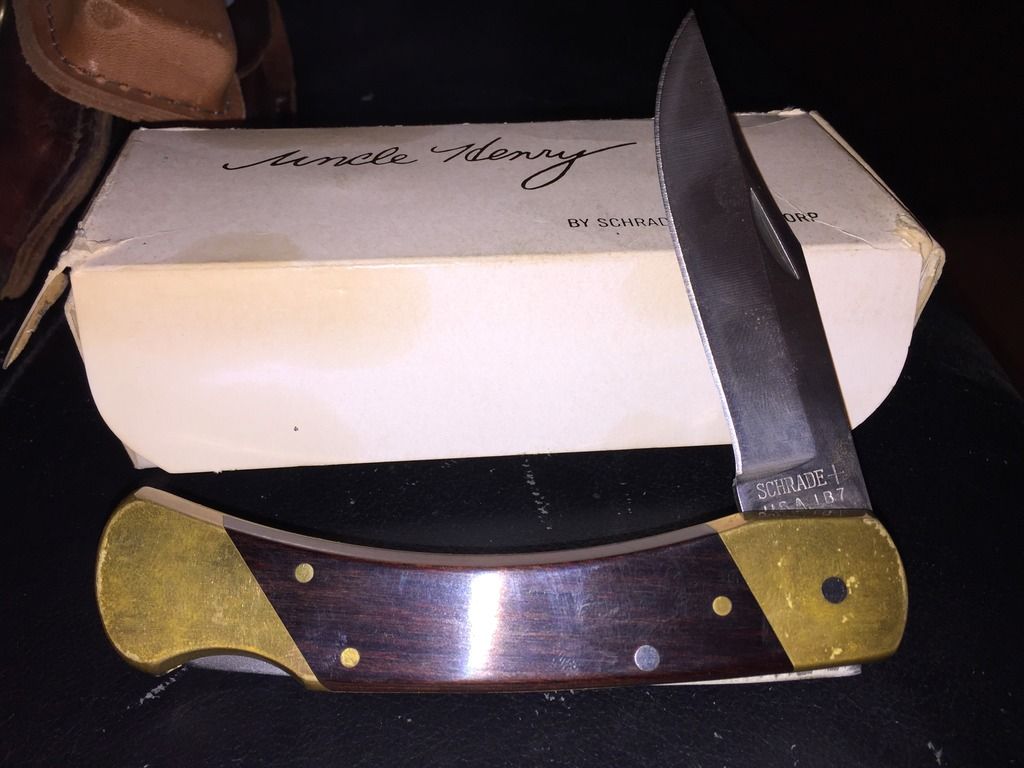

Here my first post and my lb7

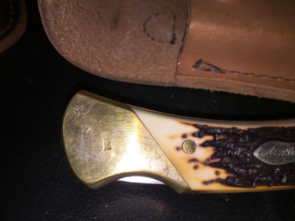

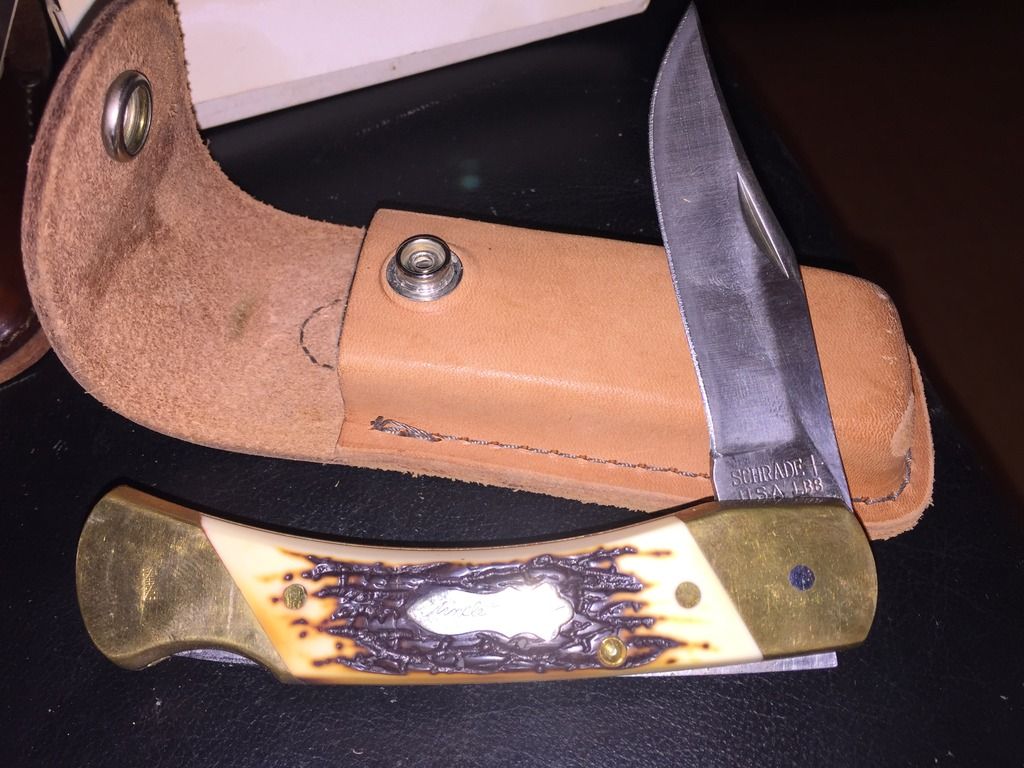

And I have an lb8 with schrade stamped on it, is this common
And I have an lb8 with schrade stamped on it, is this common?
First let me say, WELCOME ABOARD! :)
The LB8's were certainly not as common as the LB7's, and in my eyes more desirable. I have been seeing more of them show up around here lately though. :cool:
When I bought my LB7 I thought that was all I needed, so unfortunately didn't look much further back then. I wish I had. :rolleyes:
the LB 8's were serialized as well stopping on Axxxxxx. i have never seen one with "SCHRADE" stamped on the end like that. neat addition i think.
Same here. But... am I the only one to notice the SCHRADE bolster stamp has two strike-throughs?
You could well be. I saw the Schrade stamp, but didn't look close enough to see the diagonal strikes through the name. Good catch. :)

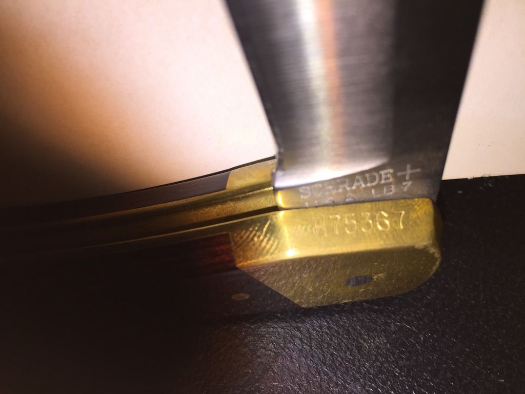

Just picked one up myself at a garage sale,
Schrade +
U.S.A. LB7
H65809
Picture to follow with any luck.
hey Codge,, riddle me this please, as I'm going insane trying to answer all my questions about UH's.. myself & my 2 older brothers all received a UH papa bear on our 10th. birthday mine I got in 78,, my 2nd oldest brother in "74" his is a 3 pin with a stainless UH shield w/lb7 & no serial #,, This is not suppose to be ,,,,right ????
