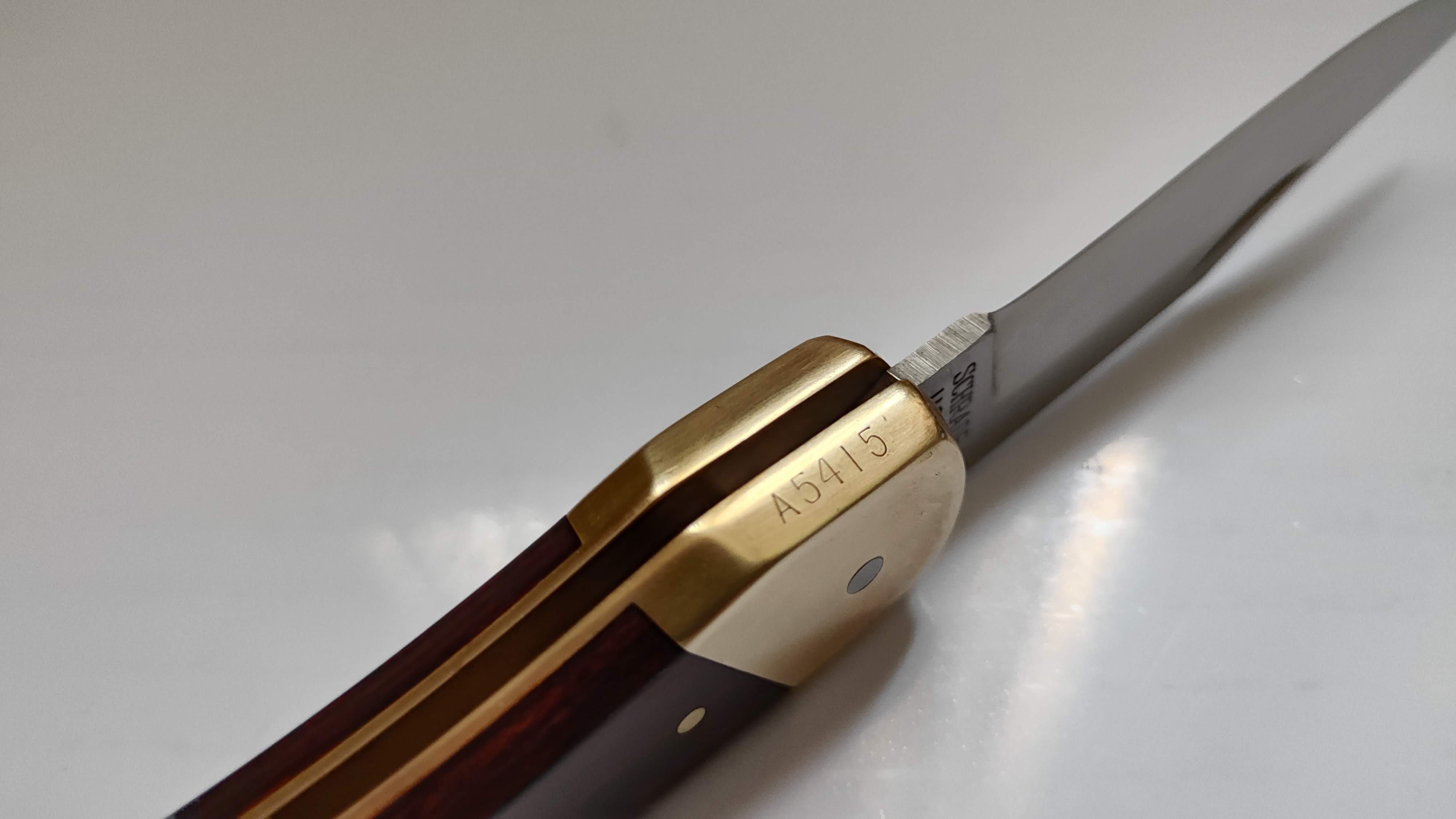

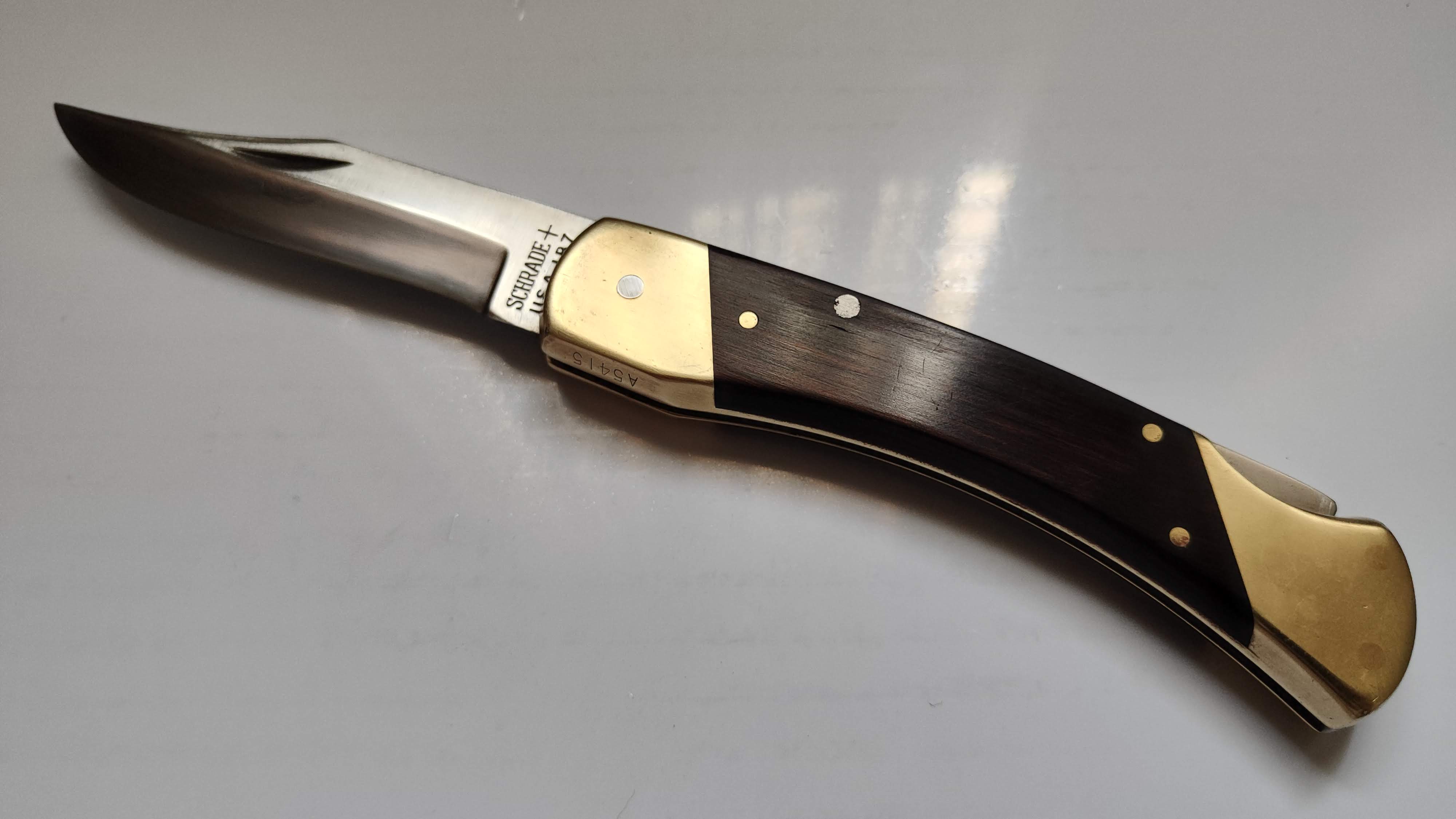

A5415 4 pin
SCHRADE +
USA LB7
Bought without sheath, any info/picture of the correct sheath look like?
